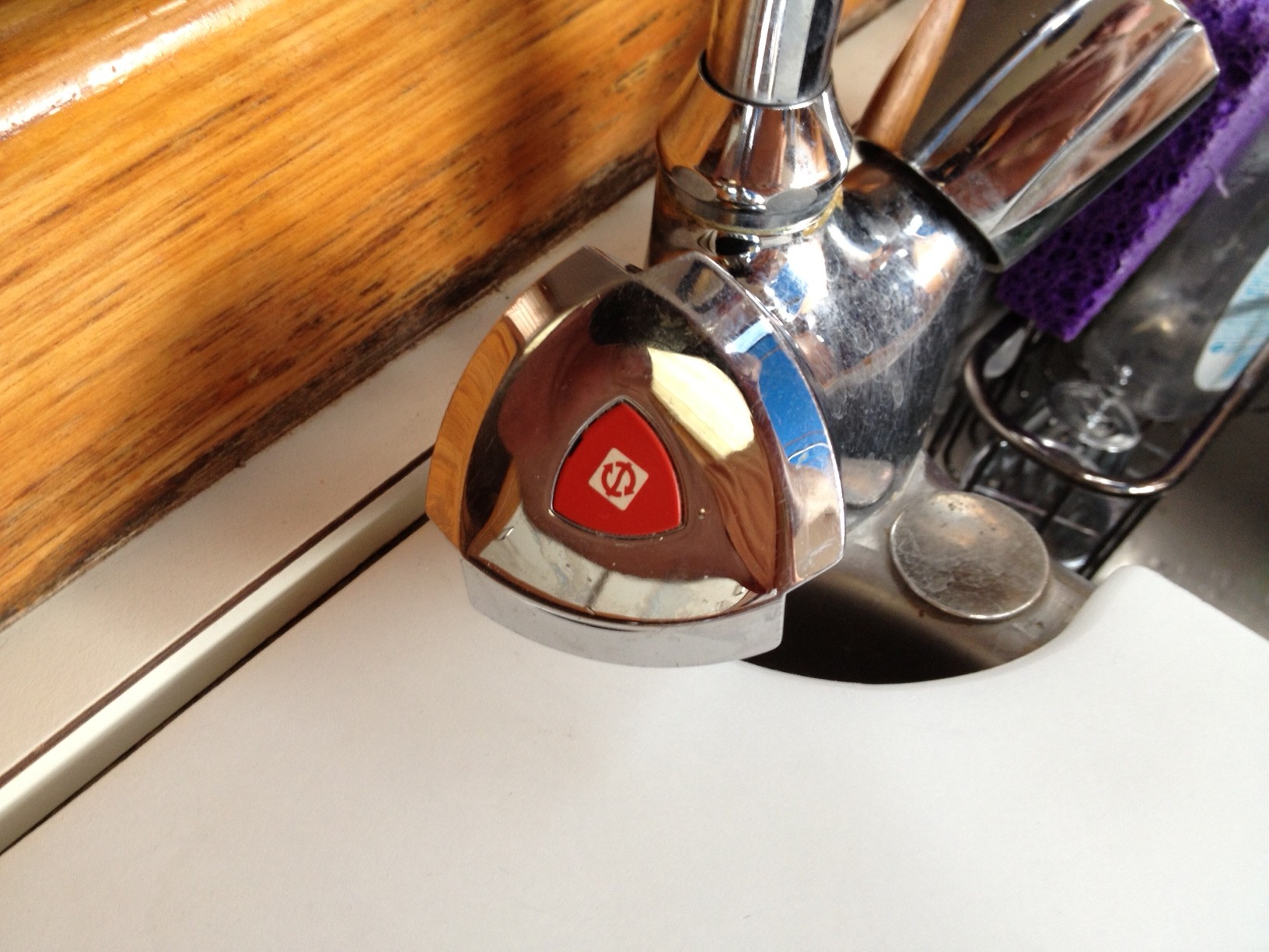

I’m wondering if anyone can identify the manufacturer of my galley faucet. The drip is getting frequent enough to finally do something about. I believe it to be original as the head faucet is from the same manufacturer. In looking for parts I’ve contacted Scandvik, Ambassador / Shureflo, and ITC marine and they all responded that it’s not theirs. Thought I’d try here before contacting Catalina.

I'd think Catalina would know; that's the same faucet that in my '97, so they obviously used it for years.
It looks very much like the Scandvik carried by Defender
http://www.defender.com/product3.jsp?path=-1|51|2234222|2234223&id=590321

Gary - I believe the faucet is by Grothe. Several years ago our galley faucet was dripping and I was able to purchase online a new "cylinder" that simply screws into the faucet base. The handle simply pulls off and the old cylinder unscrews. You do need to tell them wether it is the cold or the hot as the threads go in opposite directions. I will check my records to see if I have the info on part number and source. I recall that after a Google search for a source, I called and they were very helpful. It's an easy fix.

Gary - I found the information on source and part number. The faucet is actually a Grohe. I dealt with Watertown Supply([url]http://www.watertownsupply.com/[/url]). The hot cartridge was part number 45-883. The cold cartridge was part number 45-882. The cost was about $50. Hope this helps.

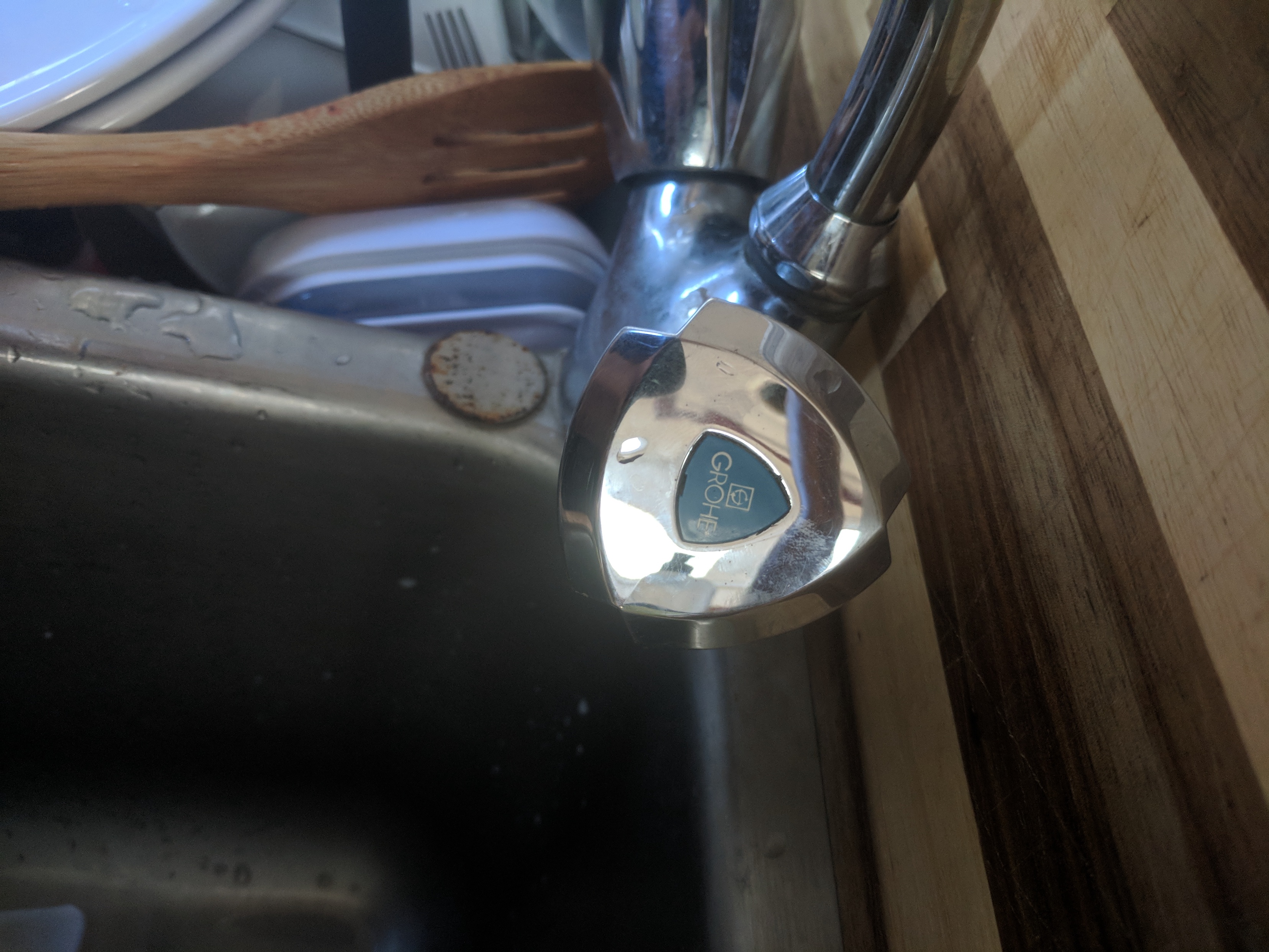

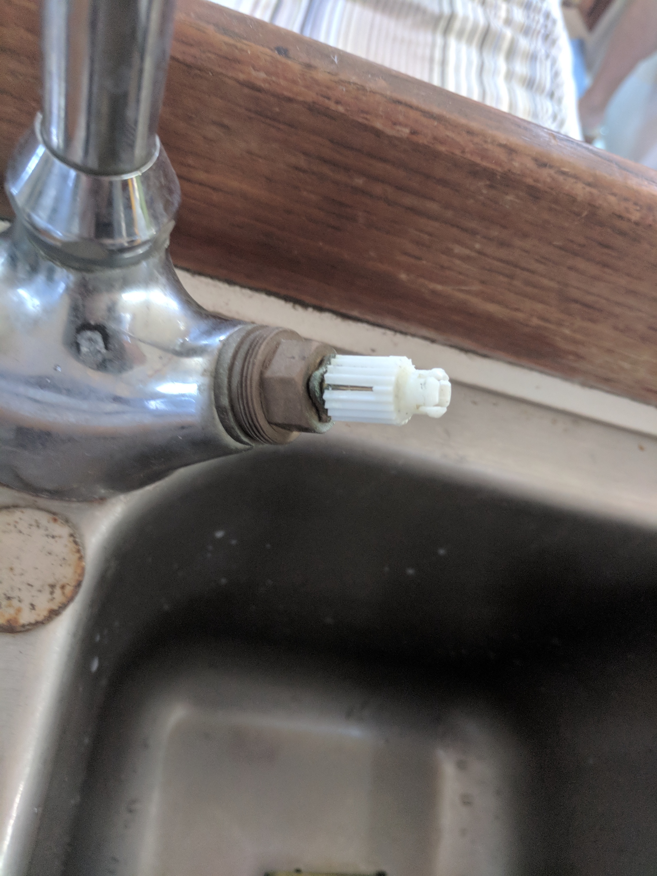

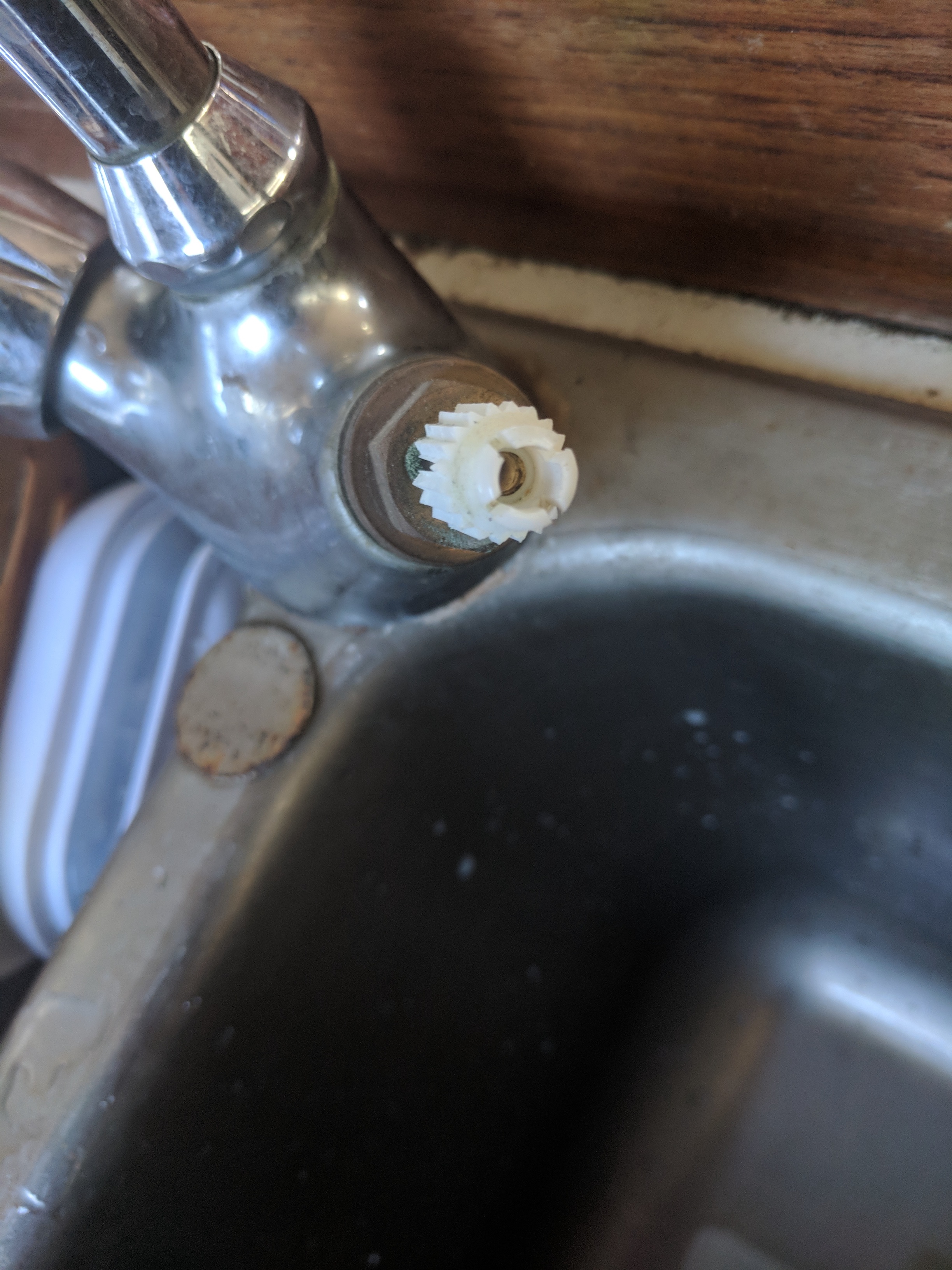

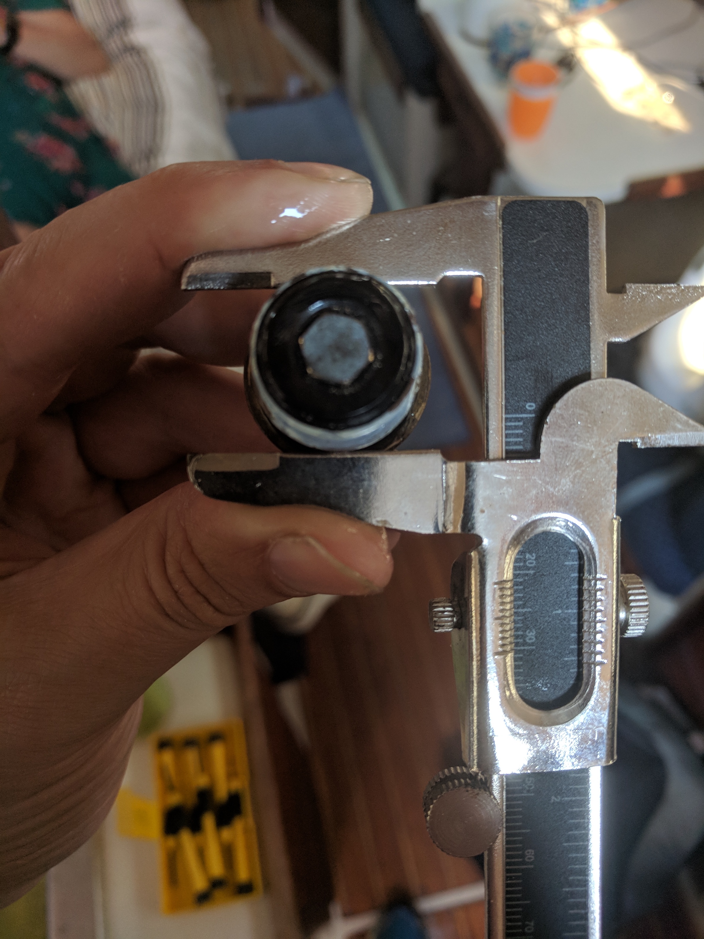

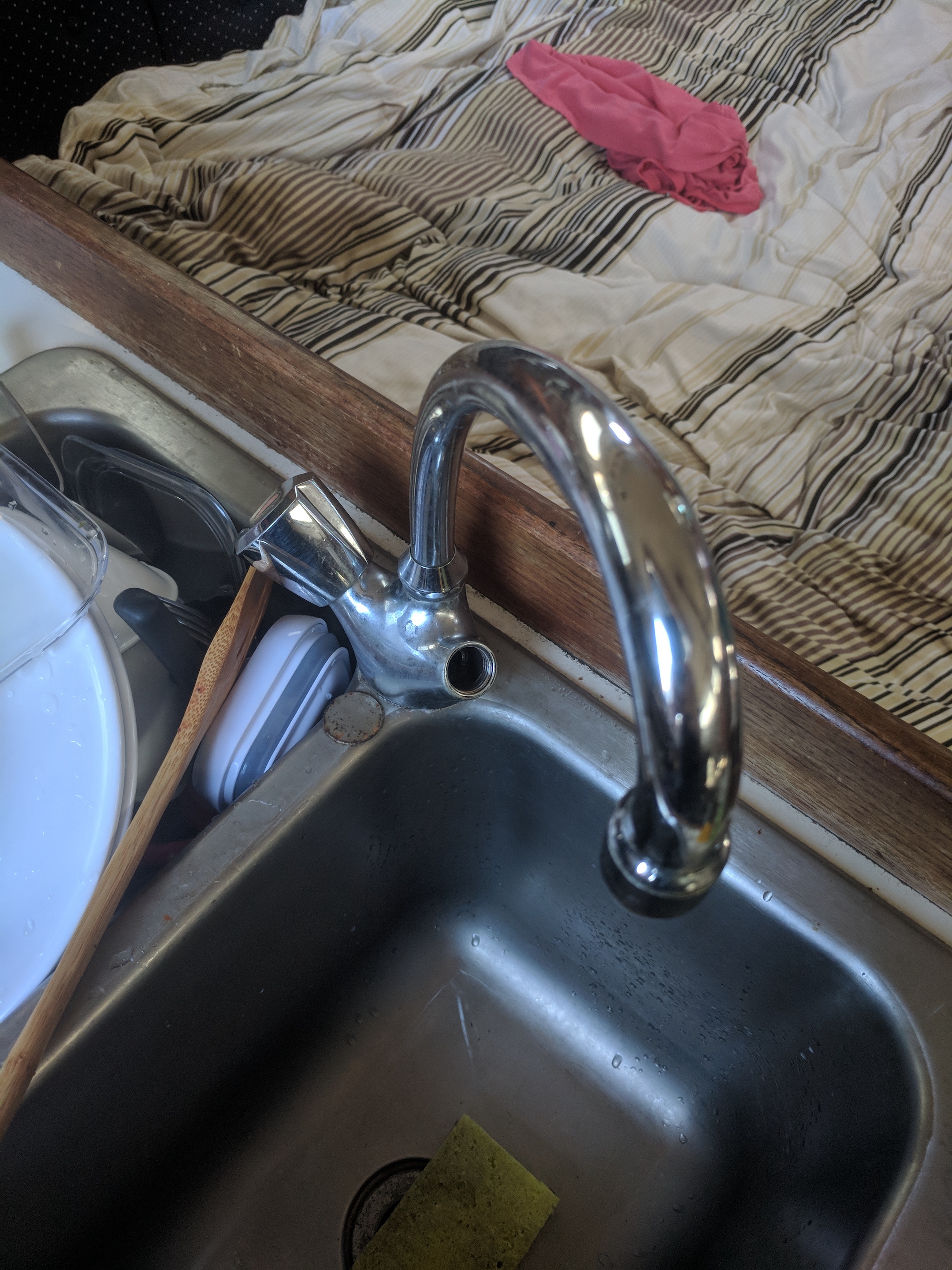

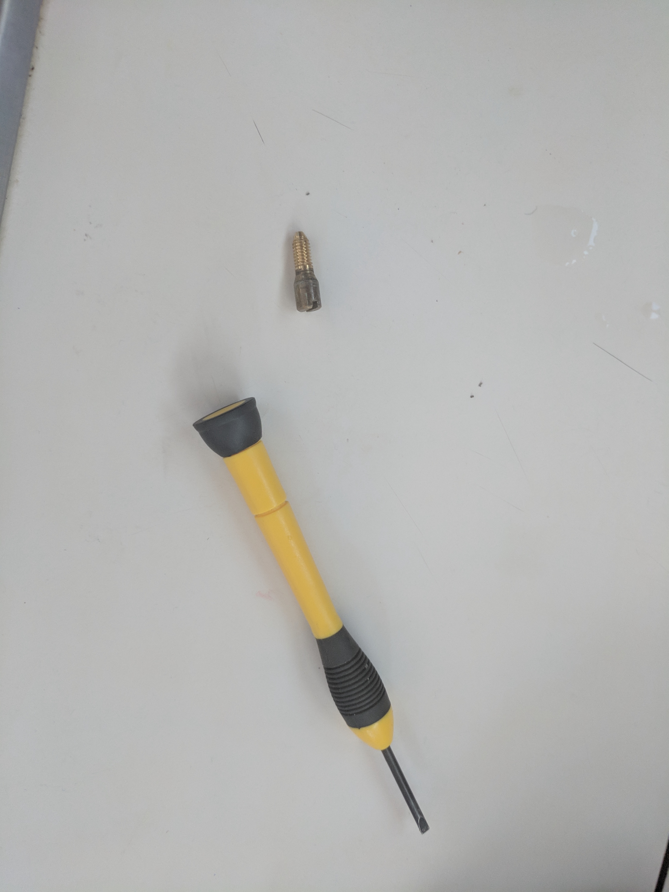

Thinking to take this project on, here some pictures and great to find the part numbers in this thread!
grohe 45-882 - $20.49 - https://www.amazon.com/gp/product/B002ZLPTSU/
grohe 45-883 - $27.49 - https://www.ebay.com/itm/New-Grohe-45883000-LEFT-Ceramic-Cartridge-Fauce...
