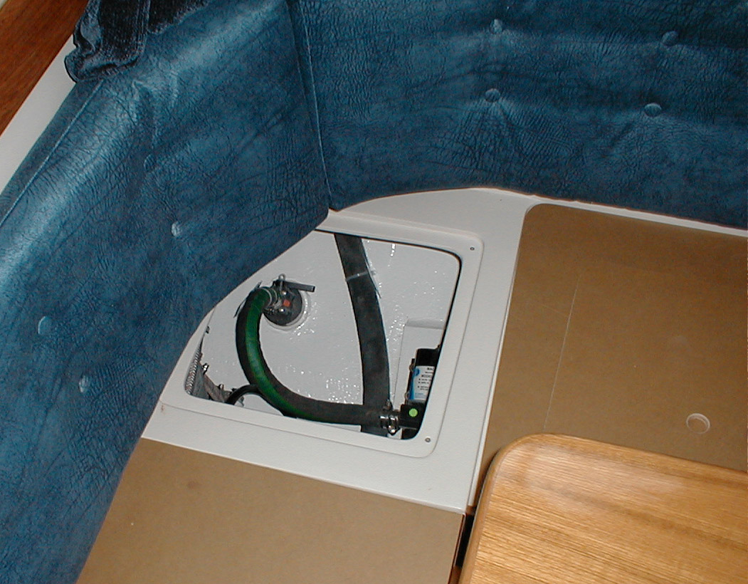

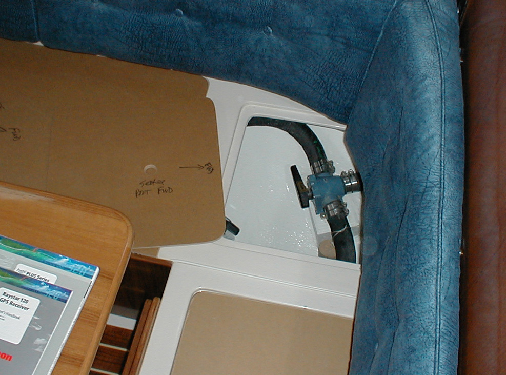

In the two photos attached, we are in the salon looking toward portside.
The first photo shows the compartment immediately AFT of the holding tank, where the output of the holding tank goes to the macerator, and thence to the macerator thru-hull. The macerator is just barely visible in the right side of the opening. The black hose without green striping on it goes to the holding tank suck-out on deck.
The second photo shows the compartment immediately FORWARD of the holding tank. The output from the head enters the center of the Y-Valve, and is selected either to the holding tank (in the position shown), or to the Y-valve's dedicated thru-hull. The Y-Valve thruhull is just out of view in that same compartment, but you can just barely see the end of the seacock handle at the left edge of the opening.
This is all factory-standard installation.

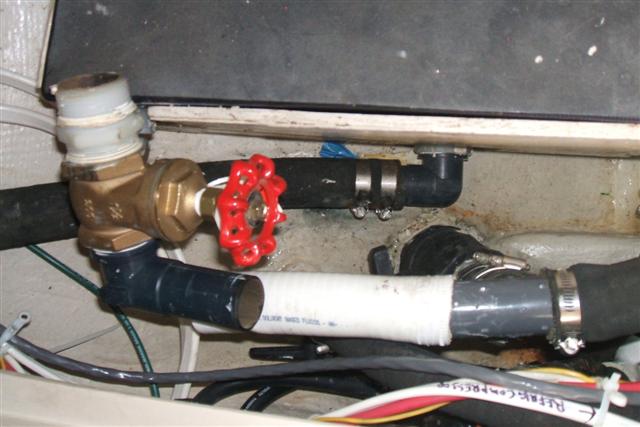

There's another way to do it, without a Y valve.
Head output to a T right above the 1 1/2" thru hull then to a valve then to tank; the T goes down to overboard discharge thru hull (1 1/2"). Close the valve to the holding tank and open the overboard thru hull for overboard discharge. Close overboard discharge valve, open valve to tank for using holding tank.
The picture shows the valve. Pretend the white hose is connected to the elbow going into the valve and that the valve is connected to the tank. I took this when I was trying to install the plastic ball valve and had just taken off this section of piping.
This is the way my boat was plumbed by the PO. He unfortunately used a metal Ace Hardware 1 1/2" gate valve as the valve to the holding tank, instead of a plastic ball valve. I tried replacing it two years ago, but couldn't get a plastic ball valve to fit in the limited space. Since the part of the gate valve that gets eaten up by the stuff in the pipes is the stem and gate inside the valve, we just open the packing nut, remove the gate and stem and handle, buy a new valve ($7) and insert the new stem, handle and gate, keeping the same valve body.

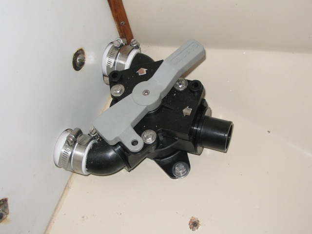

Bud, here's a pic of the Whale diverter valve (Y-valve) I installed behind the head. It fits perfectly and is easily accessible. I'm sure I did a write-up on it it once upon a time, but let me know and I have more pics and can explain the installation.
[ATTACH]349[/ATTACH]
