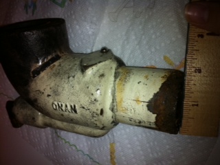

As shown in the attached pic, the Onan 170-2834 mixing elbow (which I assume was standard on the 1984 MK1) has an outside diameter of 2" (ok, maybe 1-15/16"). I'm not at my boat, but I'm pretty sure the aqualift muffler is also 2" coz the previous old exhaust hose has the same inside diameter on both ends.
Has anyone tried overhauling this Onan mixing elbow as opposed to replacing it? If so, where did you find your 2" ID silicone hump hose?

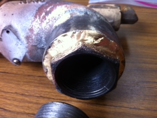

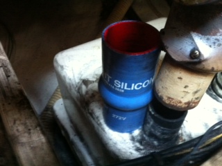

After much discussion/research, I ended up taking the mixing elbow and the small nut you see on the right side of the pipe union (in my last post) to Fat Cat Fabrication in Buford GA (google it).
For $100 (ouch) he "brazed" the threaded whachamacallit into the mixing elbow after I had accidentally FUBARed the threads in the mixing elbow trying to remove the previous corroded whachamacallit from the mixing elbow. ("I may be ignorant but I ain't stupid!" - Loretta Lynn)
See pic.

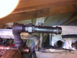

After much discussion on this forum (thanks for the Trident tip again), I was able to order the correctly sized hump hose from River Supply, Inc. in Thunderbolt GA. (800-673-9391 or [url]www.riversupply.com[/url]). (Trident makes you order through one of their dealers who usually have to back-order it from Trident, so it took a couple of weeks to get this to me.) Part# is: 272V2000-SS. Description is: "TRIDENT HOSE BLUE SIL 2in"
Cost: $58 with shipping (ouch)...but after reading all the horror stories about broken aqualift muffler hose fittings due to vibration transferred from the engine through the exhaust riser to the muffler...including a brand new one (see "What's in YOUR muffler???" post by Stu Jackson)... this appears to be money well-spent.
Although the diameter was correct (see earlier posts in this thread), the hose was too long, so I simply measured and cut to approx size with a small hack saw. No biggie. Just make sure you don't cut it too short and have to order another one at $58 (ouch).
See pic.

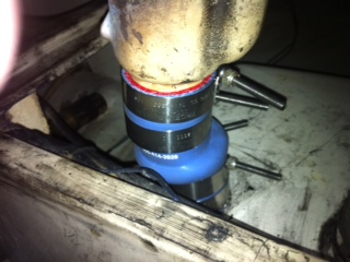

Oh, also, here's another pic of the silicone exhaust hump in place. Note the double clamps that came with the hump in the shipment. (Kind of nice of them to include those.) Note how it's not perfectly aligned, but (a) I suppose that's partly what the "hump" is for and (b) don't know what I could do to more closely align it in any case.
Ben Ethridge

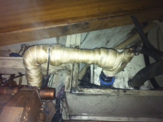

The owner of Fat Cat Fabrications suggested that I wrap the exhaust riser with what's called high-temp fiberglass "header tape". Apparently this is what one does on exhaust system "headers" on cars and motorcycles.
I got this at Advance Auto Parts (national chain, I believe.) With the locking ties, this set me back $63 (ouch).
The 50' x 2" roll was plenty to do the job.
Get the larger size stainless steel locking ties. I got the smaller 8" ones but had to double them up to go around the riser pipes. No biggie.
One tip from Fat Cat, who apparently does this kind of thing a lot: Soak the tape in water for a minute. This will shrink it down for a nice tight fit, once the water dries out. When you run the engine with the wet tape, obviously it's going to steam...but that's part of the shrinking process, I suppose.

Here is a pic of the completed job.

[QUOTE=benethridge;11214]The owner of Fat Cat Fabrications suggested that I wrap the exhaust riser with what's called high-temp fiberglass "header tape". Apparently this is what one does on exhaust system "headers" on cars and motorcycles.
Here are pics of the header tape and locking ties.[/QUOTE]
Heads up that this "hi-temp" fiberglass tape alone is apparently NOT adequate to handle the extreme temp coming out of the exhaust manifold. At full power, it smells like it's burning. Unless someone has a better idea, I'm going to take it off, add a layer of steel wire mesh followed by heavy-duty aluminum foil, followed by the fiberglass tape.
I'm guessing that the temp must be over 1500 degrees coming out of the exhaust.

Ben, our current boat just has the "fiberglass" tape on it and that's all, we get no excessive heat from it. I quoted the word fibreglass because I'm not sure it is fibreglass, one diesel mechanic told me it contained asbestos, I doubt that and I hope like hell he is wrong but I don't know for sure what it is.
Our Catalina 28 had the layers like this from inside out: wire mesh, "fibreglass" tape, heavy duty aluminum foil. Wire mesh is better able to stand the heat directly on the pipe and it leaves a tiny air gap between the tape wrap and the pipe.
I gather 1500 degrees is too hot in a diesel, the max should be less than 1200 according to what I read about this.
