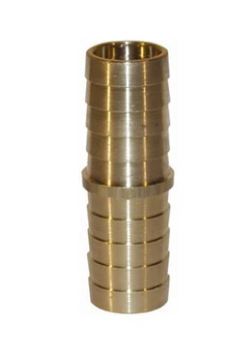

I had to do this a couple of years ago when my water heater was having issues and I wanted to take it home to operate on it.  I just connected the two hoses that connect at the front of the water heater with a hose coupler like the one below.  I finished the season fine like this with no issues.  The coupler was a couple of buck at Home Depot.
Don Lincoln

The union posted above is the easiest method.
