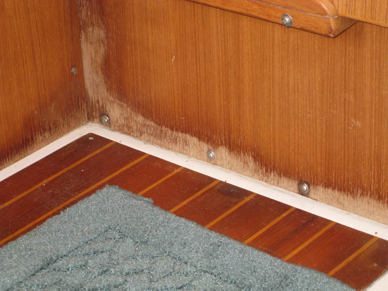

Hi, all!
We are in the market for a C36 and have found a '96 MkII for sale by owner in the Seattle area that is really set up for cruising. The only problem is that she spent 5-6 years down in Mexico, so she's really showing signs of being closed up in the tropics (about 70% of the interior finish need to be redone, the "bronze" light fixtures are all pretty corroded, etc)...
Of more concern to me is that the main forward bulkhead has water damage along the base. And, according to the owner (and past owner) this was the result of a leaking supply line to the toilet and failed sump in the shower that allowed the pan in the head to overflow and just "sit" against the back of the bulkhead for... (god knows how long...)
What are your thoughts on this? I realize it is tough to tell just by looking at the pics. What would the repair process look like? Or, do you just lightly sand and refinish and act like nothing happened?

I wouldn’t rule it out based on what I see here but there are other factors to consider. The main one is price. I wouldn’t pay “top dollar” for a boat in any condition in this market.
I’m no surveyor but as far as bulkhead damage goes, I’d probe the area with an ice pick or something similar. I wouldn’t want to see any appreciable penetration with, say, a flat bladed screwdriver. More penetration = more concern. I’d also pull out a few of those screws and look for obvious signs of rot. If you can take a dental pick and easily remove rotted wood out of the hole, I be suspicious. I recall others have posted photo & comments on bulkhead replacement. I believe the did the work themselves. Do a search for it.

I agree that some investigation is necessary to determine if the moisture damage is merely cosmetic or if surgery is required.
The C36IA has an article in the Technical - Maintenance library written by an owner who did a replacement of that bulkhead. The article is well written and photo documented, so it would be a good guide should you need to replace the bulkhead. The Technical Upgrade and Maintenance libraries are not open to the public; they require paid Membership (capital M) in the C36IA to access.

Solla - I probed around a little bit with a screwdriver, and it didn't have the "hollow" feel that seems to happen with laminated plywoods, etc...

Thanks for the insight on the bulkhead, folks. I went ahead and discussed it with the current owner (who just wants "out" of the boat) and was able to come to a reasonable agreement on price. So - she should be ours very soon!

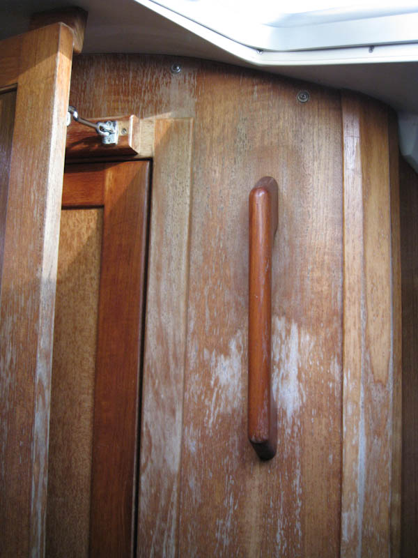

Great minds think alike. I was originally thinking it was a leaky chainplate as well and we went over that area pretty heavily, etc... In short, there's no evidence at the settee, like you'd expect, and we tested for moisture in the deck without any luck, etc...
So, we took a closer look and looked at the bottom of the head's door and it was also water damaged, and you can see where the water overflowed from the head pan, over the threshold and under the corner of the sole (also damaged) into the bilge... Though, there's no other "flood" evidence except for the head area (no other floor boards, cabinets, etc...)
So, I think we are safe in terms of chainplates/deck. ;^>

There have been a number of posts about replacing the cabin sole so without going into details here, if the PO had water leakage, pull up the sole and see if the bottoms are damaged. They aren't cheap to replace. As we all know, our friends at Catalina didn't seem to think it was necessary to seal the undersides of the sole boards.

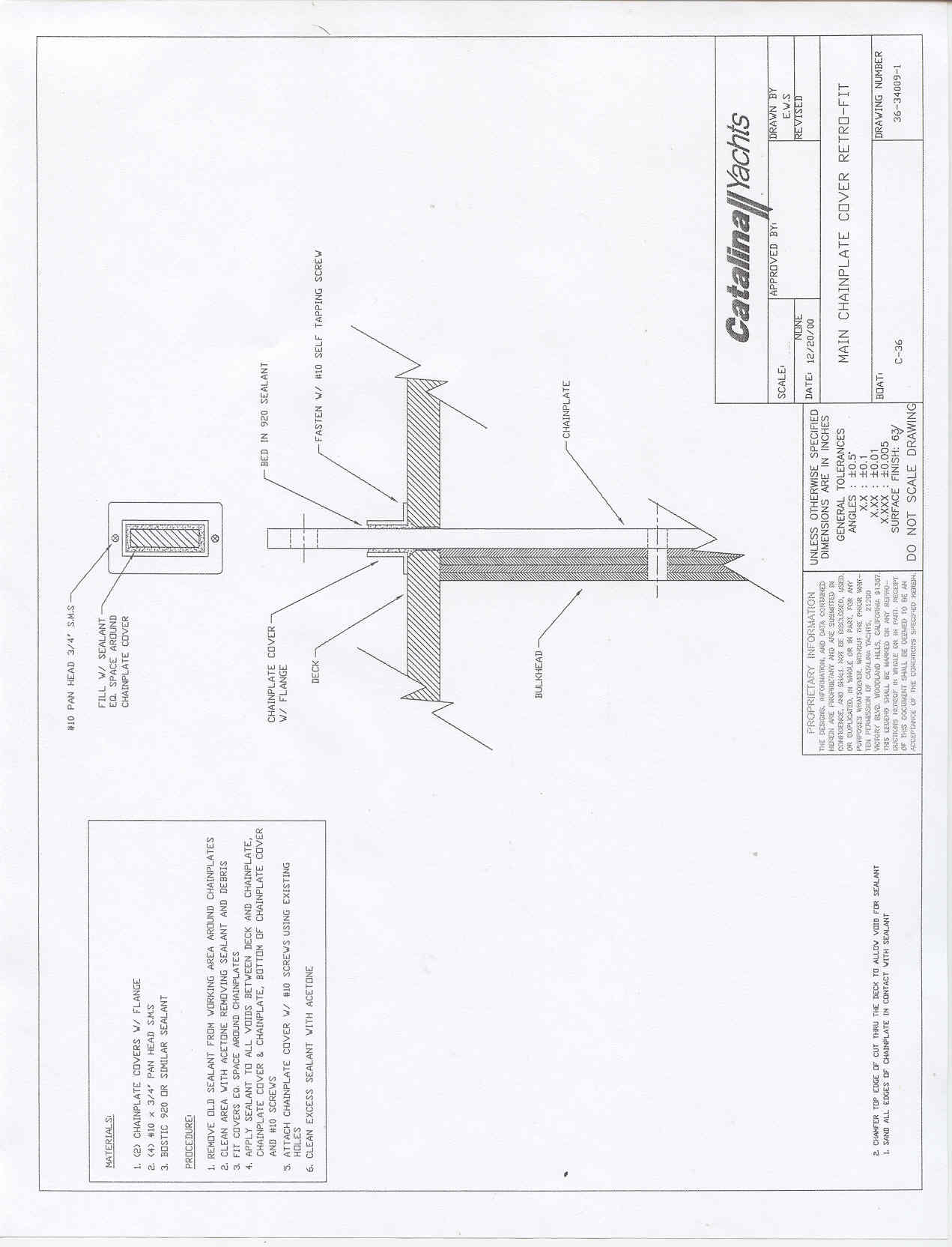

I agree with Pat and Steve. The likely source of the bulkhead damage is a chain plate leak. C36’s are very prone to this problem. Around 2002 Catalina modified the through deck chain plate, which I assume was to address this issue.
Look at the underside of the chain plates in side the cabin. There will be evidence of previous leakage between the shroud plate and the hull liner, a line of rust between the plate and fiberglass. Has any of the varnish lifted high up on the bulkhead ? This is another sign of moisture coming through the chain plates.
Get a moisture meter and check the moisture content around the chain plates. You can get a good meter for around $150 (Electrophysics, Model CT33). A lot cheaper than paying the surveryor $800 to tell you the same thing.
How to use [url]http://www.pbase.com/mainecruising/moisture_meter[/url]

VermontSailor - We did end up testing the entire bulkhead with a Lignomat meter and didn't really find anything of interest/concern. (And this was after a 3-day rain in Seattle...) That said, yep - one of the first projects we'll be doing is rebedding all of the chainplates. (I had an 88 mki years ago that leaked horribly when I bought her...)
Though, there was definitely some moisture in forward bulkhead between the head and the vberth on the starboard side. I'll be tracing that soon enough... Thanks again....

Lignomat meter is a meter that checks the electrical resistance of wood to determine moisture content with two probes that contact the wood. The Electrophysics makes a non-contact measurement using capacitance. It can detect moisture in deck coring behind a layer of fiberglass, without drilling holes. Checking the entire bulkhead won’t tell you much about leaking chain plates. Water from the chain plates will work its way to the bottom edge of the bulkhead and floor via the hull liner and edge of the bulkhead.
The bigger issue for you is to make sure the deck core is not wet. Once it is wet it can not be dried out and will eventually rot. Especially if the boat has been in a warm climate for a length of time. Even if the chain plate leaks had been fixed, it could be too late for the core. Very expensive fix, compared to replacing the bulkhead.

Though, I checked with the surveyor (who, of course, did use a capacitance meter) and he was pretty satisfied. The only moisture he was concerned with was a 16% in the port bulkhead (though, inboard of the chainplate). And, there's a little spot above the head, outboard to port of the hatch there that registered at 18% (though, no de-lam of any sort), but I'm pretty comfortable with dealing with that appropriately...
All in all, I'm actually pretty happy with how she surveyed out, but we did haggle and haggle on price until we got to a point that would make it pretty easy to cover the cost of any "worst case" scenario. (Seriously, I almost feel bad admitting how much we haggled, etc...)

Congratulations.
You may want to consider adding upgraded chainplate cover that Catalina had created to get a getter seal. Part number 24263. See attachment. They were $8.00 each a couple years ago. Contact Kent Nelson at Catalina, [email]kent@catalinayachts.com[/email]

Nile - Sweet! Thanks for the tip... I was thinking of having something similar fabricated, but this will obviously be a heck of a lot easier!

[quote=VermontSailor;10676]Congratulations.
You may want to consider adding upgraded chainplate cover that Catalina had created to get a getter seal. Part number 24263. See attachment. They were $8.00 each a couple years ago. Contact Kent Nelson at Catalina, [EMAIL="kent@catalinayachts.com"]kent@catalinayachts.com[/EMAIL][/quote]
I emailed Kent this morning, the price has gone up to $9 bucks! The horror! ;)
I ordered 6 of them, looks like a big time improvement over what we've got now.

Yeah, I got a hold of Kent as well. He had me email my order to [email]dani@catalinayachts.com[/email]...
Glad to see these *before* I re-bedded everything, etc... Thanks, Nile!
