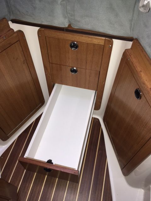

Another c36 and Fleet 9 owner (Mike Ashmore) and I discovered, coincidentally,  that the roller brackets/runners on the bottom drawer under the v-berth were heavily corroded and non-operational.  I suspect other MK II owners have discovered the same thing (the MK 1 drawers are not mounted with brackets).  Catalina Direct did not have any replacement parts, but we were able to ID the part, and locate the source online.

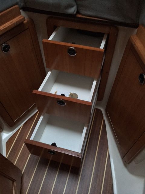

I doubled the length of the 3 drawers under the V-Berth a few years ago and needed longer slides.
