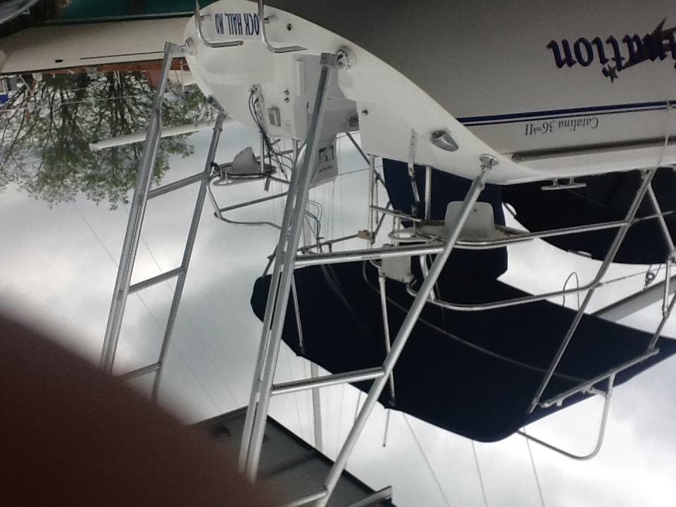

Interesting recent disussion about using stern plate to mount outboard, and I'll throw in another confirguration. Would appreciate any and all feedback on feasibility of this approach.
Boat (2002 C36 MKII) has an Atlantic Tower arch with 2 solar panels on top. (see photo).
I'd like to attach the Garhouser lifting block and tackle system to the arch.
Looking at a dinghy weighing 115 lbs and 5 HP Honda weighing 60 pounds (total weight 175-200 lbs)
Thinking I might be able to use the Port side Garhouser tackle to lift outboard to stern plate when required.
Questions:
Can an arch subsitute for a davits without damaging the boat or creating a unwanted condition (sailing performance, safety?)
Can I do a local sail in fair weather with dinghy and outboard on dinghy transom hanging off the arch?
Can I leave the dinghy with outboard on the dinghy transom hanging off the arch while in the slip?
Will the Garhouser block and tackle be an adequate outboard lift?
Are the Torqeedo outboards reliable? I've read about computer faults which make the standard OB a reliable choice.

Wow, that is one robust arch. Have any idea what that weighs? Is it made from 1 1/2" stainless tube? A finger on the lens is blocking what the construction at the top looks like.
Have you ever grabbed it and hung from it to see how it supports your weight? Maybe do some swinging to see how it flexes.
 It looks like it would place the dinghy center of gracity much higher than if it were supported  by davits- meaning the rocking motion from waves would impart a lot more side to side force.
With a small outboard, our dinghy weighs in about 160 lbs. The davits are 1 1/4" tubes (I think). The dinghy is a little higher than the stern rail. I wouldnt want to add much more weight to our configuration, and it's a relatively low height compared to your arch.

Yes, that would be my finger... I uploaded another attachment of the full view. Not sure of the weight but is it 1 1/2 inch Aluminum made by Atlantic Towers. It was purchased by the PO. Not done any swinging off it yet!

Can't offer a comment on the main topic (i.e., whether the arch would be strong enough for what you are thinking), although I agree with Peter that it sure looks robust (assume it has backing plates for the attachment points).

Matthew, thank you very much for your comments about the Torqeedo. I really do like the "ease of use" features, as long as the reliability is there... Arch does have back plates installed and has seemed very secure for last 3 seasons. When it comes to weight hanging off the stern, "less is probalbly better", therefore my interest in Torqeedo and ultra light dink.

OK. I see from the other picture somebody is using the arch for davits- and they are keeping the dink low- at stern rail level. That's a smart way to do it- keeps the windage low (the dinghy is level and not at an angle to the wind acting like a sail), and reduces the stress created from the side to side motion- assuming the dinghy is nicely tied off onto the stern rails. I would see if the arch manufacturer has a weight limit on the structure. If they do promote it for davit use, they would likely sell the associated accessories- cam cleates with fairleads, cleats and purchase blocks. If your dink/motor is in the 160 lb range, you would need a 6:1 purchase to easily lift it (ie each pair of blocks have three pullies).
