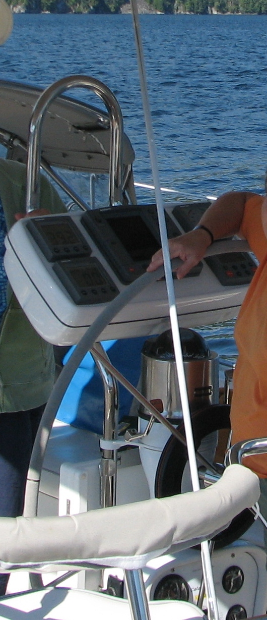

I replaced the pedestal guard with a 1-1/4 diameter tube. I used one instrument pod to accommodate the plotter and four instruments, instead of the two separate pods that obstructed the forward view.
I have to admit I prefer the increased field of view from behind the wheel. I will dig out my notes and provide part numbers with further details.

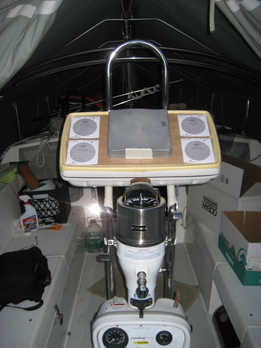

I used a single NavPod to hold the plotter and four ST60 series instruments.
Photo shows the initial setup and templates for positioning the cutouts in the NavPod. Notice the temporary ½ inch wood spacer to keep the NavPod off the compass. The plotter is an RL70/RC530 series, but there is room for a larger one in the future.
NavPod GP1170 Uncut Pedestal Guard Pod for 9.5” wide pedestal guards
There is a precut version for a Raymarine C80 plotter and 4 ST60 instruments.
[URL="http://www.starmarinedepot.com/NavPod+TP125+Top+Plate.html"]NavPod GP1170 Uncut Pedestal Guard[/URL]
NavPod AG126 Pedestal Guard 9.5” x 58” x 1.25.
I did not shorten the Pedestal guard. I mounted the Pod ½ inch from the compass. I did not drill holes into the stainless steel guard. SS is a bitch to drill (it work hardens from the heat of a dulling drill) especially large diameter holes. I cut a rectangular slot with cutting wheels using my Dremel tool and then ground the edges smooth.
[URL="http://www.jamestowndistributors.com/userportal/show_product.do?pid=61656"]NavPod AG126 Pedestal Guard[/URL]
[URL="http://www.starmarinedepot.com/NavPod+TP125+Top+Plate.html"]TP125 Top Plate adapter[/URL]
I brought the old plate to a machine shop and had them bore out the holes to accommodate the 1.25 diameter tubing.

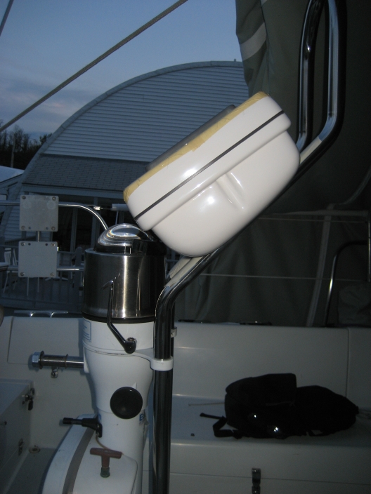

I upgraded my pedistal guard a couple of years ago adding a large navpod which perfectly fit a Garmin 4212, Garmin GMI10 and a Raymarine autopilot display.
In no particular order here ar some thoughts.
I used the existing guard, having it bent to 25 degreees leaving about six inches of guart sticking out above the pod. I didn't rebend above the pod as in many newer pod/guard configurations.
Obviously I had to remove the guard to have it bent and I had a pro do the bending in a shop. Not many bucks.
Even if I wasn't bending I would recomend taking the guard out to do the work. With the numerous wires you will be running you are going to need to enlarge the hole/holes where the guard sits on the deck. I enlarged both sides to the inside diameter of the tubing. I ground back the core between the inside and outside surfaces of the deck and sealed the core.
Drilling that tubing is pretty difficult and in the end I found that the best thing to use was a little cut off wheel in the Dremmel. I used up 3 or four blades but the cutting went fast. The holes needed to be large enough for a number of wires including ones that had molded on connectors. To accomodate these wires I cut slots that were about 3/4 inch by about 2 inches long. Everything went through nicely with no sharp bends at the exit into the pod. Be sure to grind down the edges so the wiring is not damaged.
Play with the wires which you are goiing to feed through to figure which goes where and which goes in first and last. In general anything with a conector needs to go through first with bare wires following up. Lube the wires with "wire pull" lube or soapy water or whatever you think will work. Be patient. This is the place that you will be very happy that the guard is not installed on the deck as while it sits on a bench or even the dock box you can easily reach both ends of a wire to facilitate feeding.
If I remember correctly there are a total of 11 wires running through my guard, maybe more. Some of those has connectors which barely fit through the tube but once those were through everything else followed easily.
When I re-installed the guard I sealed it to the deck fitting and the deck fitting to the deck.
There are some lengthey discussions on the site re any effects your new equipment may or may not have on the pedestal compass. Lots of different opinions. In my installation the compass seems to unafected by the close proximety to all that electronic gear and the dreaded magnetic door on the 4212. I have to say that having all that info right there in my face is best for me. If I were ever going to be in a situation where I thought I may need to rely heavily on a mag compass and I thought that my binacle mounted one was compromised by the plotter then I would mount one somewhere else in the cockpit after checking for the best location.
I have no luck getting a pic onto this website so send me a note a [email]flynr@aol.com[/email] and I will be happy to send a pic of the end result.
