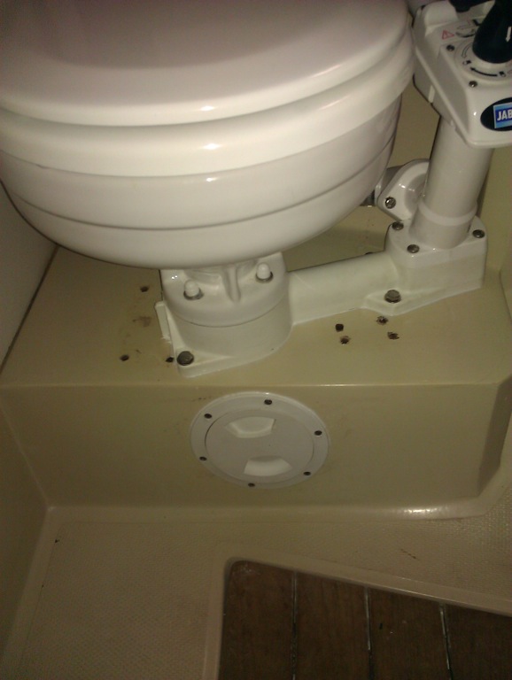

On the off chance that someone some day should read this thread to the bitter end, I can report that on my 1984 Mk I the toilet pedestal has 1/8" glass-only front face and 1/8" glass plus thin plywood (3/8"?) on the top.
Here's a picture of the finished installation of through-bolts and access port. You can see the holes left from the PO's many redos on the lag screws as they continued to pull out. Next I'll have to get the epoxy and gelcoat out :rolleyes:.

[quote=Channel Islander;10890]On the off chance that someone some day should read this thread to the bitter end, I can report that on my 1984 Mk I the toilet pedestal has 1/8" glass-only front face and 1/8" glass plus thin plywood (3/8"?) on the top.
Here's a picture of the finished installation of through-bolts and access port. You can see the holes left from the PO's many redos on the lag screws as they continued to pull out. Next I'll have to get the epoxy and gelcoat out :rolleyes:.[/quote]
Nice job. One thing though, you can't put gelcoat over epoxy. It will just go rubbery. You'll have to plug those holes with fibreglass resin.
