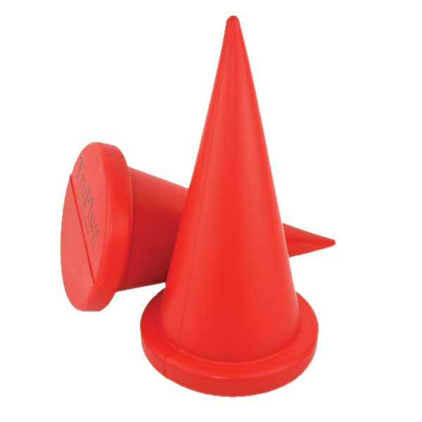

I have heard some cruisers travel with plugs, in case they fail.
Do you recommend this?

We have a selection of plugs in the cupboard just ahead of the nav station, along with other emergency gear (flares, flashlights, etc.). They are wooden ones we've had forever, but I like the newer plastic ones and plan to get a couple.

davecask's picture
davecask
Joined: 11/2/08
Posts: 35
They're made by Forespar, although there may be others similar. This is what I mean, from Westmarine or almost any chandler

I was told by an old salt who had sailed for more than three decades all over the world to keep a (what he called a bung) by each seacock and thru hull. So, I purchased the wooden ones and placed an screw eyelet toward the top of the large end. Then, I attached a short piece of line to it and then secured the other end of the line around the thru hull somewhere. That way, one of them is always within a few inches. FWIW

The big risk with the Forespar OEM marelon seacocks is snapping the handle off and having the guts come out. You don't have a nice clean hole to shove a wood plug down into, it will be on the side and can be hard to get at. Driving a plug in will likely just shatter whatever is left. Probably the orange foamy plug shown earlier in this thread would be a better fit. I really dislike these seacocks, as has been discussed many times on forums everywhere, even just having the screw holding the handle come loose will start a leak. So I think exercising them can minimize the chances of gunk build up causing friction and a broken handle causing an OMG moment. Changing them to non-OEM units is not as simple as it looks, on our boat the bases and thru hull inserts are well glued in and it will be a destructive job to say the least. I changed the 1.5" macerator one and it was extensive work even in an easy to get at spot. The others are far worse.
