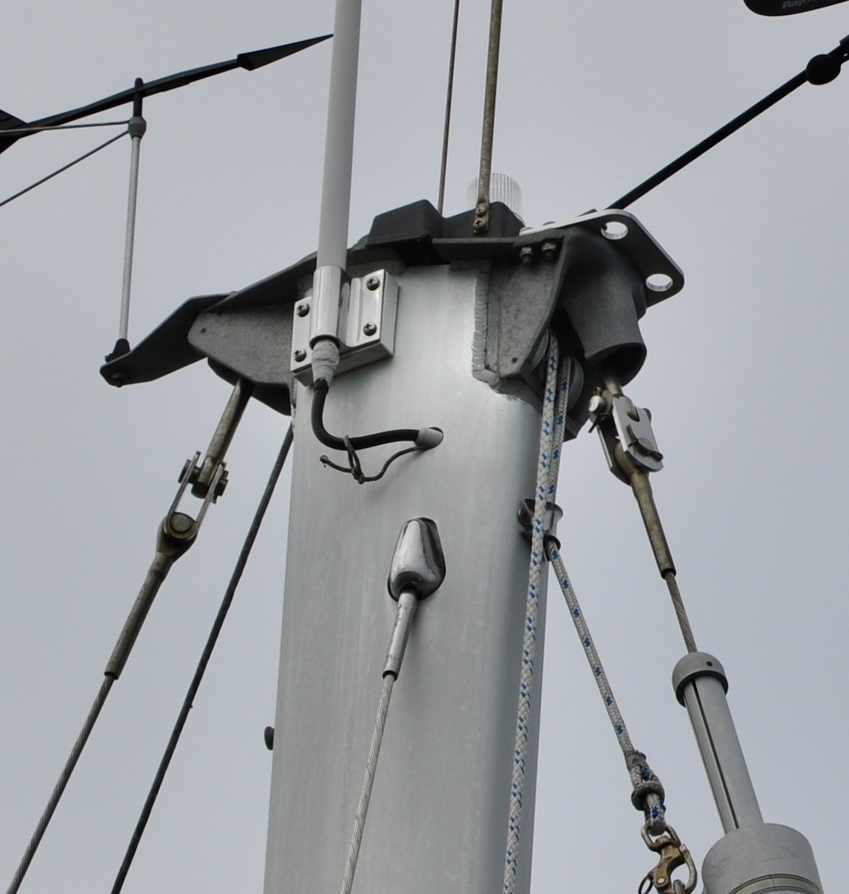

The upper shrouds attach to the mast via the tear drop fitting on the attached image.  I assume at the end of the shroud swaging is some type of ball joint? I don't see any nuts or bolts physically securing the "ball joint housing" to the mast. Does  the mast head casting have to be removed to provide access to this "ball joint housing"?
I'm sure I'll find the answer when the mast is pulled in the fall, but wanted to give some thought to it ahead of time. Appreciate any info on this end of the rigging.

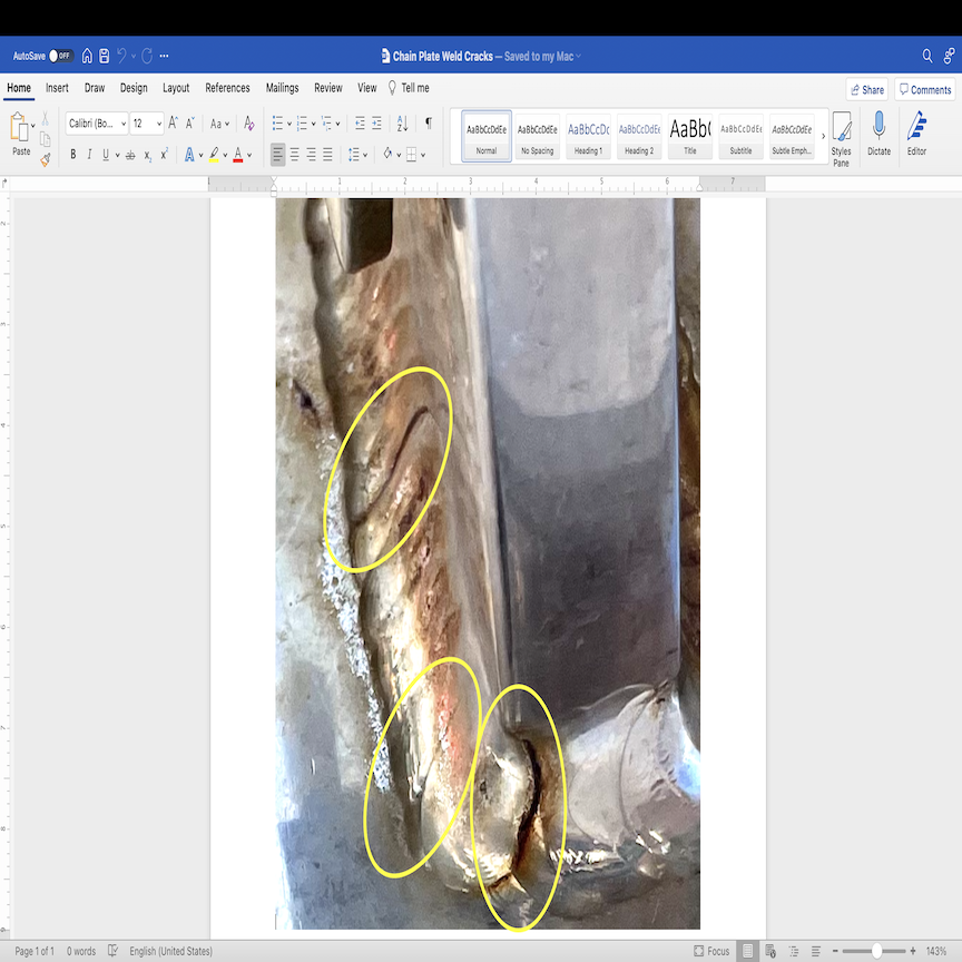

I think Hayn (the manufacturer) supplies Catalina Direct with the HiMod Compression fittings.  I've gone ahead and ordered replacement rigging from CD. They have been helpful. CD suggested a close examination of the chain plates, which I recently did. I found several chain plates with small cracks that seem to be constrained to the weld beads. The toggles and other areas of the chain plates appear very sound, but if the welds are deteriorating, it doesn't matter how good everything else looks.
I've done some research on welding stainless. There's a science to it and if not done exactly right, can lead to weakening through stress corrosion. I'm not sure if what I'm seeing is normal for 17 years of exposure to the elements (including time in FL), or an indication of welding issues.
Our re-rigging costs just increased, but I can justify it with an increased piece of mind- we were out with three grandchildren the other day when the weather unexpectedly kicked up.
FYI for those with older rigs, you might take a close look at chain plate welds in addition to the toggles.
If I can compress the photo file sufficiently, I'll post what I'm looking at.

Chain Plate Weld Cracks
