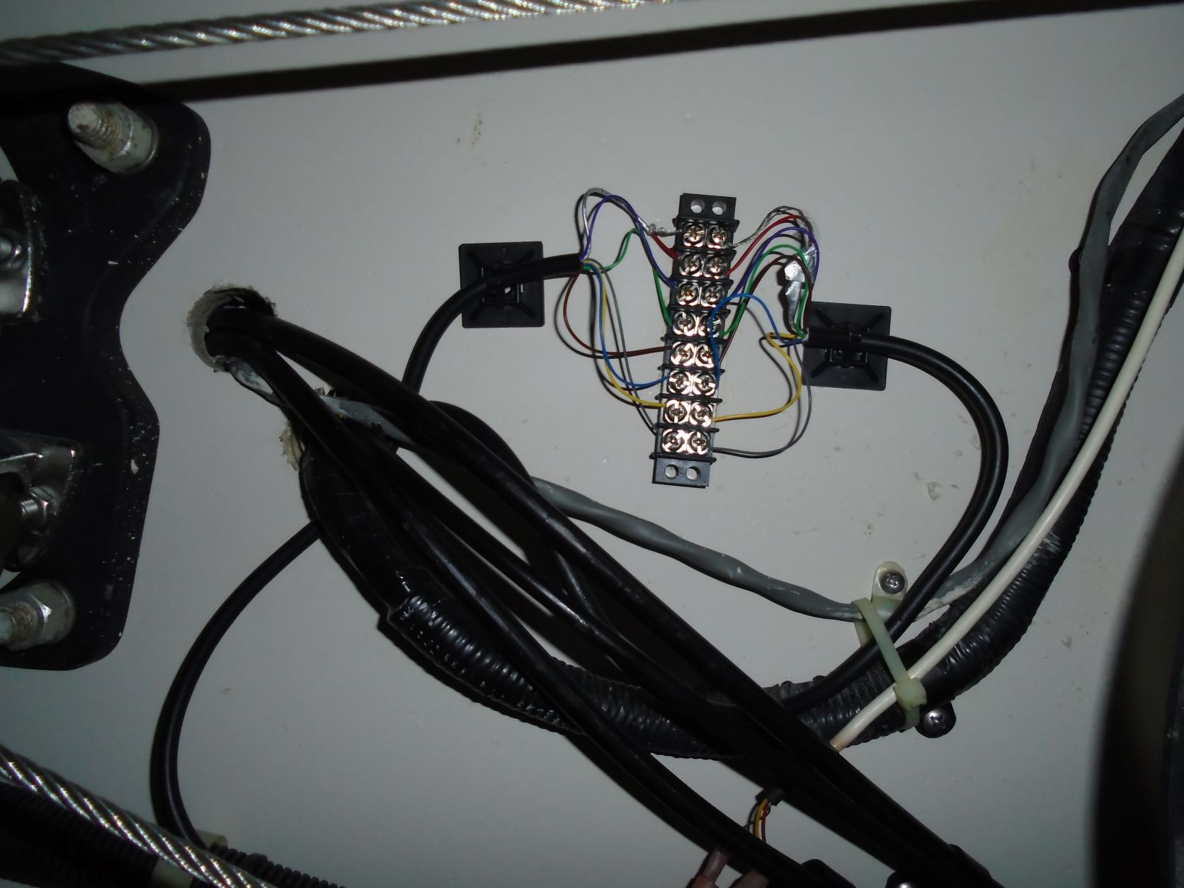

On my 2003 the RAM mic is in the admiral’s panel.  When I replaced the radio, I found cutting the cable and reconnecting it using a terminal board was the easiest way.

Thank you Bob. Looks like I will have to do the same, but somewhere inside the new NavPod. Any problems with radio interference? Thought the cable was shielded for that and thinking opening it up may cause an issue.

Tom,
I have been using it for several years now and yet to have any issues with it.
