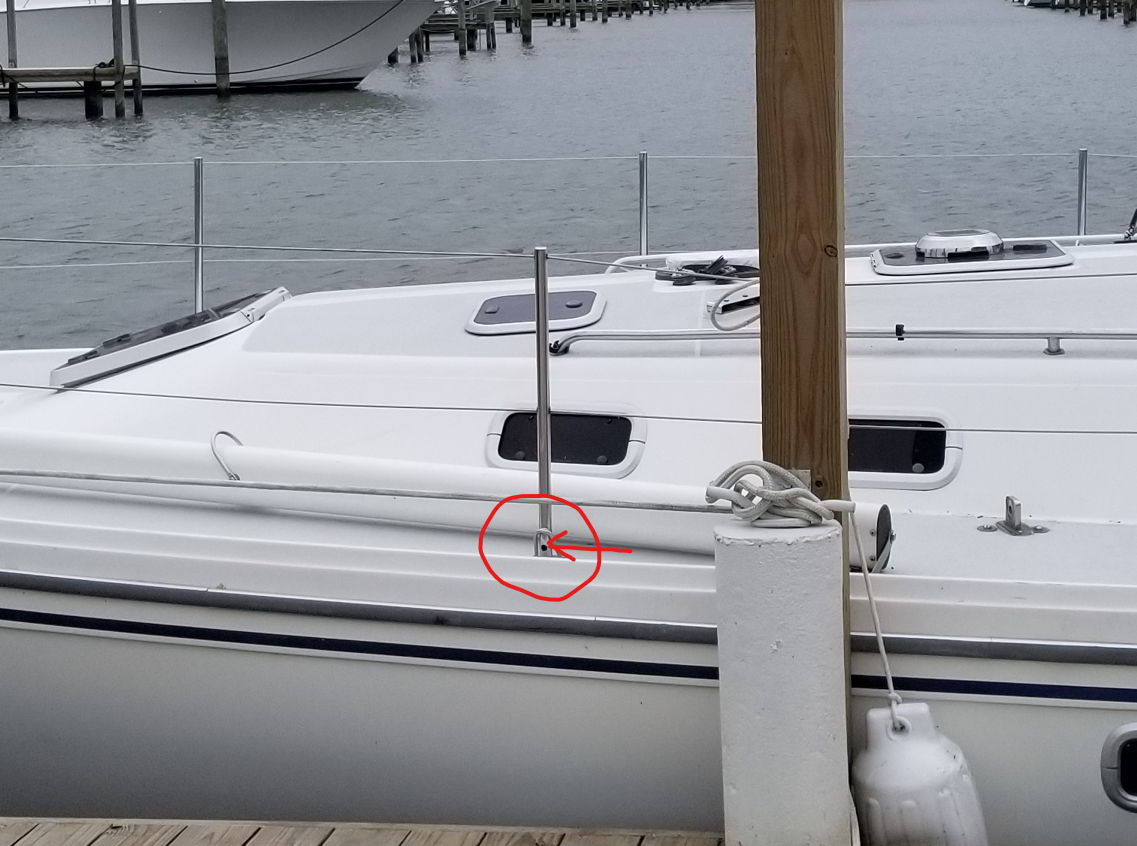

I have a 36mkii with a holding tank stanchion vent.  For a variety of reasons I suspect I have constriction somewhere in the system.  The only "openings" in the stanchion I can see above deck are the holes where the lifelines run through.  Was hoping to see if there was a clog above deck before taking things apart below deck. Where does the stanchion vent?
Posts: 591
Should see vent hole right in bottom of stanchion.

This is the vent on my Mk1.5.
