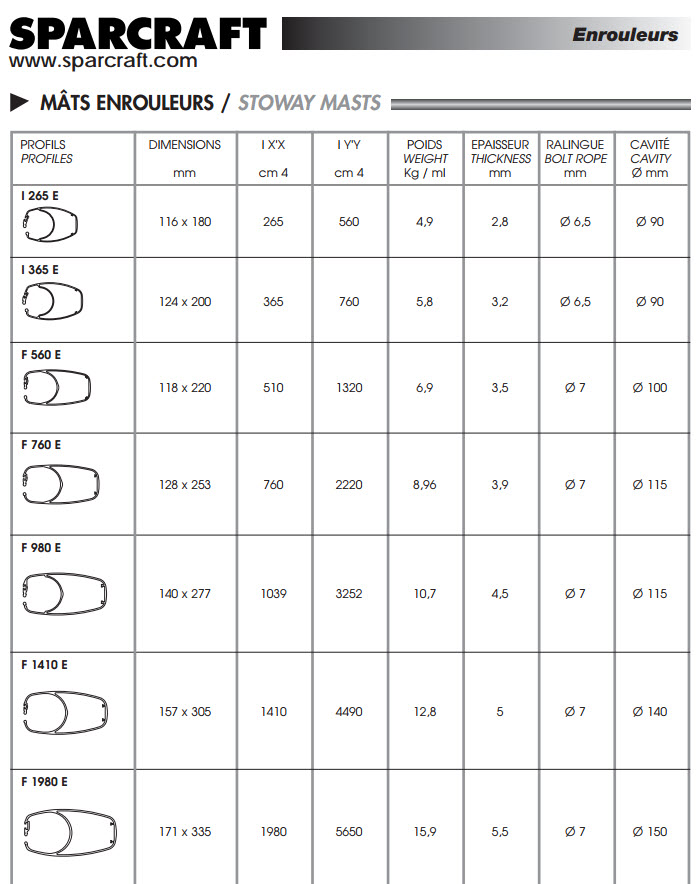

Anyone know which section profile was used on the 2004 C36 with furling mast?  I know it's one shown in the attached, but I don't know which one

My boat has a Charleston Spar Furling Mast and I have a Handbook for it which I downloaded from the web but I'm afraid I now cant find the source.
Anyway I believe Charleston was bought by Sparcraft and your mast may be the same section as shown in the attachment.
This is from a document from the C34 Forum and its the same as mine and the link is below.
Perhaps you could ask Sparcraft.
Hope this helps
www.c34.org/manuals/c34-inmast-furling.pd

The letter "f" is missing off the link and I meant to add its likely to be the F 560E section

Agree.  It's the ​F560-E section.

I think you will be able to find what you are looking for here.
https://www.catalina36.org/members/technical/manuals/charleston-spar-fur...
