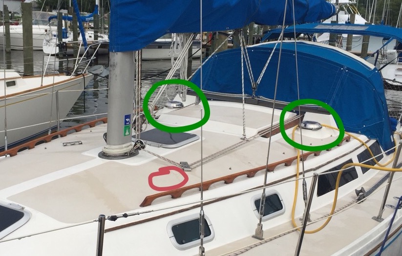

My C-36 had 2 Nicro vents installed by the previous owner (pictures attached). Each is installed in the cabin deck, one forward of the mast and one over the galley dry storage compartment. Both are set to exhaust mode and I leave a port in the aft cabin open to allow fresh air in (this port is covered by the bimini). I have not had problems with the jib sheets getting fowled on the forward vent and obviously have no water over the bow on Lake Lanier. While I would be hesitant to install these myself thru the deck, I have been pleased with the performance and location. They have not interfered with moving around on deck.
