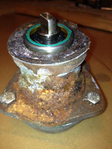

-Our Sherwood pump looked like it was brandnew but was solid rust on the backside
