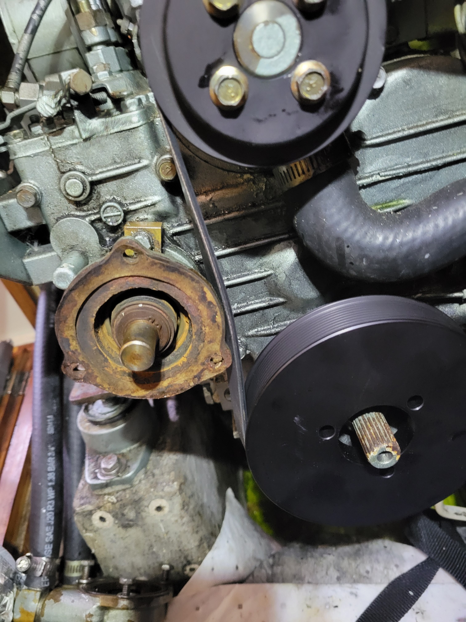

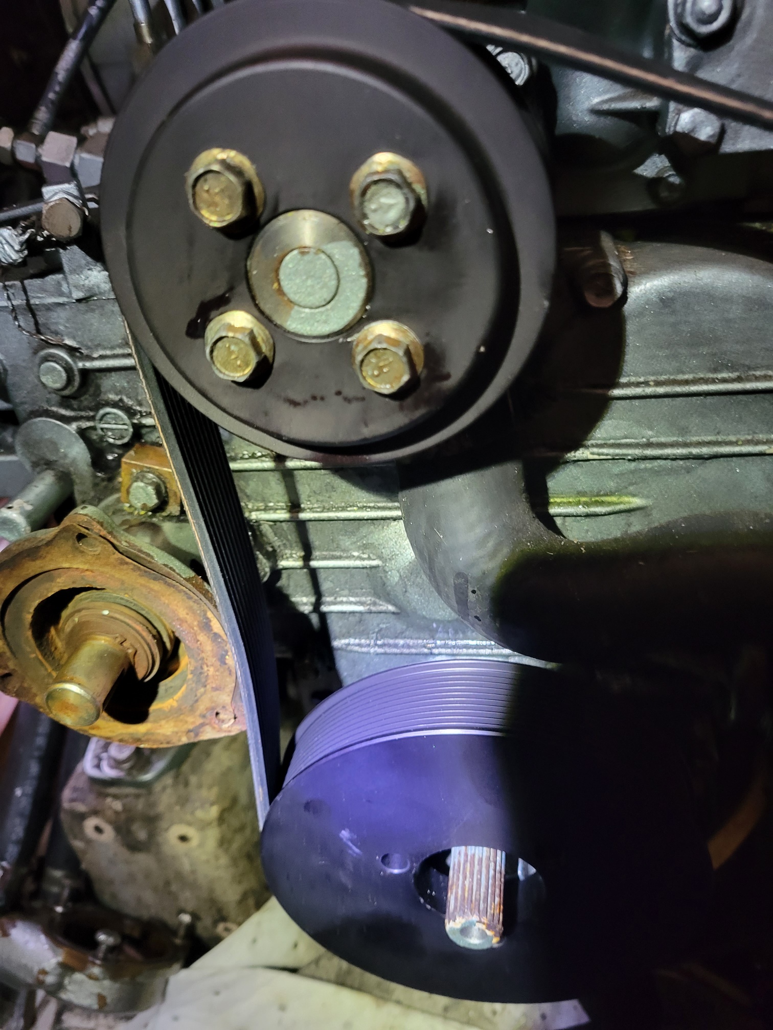

I am in the process of attempting to install a 105A alternator from CD.  I ordered serpentine belt and pulley kit from Electromaax that were designed for the M35 engine that I've got.  I have the water pump pulley installed and the crank pulley dry-fit in place.  It is apparent that the serpentine belt is going to hit the Sherwood water pump housing.  I don't understand what I'm doing wrong, or is this pulley kit not what it's supposed to be.  Has anyone else installed one of these?

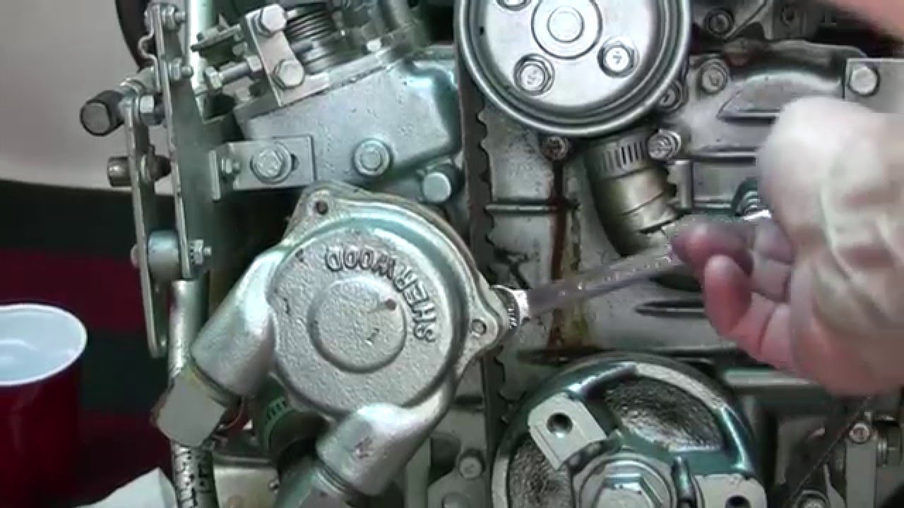

I don't have a "before" photo, but I found one online.  You can see how the original v-belt is thin enough to run behind the Sherwood pump.  My new serpentine is obviously much wider and does not fit behind.

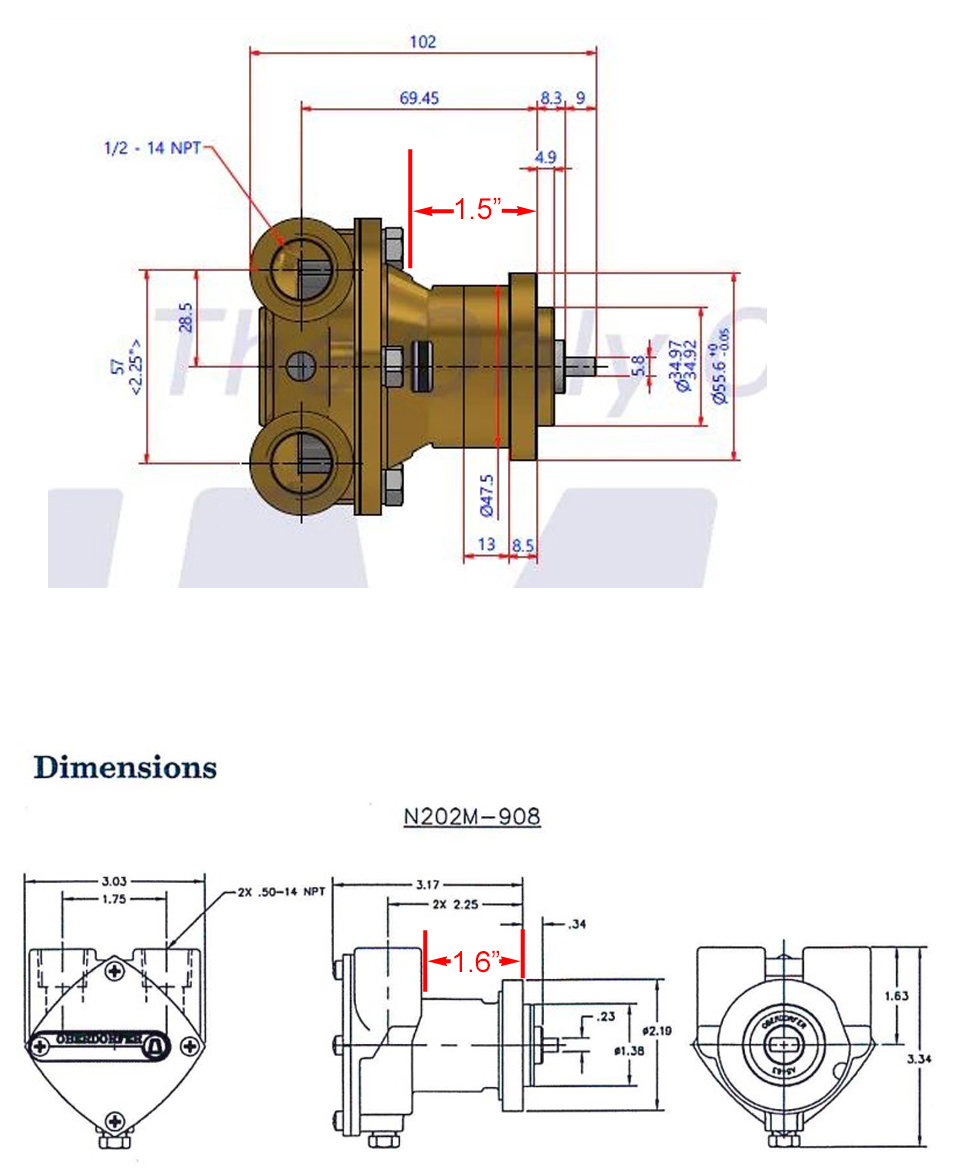

Comparing the published dimensions of the two water pumps, changing to the Oberdorfer pump does not solve the problem.  They both have nearly the same clearance behind that impeller housing flange.  1.5"  for the Sherwood pump, and 1.6" for the Oberdorfer.  I'm really stuck.

UPDATE.  The company that I bought the pulley kit from contacted me back.  They said that they have encountered this problem in the past, and that the solution is to change the new belt from a J10 to a J6, which is not as wide.  They said they will ship me the new size once I have verified that the original belt length is OK.  Let's hope this solves the problem!
