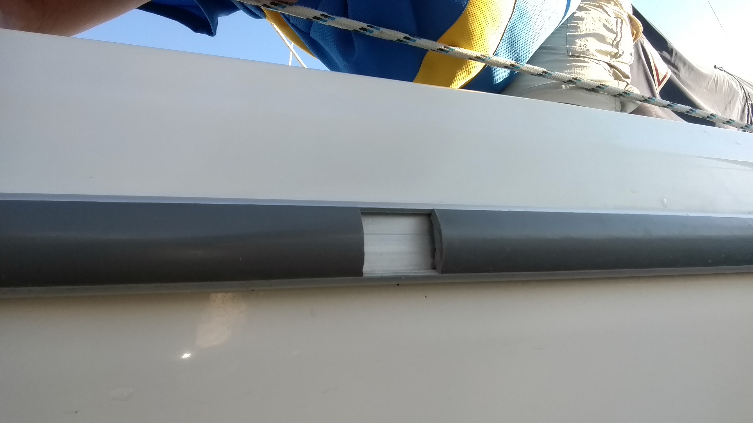

Tom - Here is a picture of the gap problem.

Ken,
That's exactly how I envisioned it in my mind. If you don't want to get a new rubber insert (either one piece long enough to go around the boat completely or one larger piece for the port side to make the joint at the stem fitting), you could try using super-glue on the ends, assuming the ends are very cleanly cut and square. Otherwise my previous suggestion stands: pull the ends together and put a self-tapping screw into each piece to hold them together.  It might not look the greatest, but it should hold. Hope this helps.

Posts: 22
Looks like the rub rail was stretched when it was inserted and with heat and time it went back to its normal shape.

Can't you obtain a 2" long piece (or what ever the gap is) of the vinyl and insert that?
