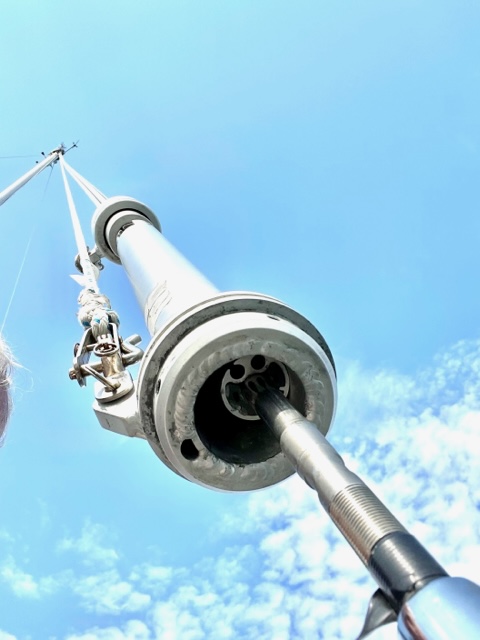

The attached photo shows the halyard attached to the torque tube shackle. Note that this cocks the torque tube which can add to the difficulty of freeing the foil from the turnbuckle . Tie the halyard to the sail feed to keep things aligned on the same axis.
