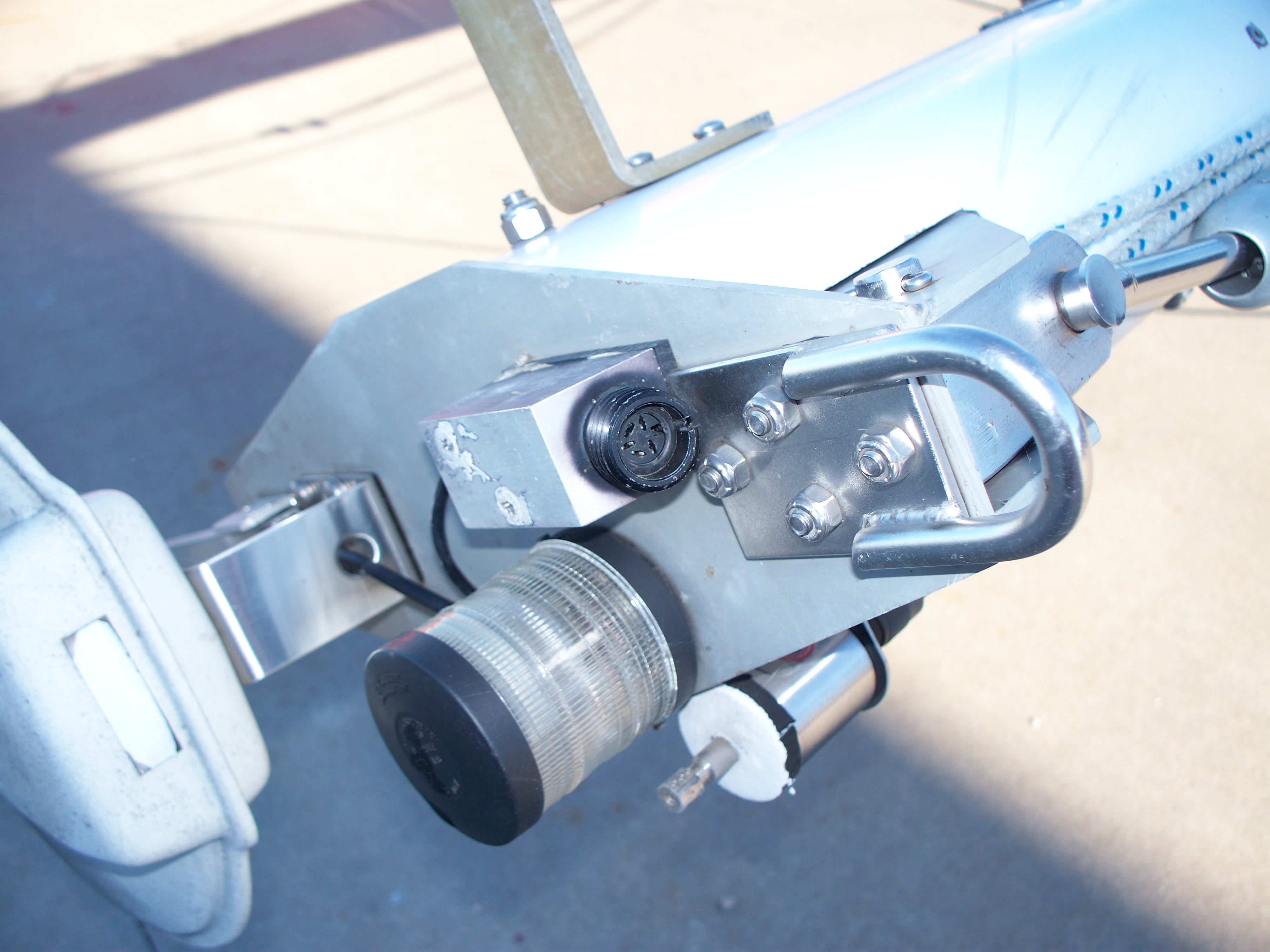

Hi Everyone,  my Raymarine ST60 wind indicator started going wonky last season and now it's completely kaput.  I went up to take a look last week and discovered that the connection between the transducer/indicator and the female-side cable was quite corroded.  I was able to clean the five male-side prongs on the transducer quite easily but the female side which is attached to box the (see picture) was not cleanable.  I'm convinced that this is the root cause of the problem because the unit turns on and off when I wiggled the connection.
So I bought a new cable with the plan to go back up to the top of the mast and unscrew the top of the cable housing box, dismount the female end from the box, cut the female tip of the cable off, attach the new cable with gorilla tape to the old cable and pull the new cable down thru the mast at the mast step.
Sounds simple...
But I know how these things go and that I’m probably missing some serious aspect of the problem that’s gonna leave me hangin...
Has anyone done this?  Any advice?

You may want to try some spray electrical contact cleaner before tackling the complete wire replacement.
CRC-Electronic-Cleaner-Quick-Dry-for-Sensitive-Electronics
Posts: 474
I am with Envision. Try using qtip stem with the cotton cut off, or wood tooth pick. Apply lanoline and reassemble before giving up.
should you decide to give up, I would use an 1/8" line such as curtain pull string and feed it from the bottom and pull from the top. Then feed back down the new cable.
