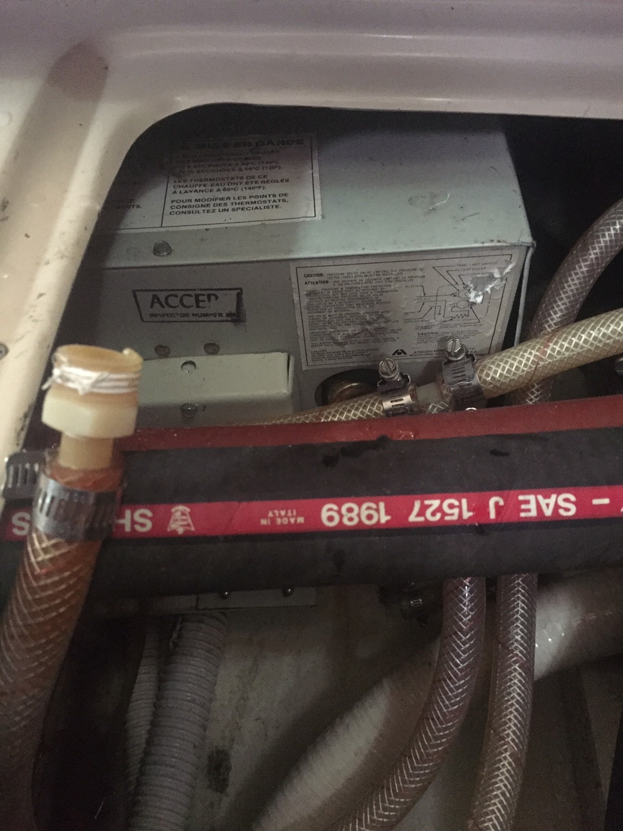

Anyone have the pleasure of replacing their fresh water heater on a 1990 vintage C-36?  ​I've sourced one at CATALINA DIRECT - Water Heater Seaward 6 Gal Galv CONNECTIONS FRONT.docx Suggestions are welcome.... thanks....

I've replaced mine on hull #1041, a 1990 model. The water heater that is a direct replacement is an  Atwood S-600 aka a Seaward. There are several 6 gallon models available and price depends on what material is used on the outside of the unit. Stainless is more expensive than painted steel. etc. I think I bought mine at Defender. It's not a big job but it's made easier if you remove the draws under the sink. It's a good opportunity to replace the hoses, if needed.

The three year old Seaward/Whale heater on Jubilee began oozing coolant (I have a hydronic heating system). When I went to replace it, I ran into the supply problem others have experienced. Looked everywhere and could not find one. Catalina Direct is out, citing supply issues. The only thing available was the significantly less expensive Kuuma version. Having no choice, I bought it, knowing it was 5/8 of an each higher than the Seaward and that it would not fit. We tried grinding and cutting, but no go, so had to take off the plywood platform it sits on. An easy one hour job turned into six.

Sorry that happened to you. I forget whether the heater was a front or rear connection but the Seaward 6 gallon went without to much of a mod. Defender Marine usually has a good stock of them and that is where I got mine. Removing the plywood platform had to be a pain - ask me how I know!  I replaced my platform with marine plywood as it was in poor shape and felt the same frustration -but my oscillating tool made short work of removing it. Then again, I did the work when the boat was on the hard.
