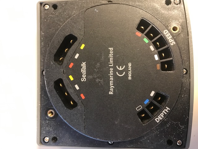

Hi,
Does anyone know where I can source the secret masonic screwdriver head that fits the ST60 instrument rear covers? Its not flat head or philips or any derivative I recognise. Not allen key either. Scoured the internet to no avail.

If I recall correctly, they are Pozidriv.

Looks like good old fashioned philllips#1 to me. ST60 Tridata.

It is hard to tell by the photo but I believe Nick is correct it is a Pozidriv.

Pozidriv screws are usually identified by having four tick marks or indentations around the cross.  If you see those tick marks, then you have a Pozidriv screw.  Pozidriv is an improvement over Phillips.  A Phillips screw driver will often work just fine as long as the screw is not too tight, which is what Pozidriv allows for - tighter screws.
