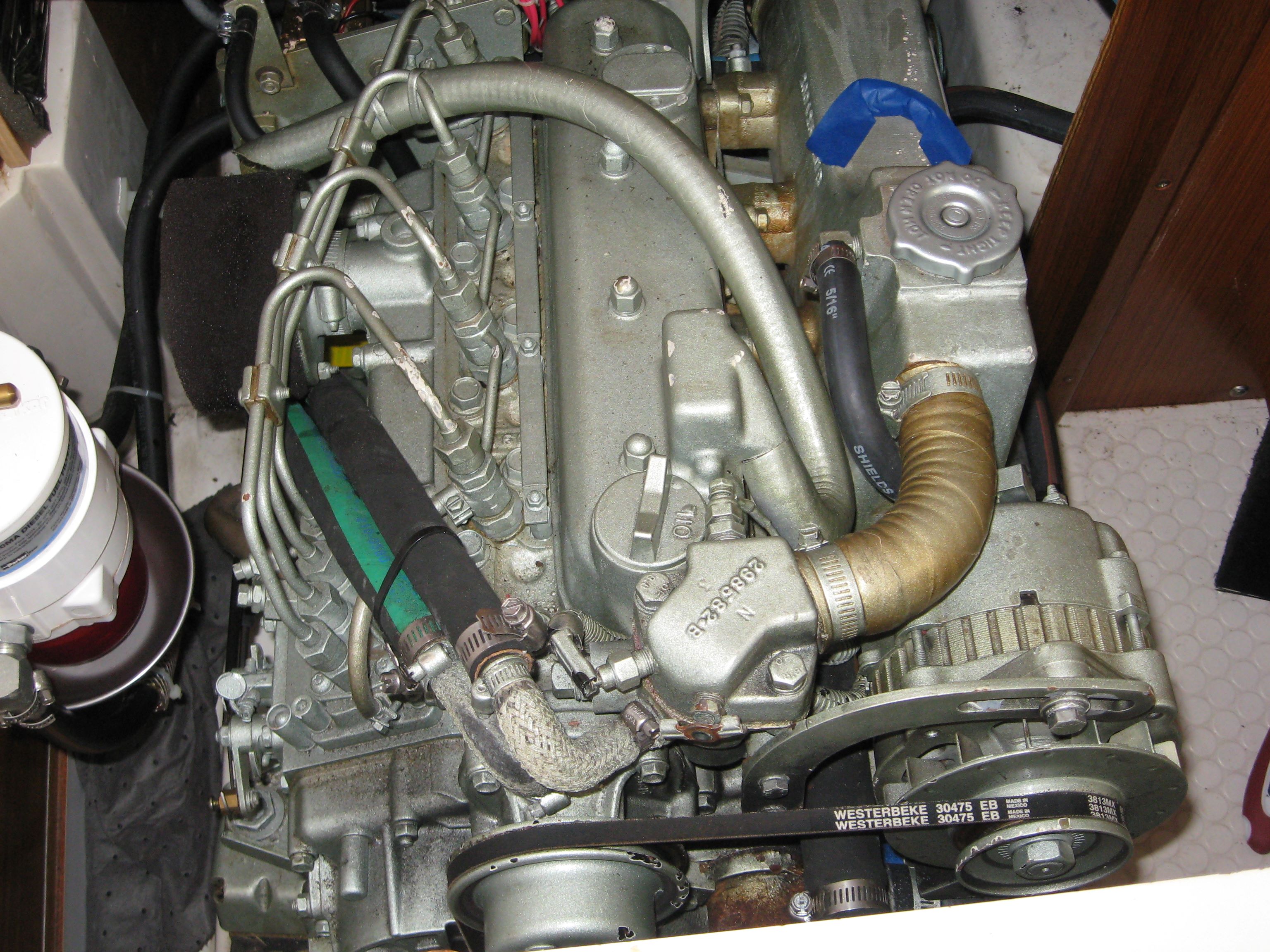

I changed the filter to a turbine unit and relocated it there a couple of years ago and no issues.  The picture shows part of the filter assembly, but you can see where it is mounted.

Ours is located on the port side of the engine compartment near the muffler; probably the standard location for the MKII. We've never had an issue with heat.

Just what I'm planning to do Bob.  What turbine unit did you choose?  I'm guessing the heat deflection shield under the filter allows you to have a clear glass/plastic bowl?

I installed the Turbine 500 MA model.  I believe the heat shield is a CG requirement.
