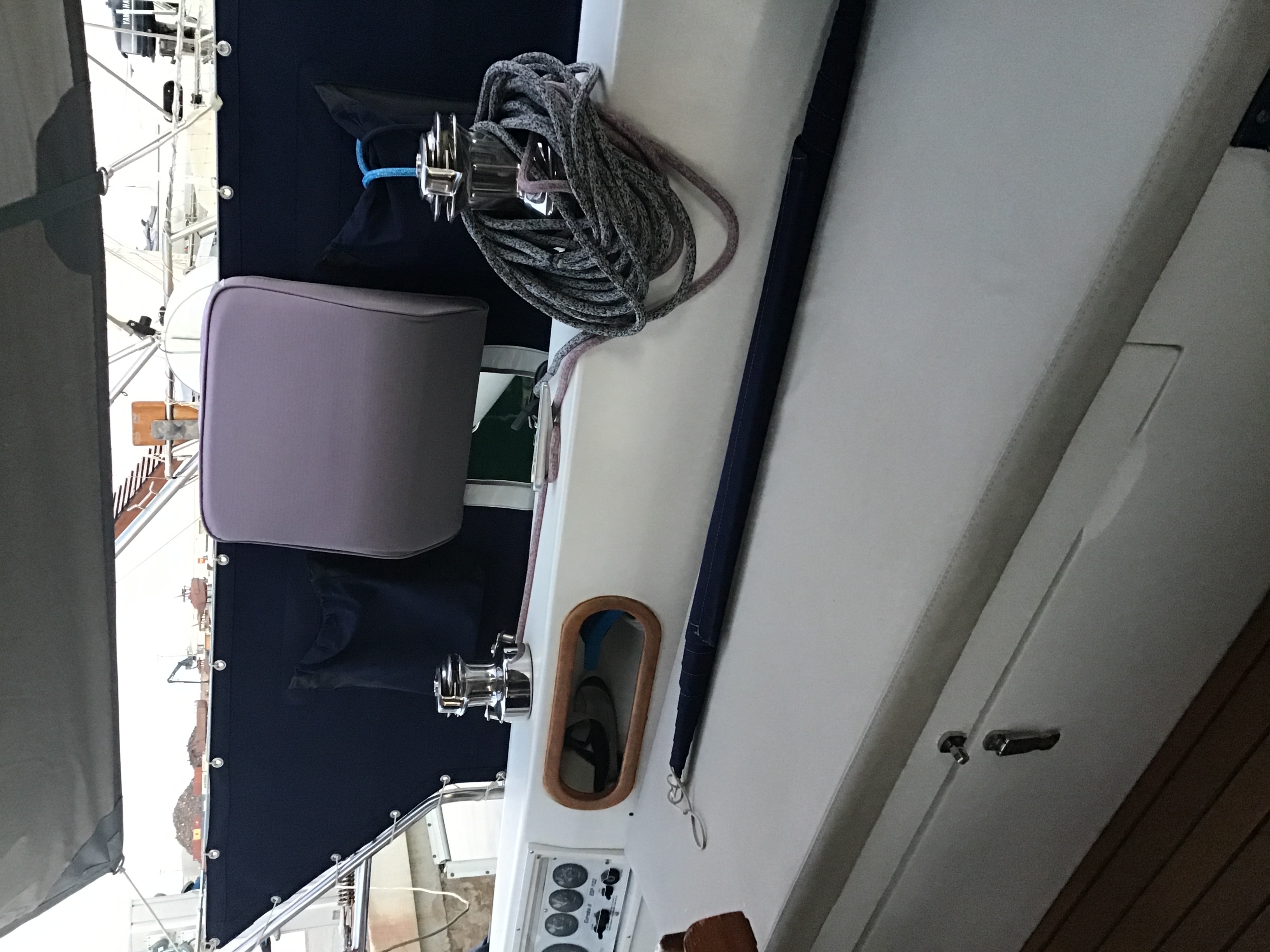

We added a second pair of winches, problem solved, also used for the spinnaker sheets.
