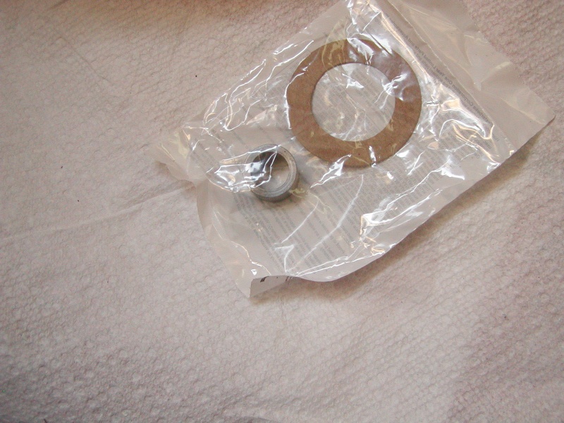

Once you remove your pump, you should check to make sure your engine is not missing the Cam Shaft Tang Reinforcing Sleeve as show in the enclosed Service Bulletin: https://www.westerbeke.com/service%20bulletin/service%20bulletin%20235%2...

If the ring that is supposed to be installed on the shaft is missing - Universal will send one to you free of charge. This ring prevents it from breaking. Contact them and provide the serial and the model number of your engine. If you reuse the in and out  "L" shaped hose connections - you must file one of them so that they do not touch each other.
https://www.catalina36.org/members/important-notices/missing-camshaft-sl...
Here is a post regarding the free ring

Not to bust a bubble, but if you read the bulletin Nick listed you will note that it is no longer being offered for free.
Posts: 473
I stand corrected - thank you for the update. I go it free and I have one that is in its original unopened contained. I will offer it to anyone who is willing to pay for shipping. It is for M35B engine.
