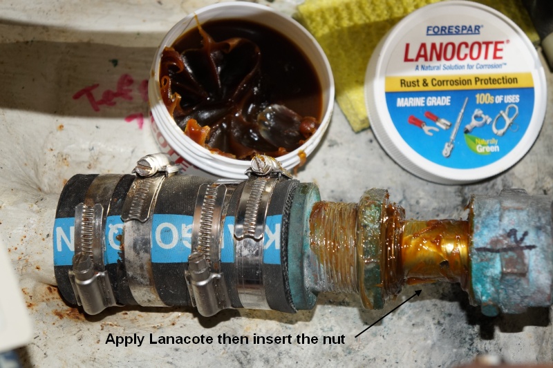

I replaced the flax with this 1/4" GFO GORE Flax over 3 years ago and have had very little leaks.
Pack Lanacote before installing the nut containing the 3 pieces of flax to make it work at its best.
Hand tighten the nut.
Just to be clear Lanacote is not packing, but a lube/coating that prevents corrosion.  You still need some Flax or graphite packing in there.  See https://marinehowto.com/re-packing-a-traditional-stuffing-box/.

I used the GFO GORE TEX. the manufacturer recomends to not use any packing. The graphite in the GFO provides the lubrication.
The Lanacote simply seals the propeller shaft before the flax and keeps the water from comming in.
As required there is still some drips when the propeller shaft turns. But after it is at rest the Lanacote hardens and prevents water from comming in.

Thanks for the pic of the packing!

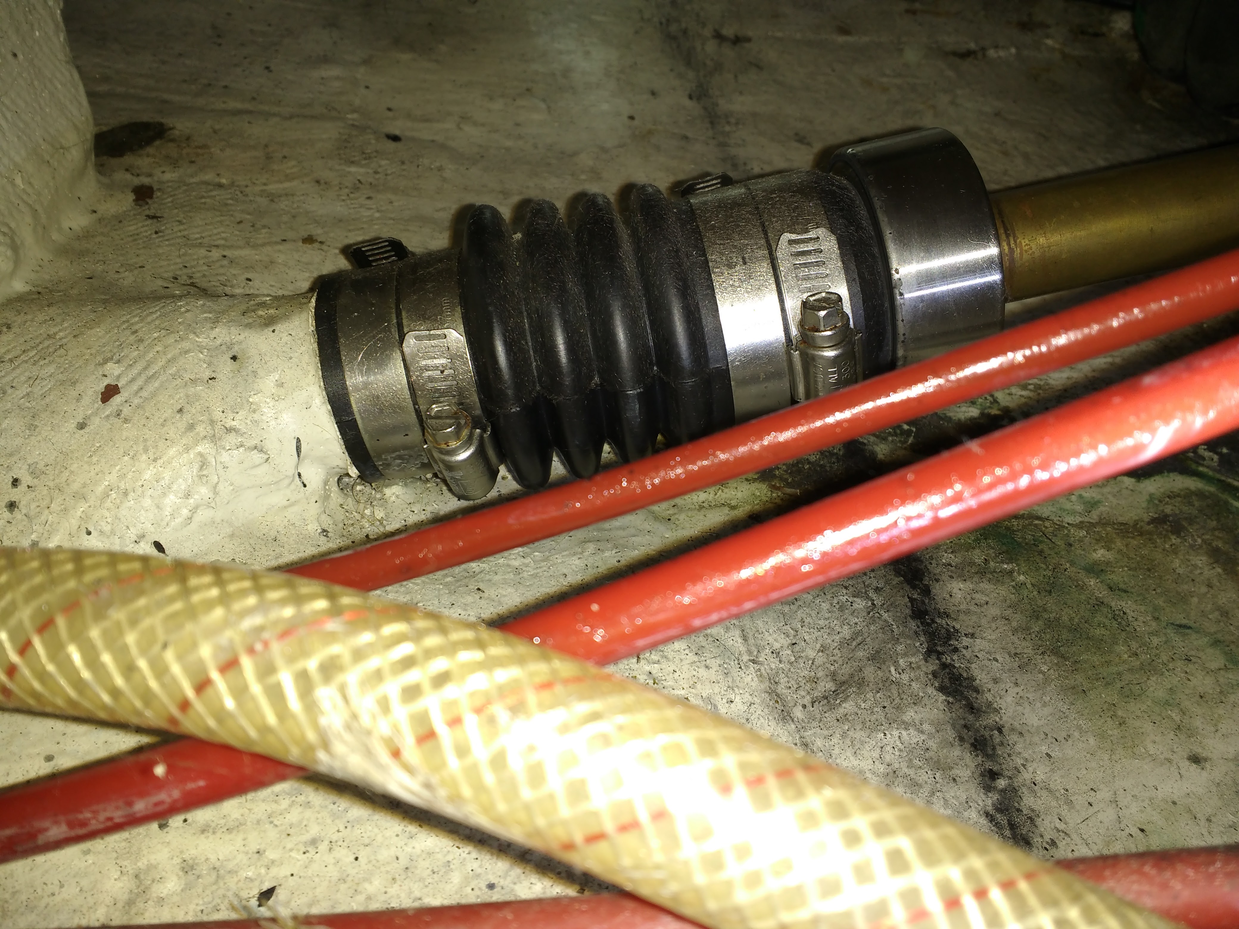

I have an 89 MK1 and a PSS dripless seal installed by the previous owner.  Works great so far.
Seems like there is plenty of room.
