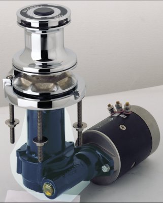

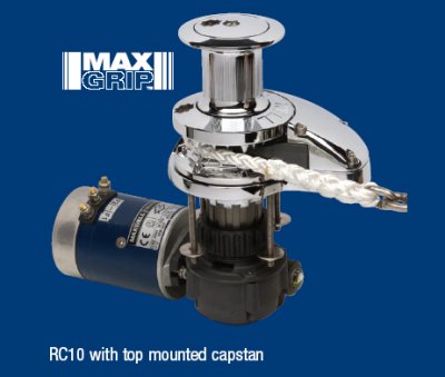

Larry or others may know the model windlass you have, but a picture would probably help, as Catalina has used different models over the years.
A bit of general advice; any windlass generates a LOT of power and will happily destroy your fingers, toes or any other body part that gets between the rope/chain and the drum. Take great care to stay away from the footswitch while taking the rope or chain on or off of the drum. Also, as Larry mentioned, some models have a slot into which you insert a handle to loosen/tighten the clutch; this allows the drum to spin freely or be locked fairly tight. NOTE that at least on my Maxwell VW1500 the handle spins with the drum. So make an adjustment and remove the handle prior to operating the windlass.
You may know all of the above, but if not, hopefully it'll help avoid an injury.
As to the windlasses, I attached some pics of models I've seen on Catalinas. I installed a VW1500, mounted horizontally to replace the undersized windlass that came on my boat (rope only). It can also be mounted vertically, through a hole in the anchor locker cover. I've never tried routing the rope through the wildcat, not sure that works with this model. The RC10 works with both rope and chain.
Others may have additional info or make corrections to the above.
