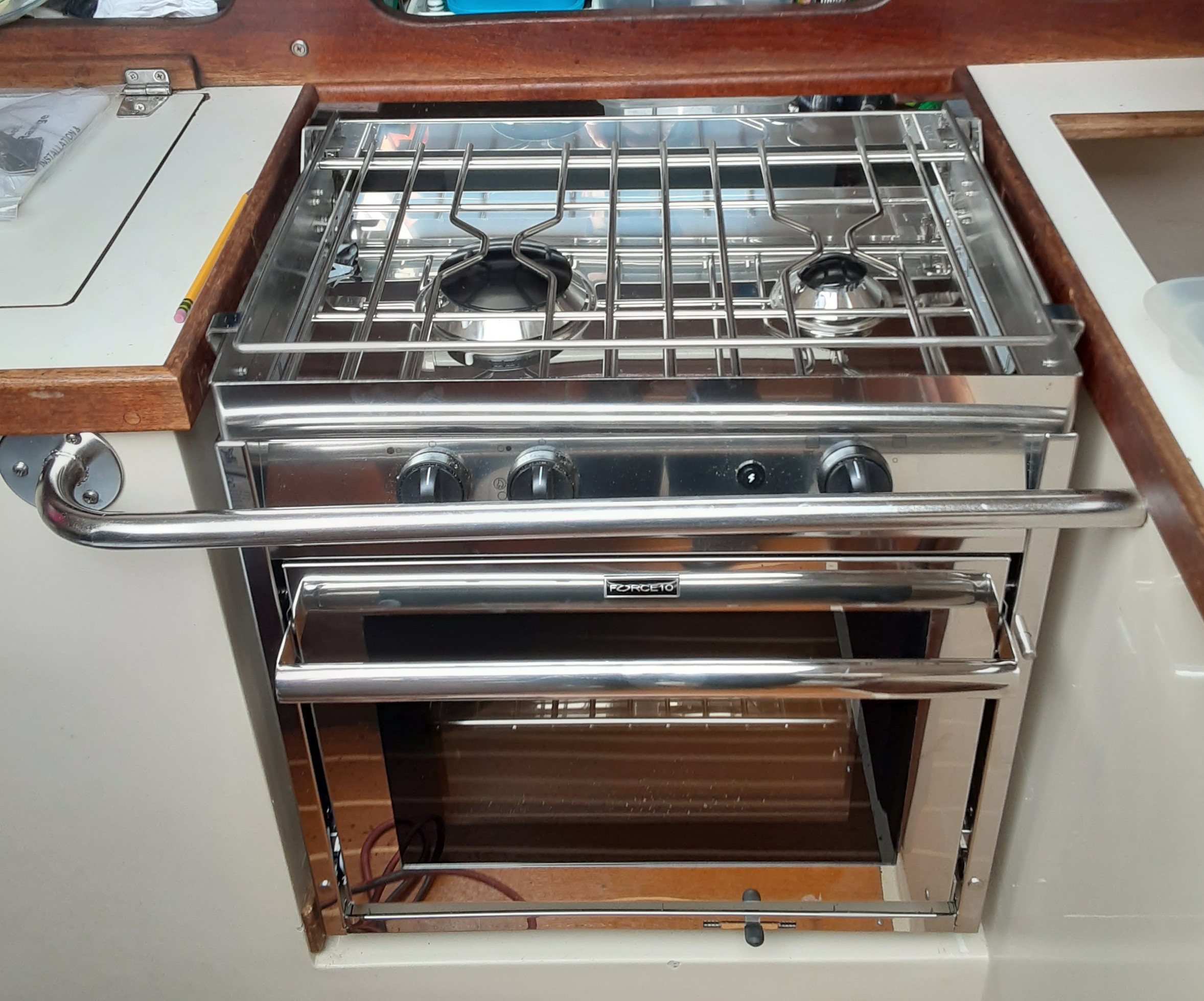

Just installed a Force 10 stove model 63251 (which, in their catalog, is called "American Standard" size) to replace the GSI CNG stove/oven in our 1985 Mk I #466.  It was a perfect fit -- it is essentially the same dimensions as our old GSI stove (which worked just fine, but, alas, getting CNG refills was getting to be close to impossible in our area, and will be impossible in some of the areas we intend to cruise to if the pandemic ever ends).   Indeed, the Force 10 dropped right into the existing gimbel brackets for the old GSI stove.

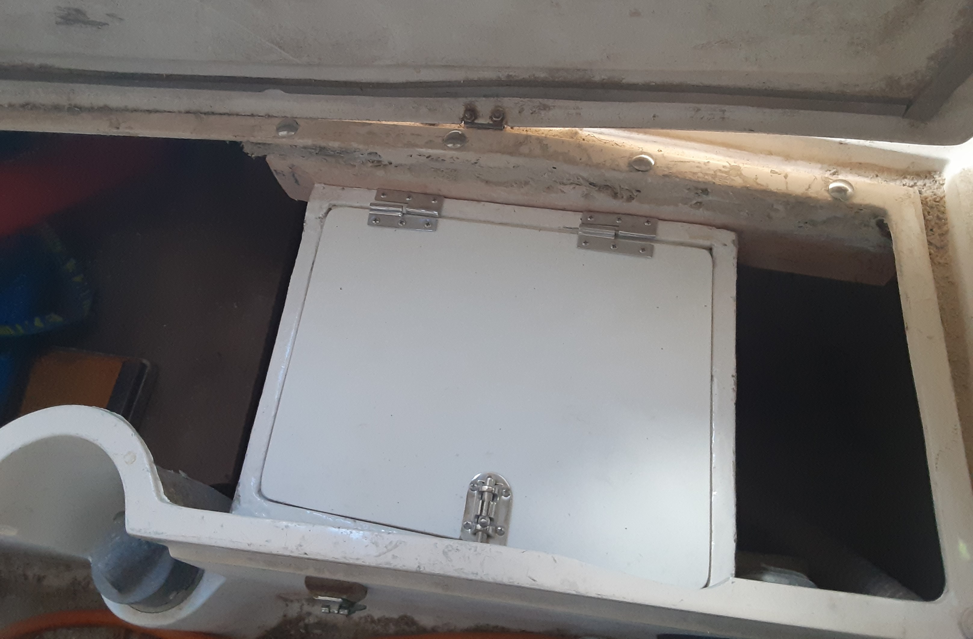

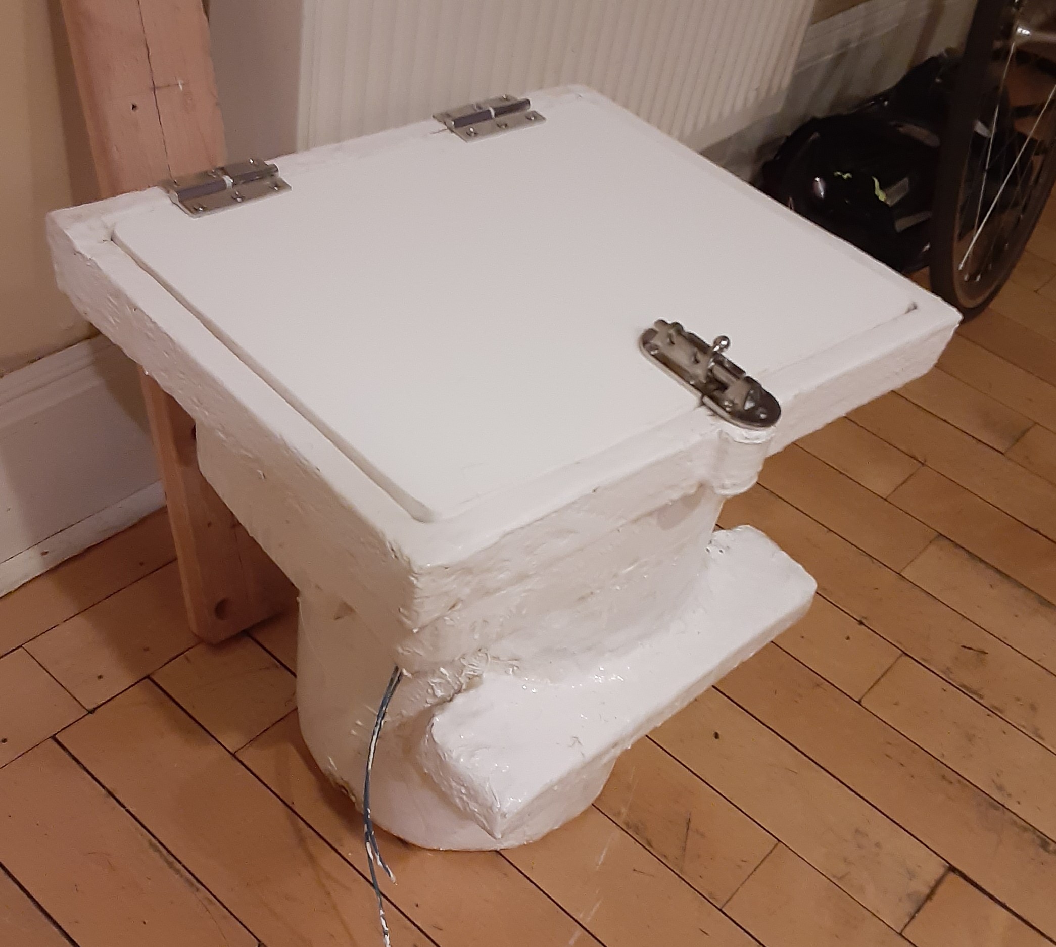

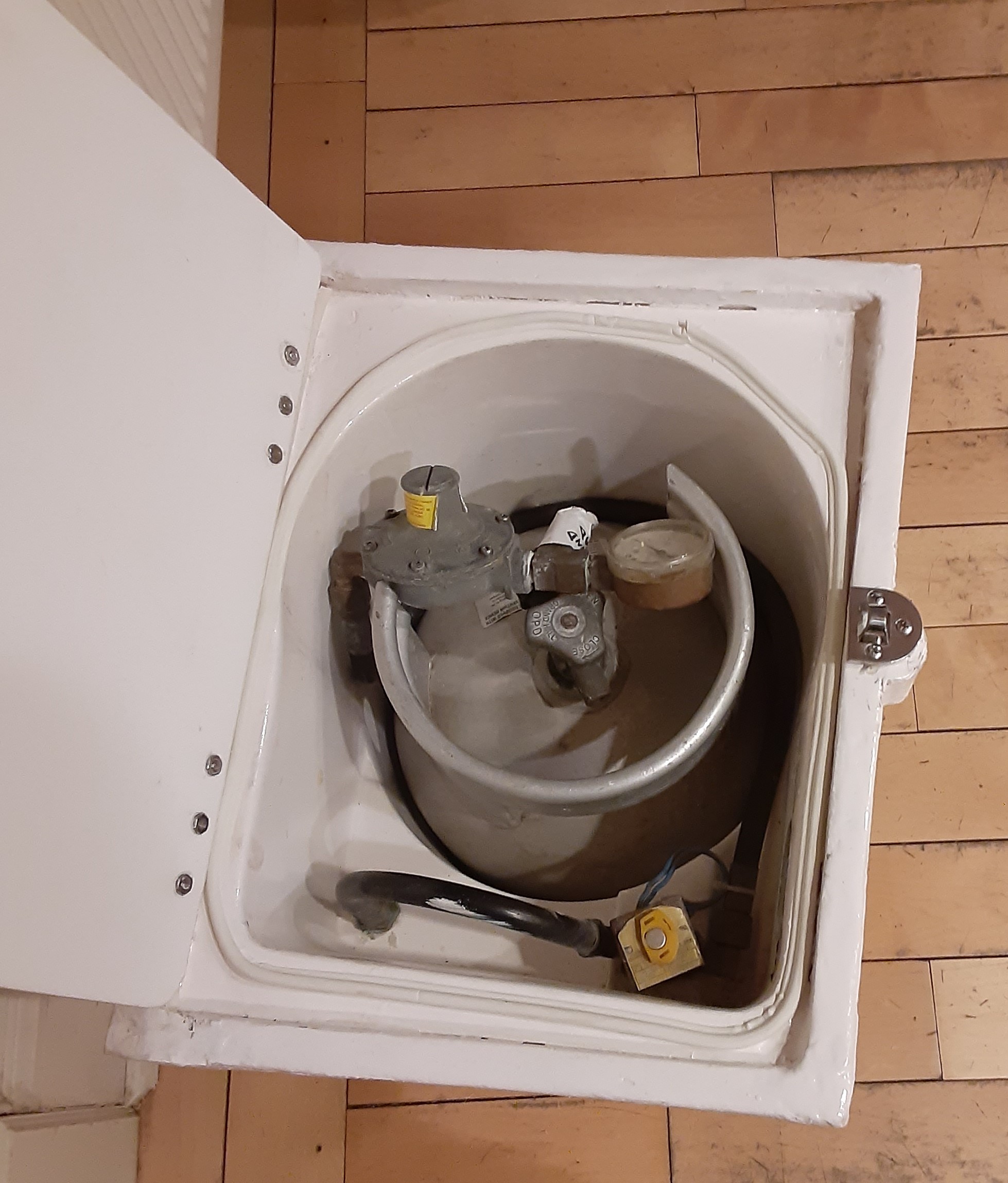

A C36IA member who was parting out his MK 1.5 (sadly wrecked in a hurricane) on this site's classified section here sold me the salvaged tank locker, which in his boat was a drop in to one of the two lazarettes (his boat had a walk through stern).  I glassed in various bits so that it could be mounted in the full-width lazarette found in our older boats have, as well as fashioned a lid out of starboard.
The locker does eat up some of that nice wide storage space in the lazarette (good for things like dingy oars, and our electric outboat), alas.   And having to add a solenoid, propane fume detector, etc., makes the conversion no small job.

Matthew,
I noticed in your picture of the stove that it appears you did something with your icebox lid. Do you have any post or details with what you did?
Gary
Gary -
Not sure what it is you are seeing vis-a-vis the icebox lid.  Other than add weatherstripping (not visible in the picture) and a clasp to hold it open, no mods
- Matt
Posts: 590
There is a hinge on backside of cover looks like you lift lid up in 1 piece rather than side 1/2 at a time. Wondering how that works for you?
Gary --
On ours -- as it came when we bought it (no idea if this was the factory setup) --the aft half of the icebox lit is hinged on the aft end (and flips up against the bulkhead).  The forward half is hinged on the port side and flips up against the dish cabinet (and has a take-apart hinge so it can be removed entirely if needed); I added a clasp for when we need to keep it opened.
Is yours different?  (Someone just posted pictures of their new boat and it looks like there is a hinge between the two halves)
-  Matthew
