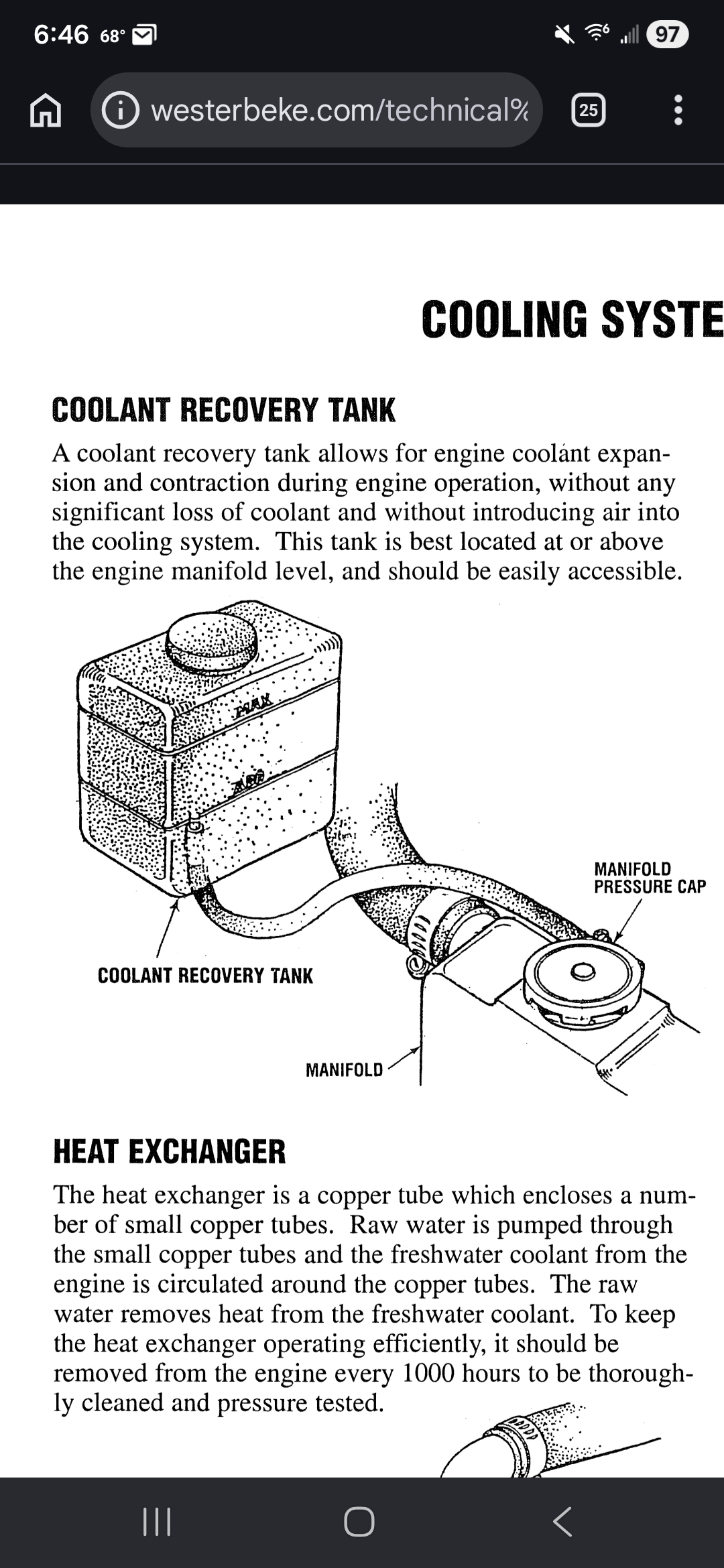

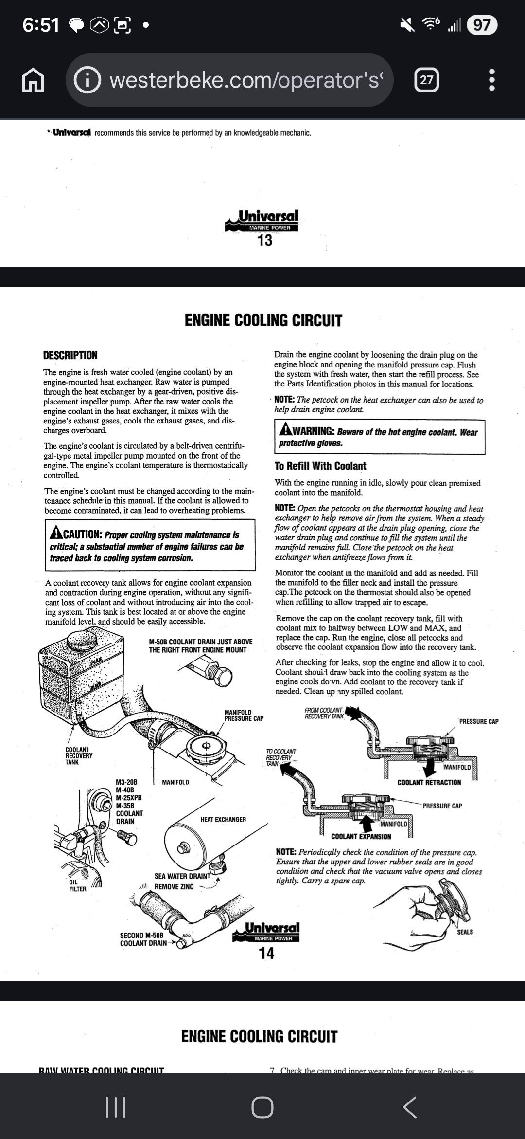

I got curious after reading the comment about the location of the recovery tank and found these in the owners manual and technician manual.  Per these books, the tank should be above the engine for proper performance.  The filling instructions also are in one of the pics.  Im not sure why it would be different in other years.  Mine is a 2001. Brad, what year and engine do you have?  I wonder if your cap has a Crack allowing airflow?

That's interesting, thanks for sending that info. It certainly makes sense that if you take the filler cap off, and there's a hose with head pressure it's going to briskly flow in to the manifold tank.
