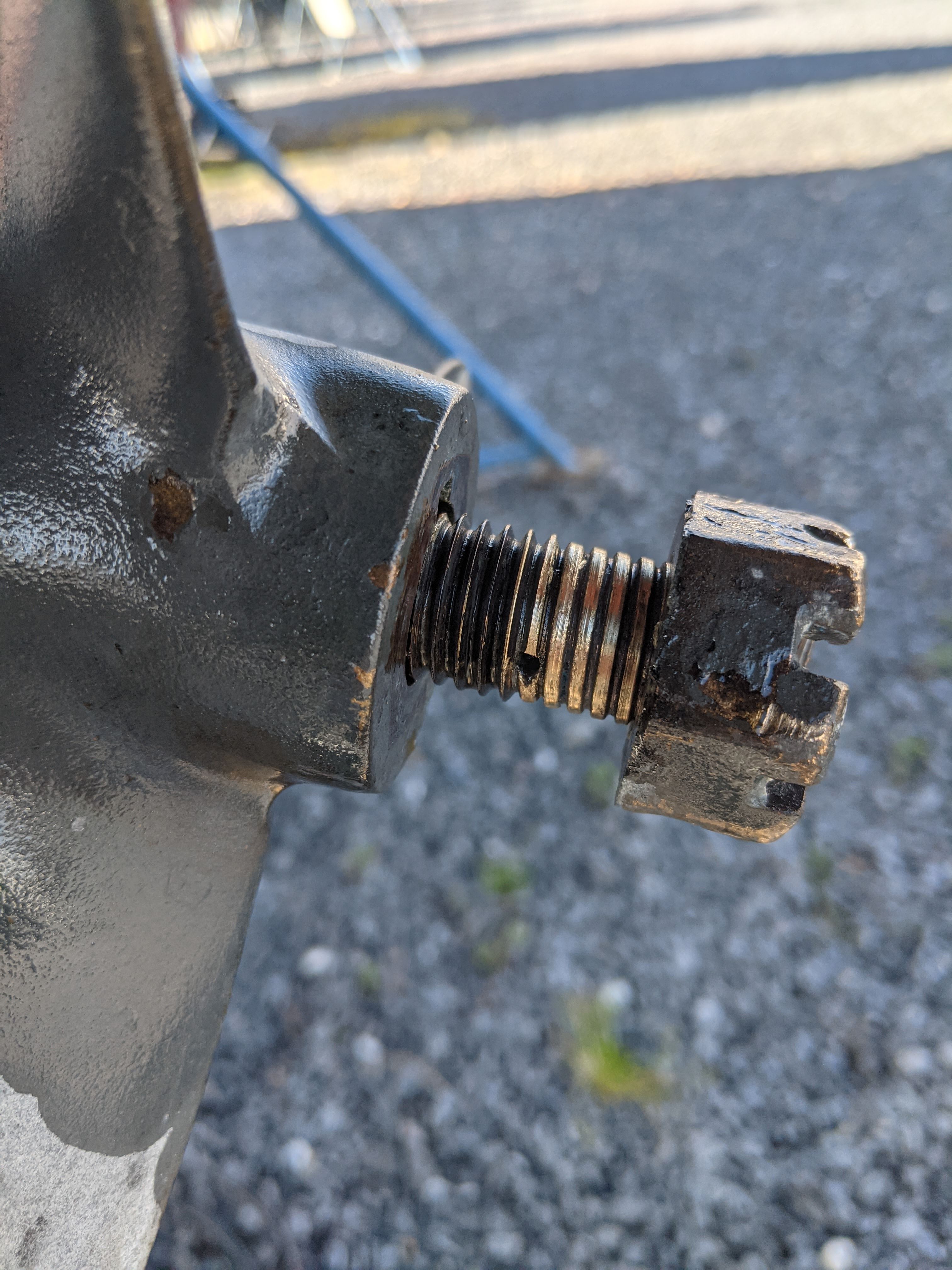

So I was all set to remove my cutlass bearing (Thanks for the tool!), and I couldn't get past the prop.  It looks like it hasn't been taken off.  Ever.  The original cutlass bearing is crumbing.  Bad.
So needless to say after being in the Bay the salt water has taken its toll.  I was able to get the castle nut off (thanks to a 1 1/4" socket which I'm putting in the box with the bearing removal tool) and was able to dig the heavily corroded brass cotter pin.  I had to break the pin initially, then dig the remains out after taking the castle nut off.  Stainless steel pin to replace the brass one?
So..given that the prop hasn't been removed at least in a while, it's a bit stuck.  I already have a three-pronged gear puller, but no joy.  I have left a few dimples in the end of the prop shaft now...I put some PB Blaster on it and will let it soak overnight.  I'd prefer not to wail on my prop with a hammer/mallet.  Any other suggestions to unstick and remove the prop?  I have a torch to apply some heat, but how hot should it get (or not get)?
Also, when removing the castle nut, those threads don't look good.  It almost looks as if the castle nut was cross-threaded the last time it was attached.  I can probably get it back on afterwards, but are those threads concerning (picture attached)?

It appears that the shaft is bronz. If so you may consider a new SS 322 shaft. I cut mine with hack saw into 4 pieces and pulled out. You will be able to remove the prop then with a little heat.

I would guess if you are able to fit the castle nut again that you would be able to have the propeller secured again, although I think it would be wise not to take risk and renew the shaft.
Also we faced removal of the propeller quite tough and at the end the prop came off but the shaft end was damaged by the puller, a piece broke off.
We had a new shaft made from Duplex-stainless.

Yeah, this is late, but I was successful in removing the prop the next day.  24 hours of PB blaster, a gear puller, a MAP gas torch on the hub, and a cold day.  When it finally broke it only moved about a quarter inch, but the gear puller got it the rest of the way.
This prop probably hasn't been pulled off ever, so I scraped/brushed out all the old corrosion before replacement.  Ew.
A quick note: the castle nut was originally retained by a brass/bronze cotter pin.  Nice to avoid galvanic corrosion on the prop shaft, but was mostly corroded itself, so the head broke when trying to extract.  Thus when I removed the castle nut, I expect that the remains of the cotter pin trashed the threads like you see above.  Lesson learned, and at least i have a breaker bar to get the castle nut off.  I put a stainless cotter pin to replace it, since that is (best as I can tell) much less likely to corrode to pieces.  There is some chance of galvanic corrosion, but the surface area isn't high and it's near the zincs.  I'll cross my fingers.
