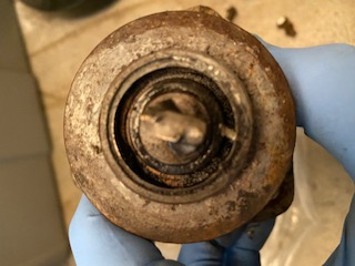

Started my engine on my boat today, and didn't see any water coming out of exhaust. I checked raw water strainer and thru hull, and didn't see an issue. Impeller is changed every year, so didn't feel that could be the cause. I pulled the engine cover and found a very rusted out raw water pump housing. Highly suspect this is my cause. I have a 2004 C36MKII with the M35B. Considering replacing with the Oberdorfer N202M-908. Wondering if anyone else has done this, and if I have the correct part #?

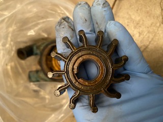

Additionally, if pump failure is due impeller fins breaking away, be sure to remove that debris from your heat exchanger.

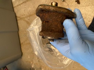

I’m in the minority but I’ve always felt that the Sherwood G908 is a better pump. There is nothing wrong with having your old pump properly rebuilt.  That said, by the looks of your pump body the seal has been leaking for a long time (years).    This could lead to a situation where it’s not rebuildable (I suspect this to be the case).

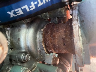

Search the forum and I’d be surprised if you don’t find a tutorial or photo essay of this common change over.   The readers digest version is that it is bolt up but requires modification  of the inlet/outlet 90’s.    The previous owners of our boat installed our Oby pump and provided a complete spare.  These were piped up by the vendor, Cardinal Pumps and Ill include a photo of the spare.
Cardinals solution was a little over the top.    The Sherwood G908 in/out 90’s are too close together for the Oberdorfer.  This prevents the second 90 from rotating in place.   Most owners just shorten one 90 until it clears.

Wow! This is ugly!

Impeller looks good.

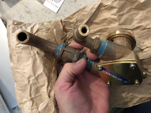

The new pump.

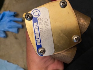

Successfully installed, but I have water dripping out of cover on front at bottom screw.
removed cover to see if O ring was there and properly seated. It was. Now what?

Ken Krawford
Joined: 8/27/20
Posts: 12
In the past those pumps came with an O-ring AND a paper gasket.  You only need one.  If you use both the pump face will leak.

My understanding is the paper gasket is for where the pump mounts to the engine. It is a circular gasket, and only location that it fits.
The pump comes with impeller and o ring already installed. I took the front cover off, and there was white grease on everything. I would imagine that this is mainly supposed to go on impeller, so you don't have a dry start. I don't know if this is causing the leak.

Ray Taylor's picture
Ray Taylor
Joined: 9/11/19
Posts: 81
Blair,
The bottom screw of the Oberdorfer face plate should be installed with locktite to prevent leaks.  This video shows the procedure around 9 minutes.  This may be the cause of your leak.
https://www.youtube.com/watch?v=2cOec7fNM_A(link is external)
The Impeller lubricant that Technician uses in this video is Jabsco Impeller lube. You should see or feel a waxy residue from this lube.   This is the only lubricant they recommend although many use lots of different lubes.   Sherwood recommends soapy water or silicone.
Additionally I spoke with the pump technicians at Oberdorfer earlier this year.  At that time the only lubricant they recommend was Jabsco Impeller Lubricant.  It’s is a clear honey colored lube.  It seems odd that your pump has white grease, also the impeller and shaft are not installed when the pump is shipped.  This prevents the impeller from taking a set during storage.

Posts: 446
Blair, I replaced the original 4 screws with allenhead screws. To prevent leaks I apply ample amount of lanocoat then tightening the screws. Run the engine withe cover on so it becomes warm then tighten screws more.
Haro.
Posts: 686
I would not suggest using loctite on the screw or it will be difficult to impossible to remove in the future.
The bottom line is there should be no leak if everything is made correctly. Check that the O ring is not damaged (no nicks or cuts) as well as the grove that it sits in is not damaged (no metal burrs). Also check the plate flatness with a metal straightedge (there should be no visible scratches and no gaps between the plate and straight edge).  Did they supply a proper diameter O ring? 10%-15% of its thickness should be sitting above the groove when its seated to create an effective seal.

Posts: 686
Blair-
Isn't the o-ring located inboard of the four plate screws? Refresh my memory on that point. If so, and you are getting an apparent leak through one of the screws, it's really not the screw, it's the o-ring not sealing correctly. If it's not sealing, then its probably also allowing air to be sucked into the pump and therefore the pump would be loosing suction until you overcome it with increased RPM. You should be seeing water flow out the exhaust at engine idle. Again, if the face plate is slightly bowed and not perfectly flat, there is damage to the o-ring grove or o-ring itself, the pump will leak and suction will be compromised.
