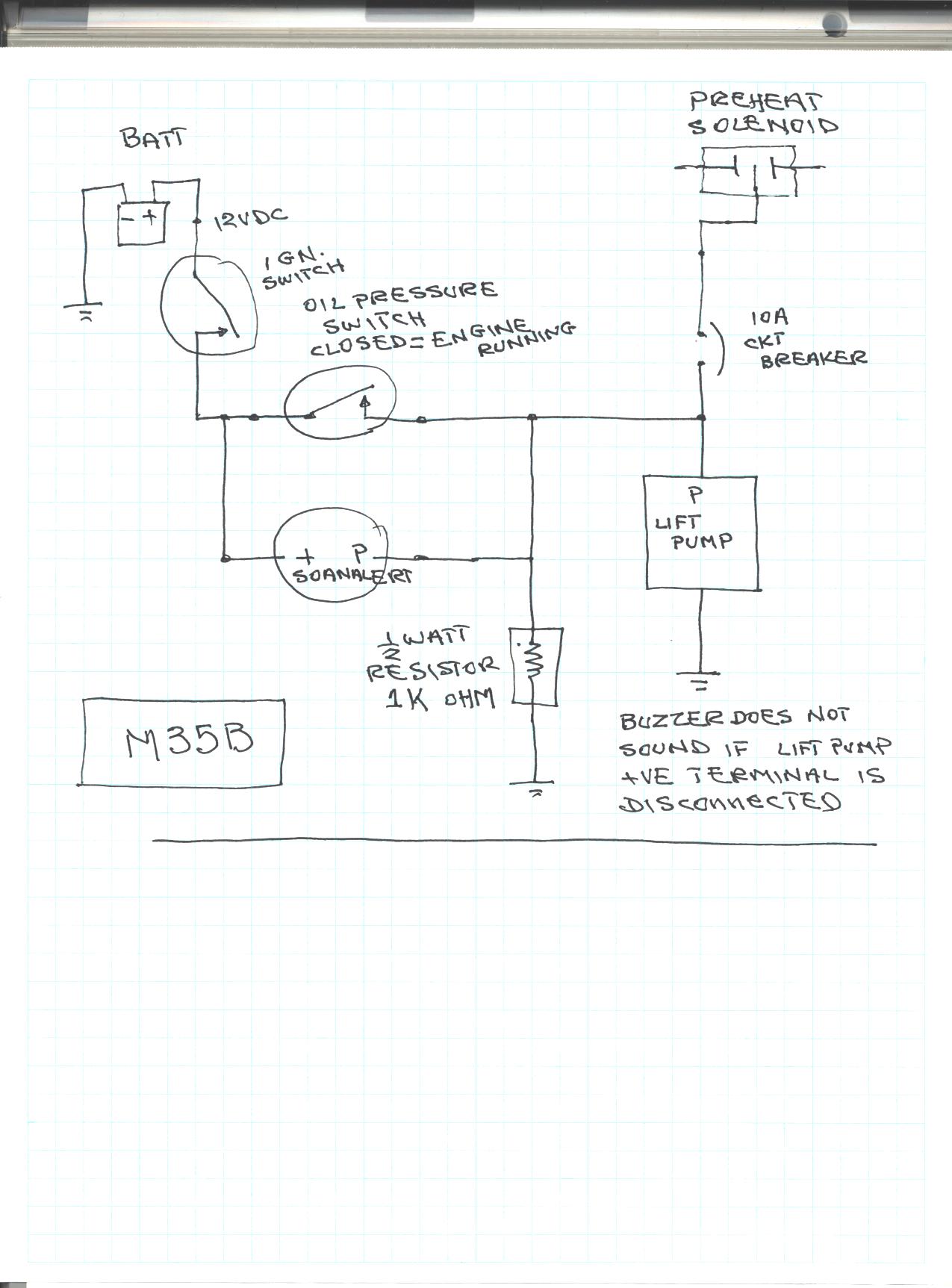

Having a degree in electrical engineering has helped me to study and understand the wiring diagram. It was interesting to see that its contacts provide current to the Fuel Lift Pump. In looking at the wiring diagram you see that the switch contacts places a short across the buzzer (+ and P ). This means that it will make no sound when there is sufficient oil pressure. The only way that the buzzer will sound is if the switch is open. This could happen if the oil pump is failing to pumping enough oil.
Please see the PDF file I have included. According to this diagram I do not see a resistor. Can you tell me where you found the resistor - and if possible can you provide a photo.

Your PDF is too low resolution to follow clearly, but it did aid my memory a bit. Can you re-post the PDF here as a higher res file? The system accepts attachments up to about 310kb; your file is only 120kb, so you have room for a higher res PDF. If the system won't let you post a larger file, then please email the schematic PDF in full resolution to me at LCBrandt(at)coastpilot(dot)com. I will then post it in the Technical - Reference section of our website for future access by Members (capital M).
There is one other possible symptom you haven't mentioned: In my case, when beginning to start the engine, I turned the key to the 1 o'clock position (but not yet pushed the Start button). At this point the warning buzzer should be loud and continuous beeping. During the time my resistor was failed this warning buzzer was not able to be heard. Do you have that symptom also???
The resistor I found failed open due to vibration is the one coming off the terminal of the Preheat Solenoid. It appears very blurry in your PDF, but it is there. And it is located in my boat actually coming off that solenoid. It is a small 1/4 or 1/2 watt resistor that goes to ground. I don't remember the resistance. When I replaced this resistor, I soldered copper braid (that I scrounged from a short piece of coax) to each end of the resistor thinking that the braid would isolate the new resistor from engine vibration. Then I insulated the 12 volt end of the braid, of course.
Without having a high res schematic at hand and re-reading your post I don't have a 'feel' of whether this resistor could give you the symptoms you describe. I am going on past experience and 'hunch' here, thinking that any weird symptom involving the oil px warning buzzer might be related to that resistor failing. In my case the resistor lead broke, failing open.

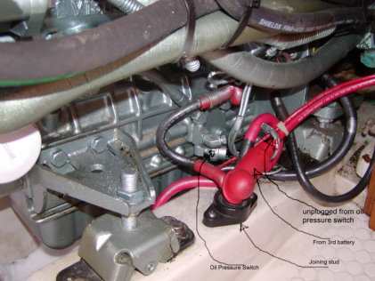

I can not thank you enough gentlemen for your input - Larry and tsenator -you were both right.
If you would like to know how all this happened read the last section of this post.
[B]Problem fixed![/B]
tsenator - you were right on - meta terminal or the "tang" as you call it or/and the wire leading to it was broken. I cut about 6" off of both of the wires and soldered new wires with new connectors. Works.
Larry - I found the 1K 1/2Watt resistor near the 10A circuit breaker next to the glow plug solenoid. But it was not causing any problem. It already has wire pig tails on either side. I am not sure what the purpose of this resistor is. See my hand drawn diagram here. It appears that the resistor is provided to complete the current through the buzzer so that it may sound. But this is not true. The buzzer stops sounding only when you disconnect the fuel lift pump +ve wire, which means that if the fuel pump is defective the buzzer will not sound - when the ignition key is on and the engine is not running. The buzzer requires 24VDC instead of 12VDC - I do not know why 24 VDC was selected instead.
Wiring diagram - Here is a link to the manual. on page 98 you will find electrical diagrams. This is a good site to find parts list and manuals on PDF. [url]http://www.westerbeke.com/OnlineManuals/200554_M-25XPB_M35B_M40B_Technic...

In viewing the photo I have uploaded - you will see that there are some additionl thick battery cable that was added.
If I can be a detective I suspect that the previous owner added a radar. Since the radar uses addtional power the owner found out that they could not start the engine after a day of sail. The boat yard advised them to add a dedicated start battery. This was added with another switch and was located in the port lazzarette. The cables were routed arround the fuel tank and bolted to the lug you see in the photo. I suspect that the installer was not carfull in working in this area and caused physical damage both to the oil pressure switch and nearby wires connected to it.

Hi Gary - I have posted a simplifed diagram here on post #9 above. You can see it if you go back one page. I hope that helps.
