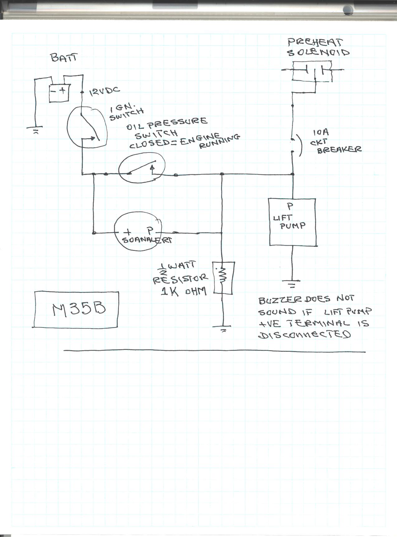

Seabird, there is a 1000 ohms resistor near the lift pump that is part of this circuit. Check if there are loose wires there.
You can test if the oil pressure sensor is at fault by disconnecting both wires and turning on the ignition, should hear the alarm, shorting them to each other turns off the alarm. This allows you to look for loose connections wherever it may be without running the engine.

Interesting timing. I'm also having my oil pressure light come on and the alarm sometimes sounding and sometimes not. Actually it sounds like it's dying sometimes. Oil light stays on all the time though. Oil level is fine, no oil leaks and engine seems to run fine. Figuring it was the oil pressure switch I bought a new one. However, before I made the change I decided to test the system by running a jumper wire between the two leads going into the switch. Unfortunately the oil light still came on with the jumper wire attached. Glad I did this before working on the oil switch, but anyone have ideas what this may be? Engine has no problem starting and continuing to run, but know the fuel lift pump may turn off with the the potential of shutting down the engine. My next step is to check out the connections back at the wheel, but if they are ok I'm really stuck as what to do. Any suggestions at helping me trace this down would be great.
Tom Runiewicz
ObLaDi ObLaDa
Catalina 36 MkII, Wing Keel, Tall Rig
Hull #1998
North East, MD
Posts: 473
Please visit my earlier post on the oil pressure switch that includes images and electrical wiring diagram at this website
https://www.catalina36.org/forum/technical-discussion/36-mkii-oil-pressu...
Wiring Diagram  https://www.catalina36.org/sites/default/files/forum/WiringDiag_OilPress...

Where  is that 1/2 watt resistor?

it is a tiny resistor and hard to see - near the lift-pump and well protected by a shrinkage sleeve, just thicker than the cable.

Several years back, I was singlehanding and anchored in foggy, howling Drake's Bay...the only boat there, and I was glad to get the motor off and hook down. Only thing was, the oil alarm did not sound when I turned the engine off (ignition still on). Next morning, she did not start immediately, as she usually does...and I could not hear the fuel pump. Luckily, I have a second fuel pump arrangement for bleeding and backup, so I turned that on and she fired right up.
Later that day I traced the whole problem to that exact tiny resistor Haro/Sail La Vie is referring to. It had become disconnected inside its little casing. I kludged it back together with some electrical tape and things were back to normal.
