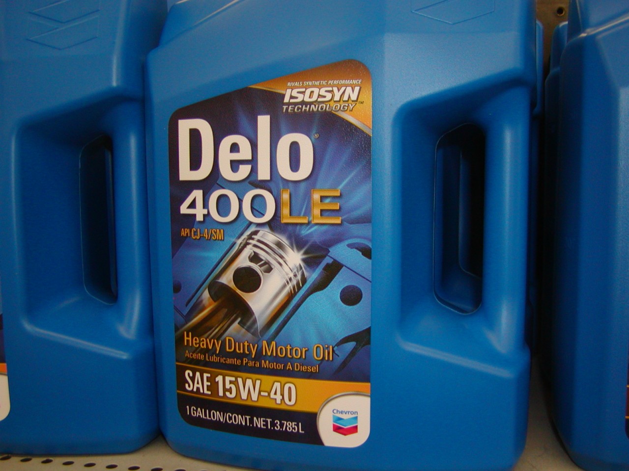

Raymond - I have M35B. I use engine oil - Standard Oil Delo 400LE 15W-40 CJ-4/SM for diesel engine About $18.00 for 4 quarts. The oil filter is WIX 51365 at $ 9.00. Both are available in any auto store. The engine capacity is 3.4 Quarts of oil and manufacture recommendations is to change every 100 hours.
