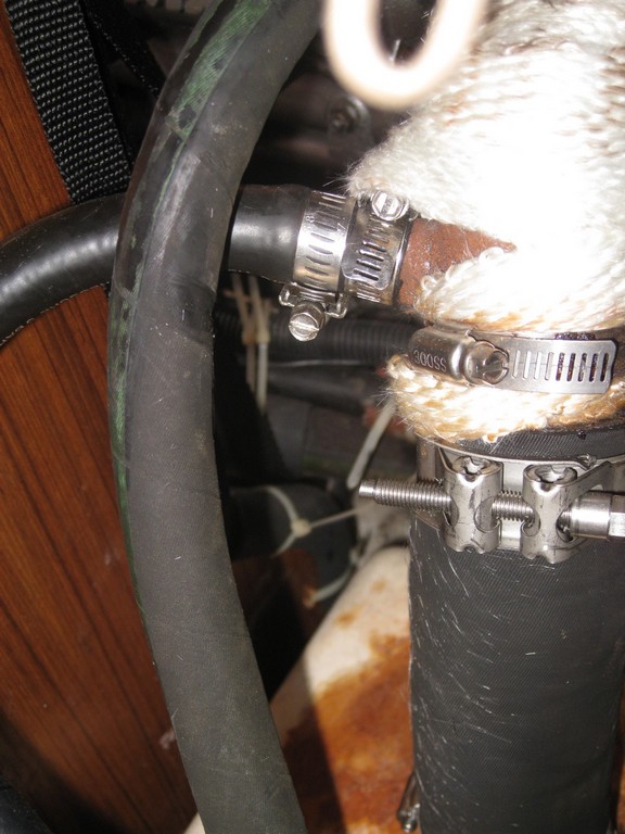

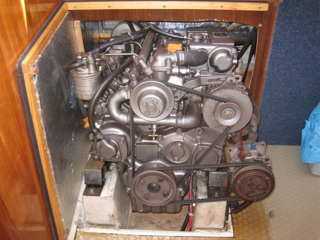

hello Stephen,
I've attached pics of our Yanmar 39hp install in our C36.... the exhaust elbow from engine heat exchanger is shown and the water inlet elbob can be seen in one of the pics just before the elbow enters the hump tube. If for any reason my technical capabilities have been thwarted (ie you cannot see the pics, please send me your email address and I will reply with jpg attachments.

hello Stephen,
new pic attachments which you should be able to open....:)

Neville,
What kind of stuffing box is in the second pic? I've never seen anything like that before.

hi Tom,
I threw that pic in as I thought it might arouse interest.
It's a Kiwi Seal; eliminates the old style stuffing box and is an easy retrofit. I fitted it about 2 years ago and haven't had any need of further inspection or maintenance; these seals work well even with a bit of mis-alignment as sometimes happens with older hulls or engine changes (we don't have any mis-alignment)
You can google the site under "Kiwi Seal".

I couldn't figure out one thing from the Kiwi Seal website... Does all the sealing water flow out through the shaft tube or is there a "drip" into the bilge similar to conventional stuffing?

no drip; dry as a bone....all the lubricating water exits the shaft tube....
