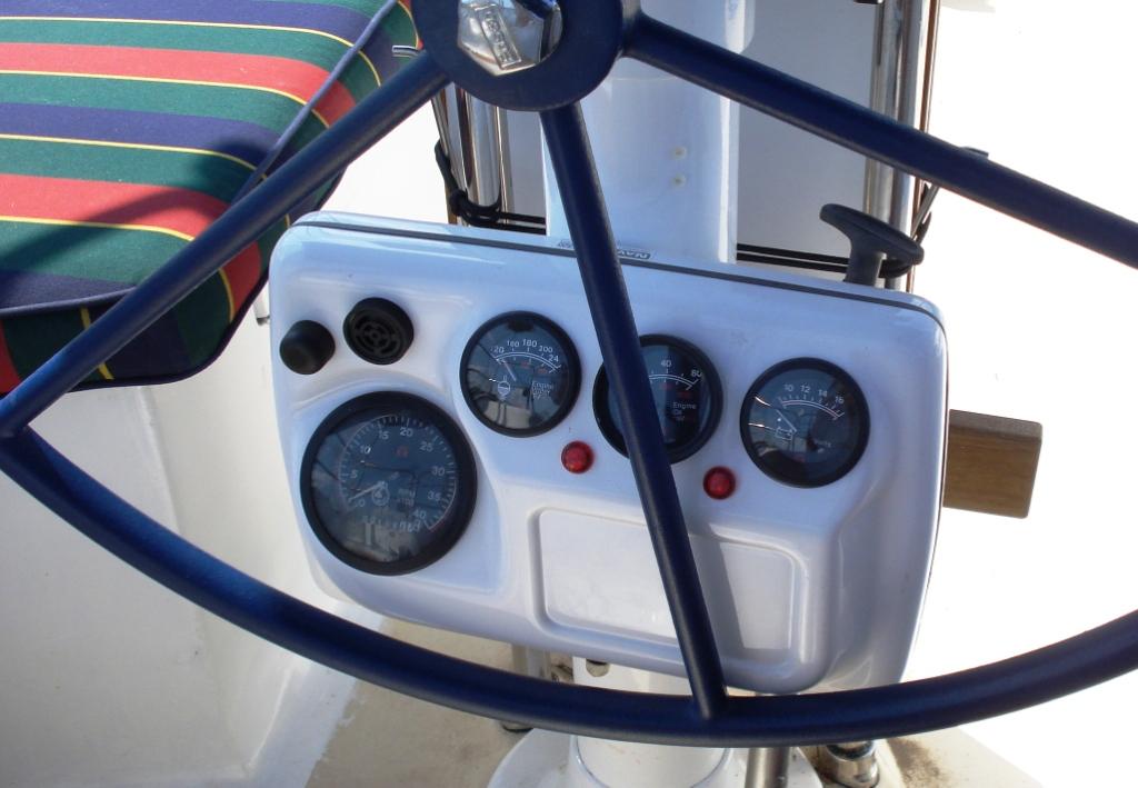

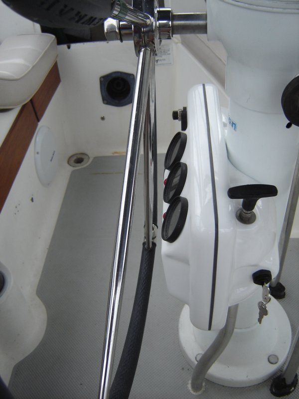

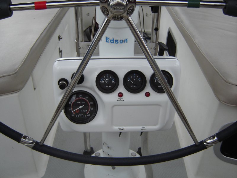

well, i finally got up to the boat this weekend and made a couple of photos of the instrument panel. the photos are attached.(i hope). any questions please let me know.

btw, the last shot was NOT a picture of the navpod, just a really nice evening on lake texoma, the weather was perfect, highs in the upper 80's and the lows in the 60's which is not usual for the month of August in north texas.

We also took advantage of the $99.00 deal and purchased one of the new style engine instrument pods. At the same time I also upgrades the engine wiring with the kit from Seaward. As you can see by Mike's pictures from CiscoCat, the stock wheel comes very close to the pod. I purchased one of the overstock special Catalina 36" diameter Lewmar folding wheels from Defender and this provided a more comfortable clearance to the pod.
