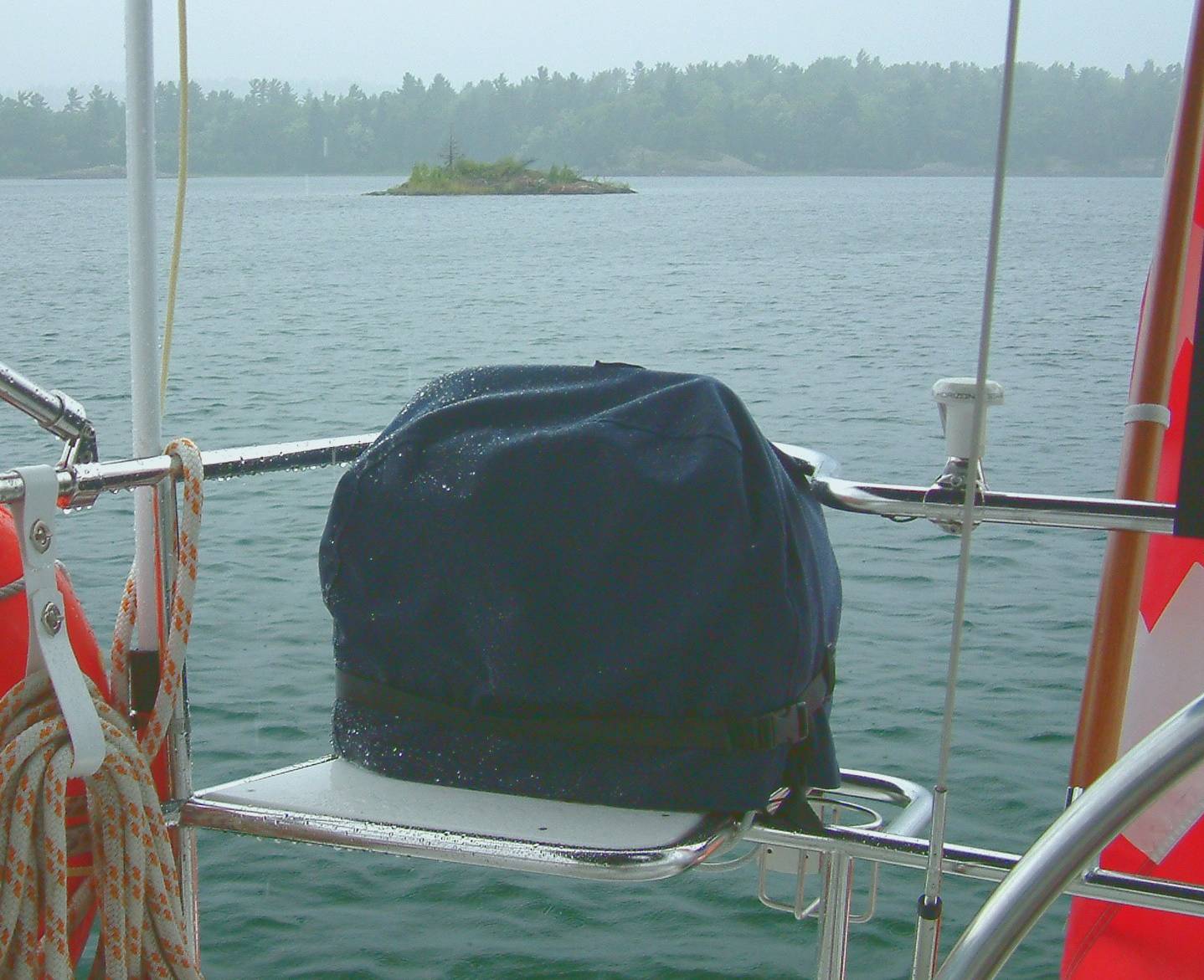

As a result I store my Yamaha EF1000iS on the starboard perch seat that is built into the stern pulpit. I have attached a picture of this. The dimensions are 17.7 inches long, 9.4 inches wide and 15.0 inches high. I can just fit across the starboard perch seat. I fasten it with two straps - one goes over the top of the generator and through a routed slot in the seat and back through the handle on the generator and the other goes around the generator including a vertical member of the stern pulpit. The generator doesn't budge underway (and is protected by a Sunbrela cover).
The smaller generator (900 watts continuous) meets our needs to charge the batteries using the Charles 30 amp charger. It will not run the water heater or an air conditioner if you have one. It runs small ac power tools easily and would likely run a small microwave. Our main use is to make up the battery drain for cabin lights, anchor light and refrigeration when we spend more than two nights at anchor. We don't like running the main engine while at anchor for a number of reasons.
When we use the generator at anchor we place it on top of a bathtub mat on the swim platform to reduce the noise (it is fairly quiet but it gets to you after a while). Other people in the anchorage don't get much noise although we avoid running it at night. One of these days I may put it in the dinghy.

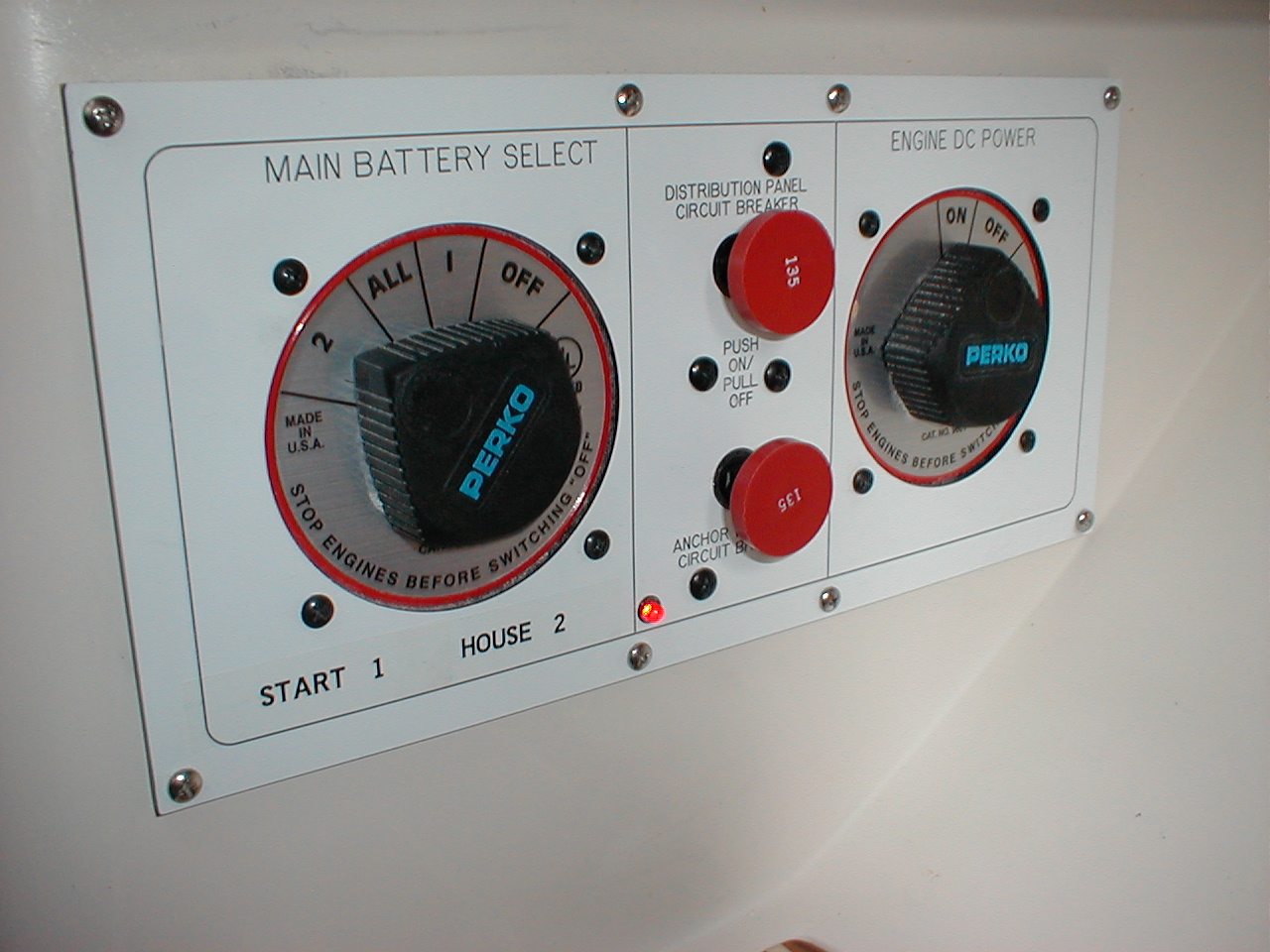

Malcolm, I see you have a Mk II. If your boat is stock, then your two 4Ds are separated into a #1 and a #2 battery. Is this how your boat is wired? Or have you connected them in parallel?
If they are still separate, then I seriously think you are missing an opportunity. It isn't rocket science (albeit, it is unforgiving of error) to install a dedicated starting battery, and to tie the two 4Ds together as your house bank.
[ATTACH]36[/ATTACH]
Larry
I have done just as you have explained. I read all the posts on this sight and it was not that hard of a project as you suggest. A piece of mind upgrade for sure.
