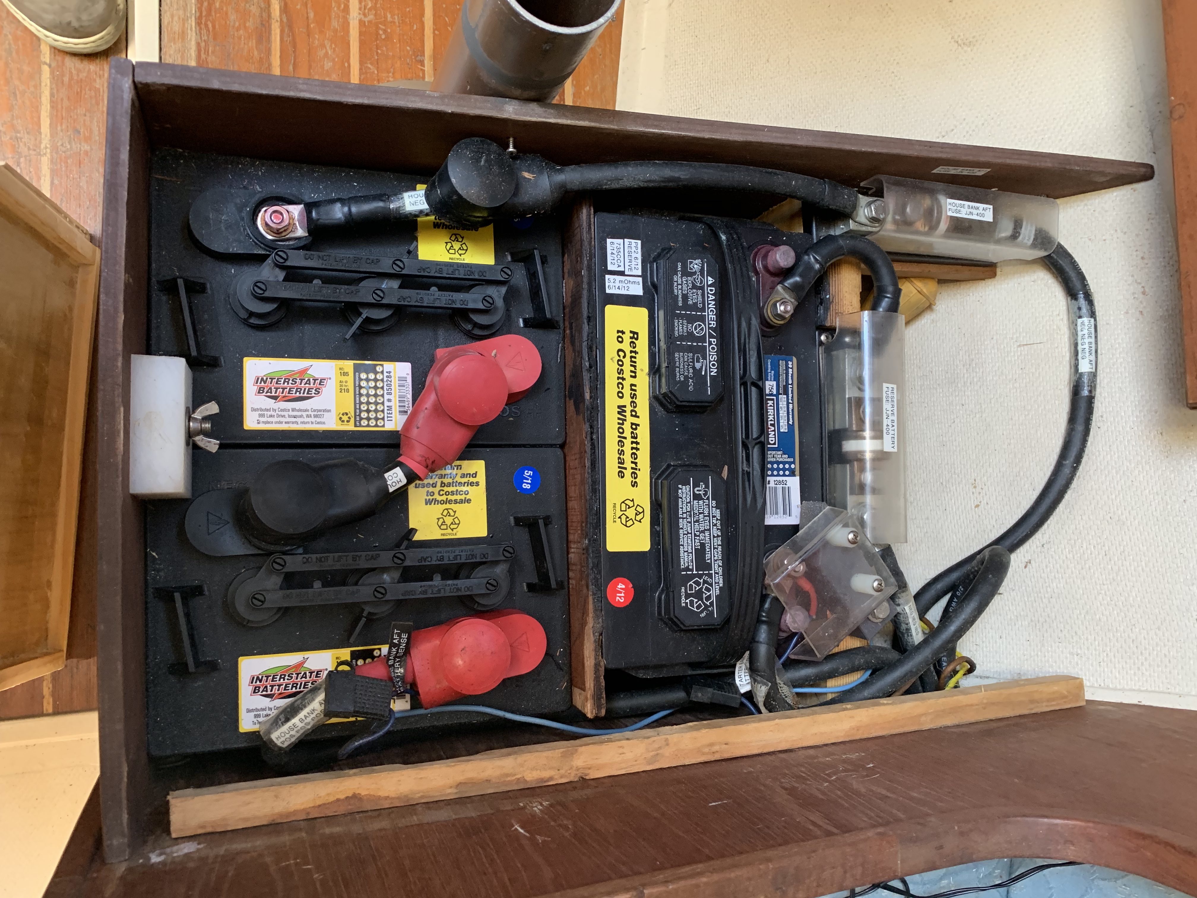

Not sure if these pictures will come through but a PO had built this box under the nav seat and installed 3 batteries there.  We changed the system so the batteries are under both game table seats.  It's a shorter run to the windlass and I am sure we will find a good use for that space under the seat.

That installation looks pretty good.. Looks like the chair is still useable.  Since it is better to have all the house batteries in one big bank, my question is does anyone use more than 3 batteries?  Or what is the max amp hours anyone has installed and how?

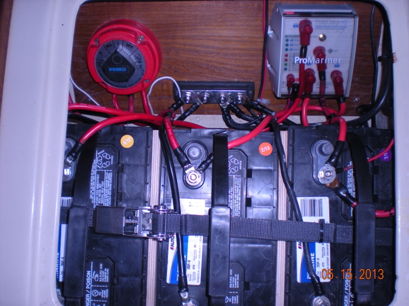

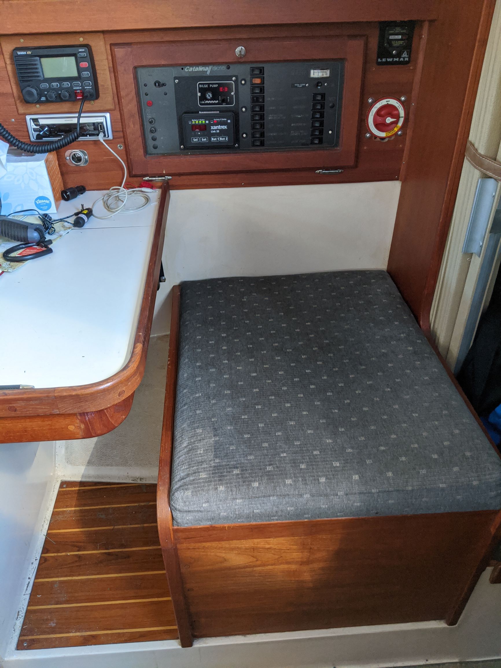

A previous owner of my boat removed the nav seat entirely and made a large box with the top as the new seat. The top is an upholstered cushion with a wood bottom. There is enough room for two 6V 220Ah batteries and a couple tool bags, so there may be a way to fit 3 batteries in it. Unfortunately, I can't seem to find a picture of it, but I could get one this weekend if you want to see it.

Here are some pictures of my battery box/nav station bench seat.

Hi Eric, I really like the battery box you've built. Currently, our batteries are under the aft game table seat. We'd like to know what path you took for the major/minor cables that run from the alternator/engine to the batteries (assuming that your alternator is direct wired to your batteries).
We recently upgraded our electrical system (new heavy marine grade cable, ACR, bus bars, fuses...etc). On recent sails, when heeled over on a port tack, we noticed a ton of bilge water sloshing into that battery compartment and getting all our new electrical wet!! Bilge water has a path to flow over the starboard hull floor and behind the nav station drawers and through the exising holes/tunnels where wires run in and out of the battery compartment. This is deeply concerning. We're thinking of changing to your configuration with a battery box where the current (useless) nav seat is. Our alternator is directly wired to our batteries. Other cables coming from the engine (e.g voltage and temp sense wires from our alternator regulator, negative/ground wire...,etc) are currently routed under the sole of the boat to that battery compartment via the area behind the nav station drawers. We also have a reserve battery under the forward game table seat.
Adel

Yes, the seat is still useable.  Unfortunately, instead of building a box to fit, they cut both the floor and the pedestal to build the box.  Now that we have removed it, we have to decide what to do about the 1/2 missing floor and chair base.
It is a good space and it's nice to be able to use it for something but it wasn't easy to check the batteries with the way the lid fit and with the chair so tight on top.  Maybe a bit shorter of a box would have been a good idea but no doubt it was built to accommodate a specific battery size.

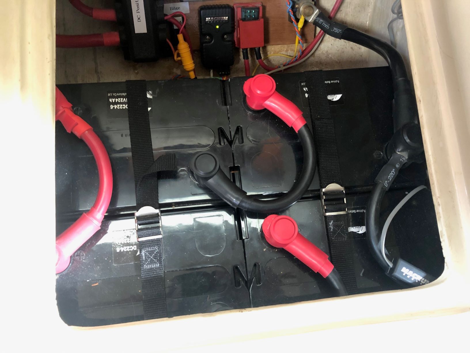

We went the four 6v battery route and were able to fit "tightly" 4 batteries under the aft game table seat along with some components for the charging/monitoring system.
These are the Full River DC224-6 and with the combination gives us about 448 Ah which is nice, BUT if you do this you need to make sure that you have an alternator that is externally regulated, preferrably has a temp sensor, and would be best if it was high output (if you dont carry a generator on board or plan to be on the hook for more than one day without motoring). I learned this hard way after having this setup recommended to me without mention of the alternator needs. We smoked our alternator on one of our trips. Looking to upgrade to a high output alternator system soon.

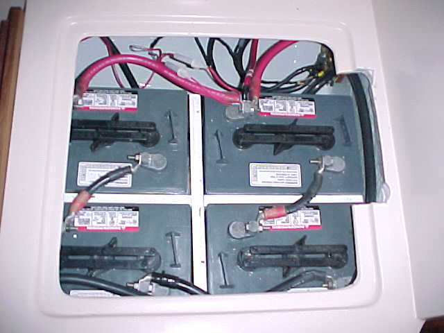

I have a 1984 Catalina 36 hull #260.  I modified my battery box ( stbd. game table seat ) to hold three (3) size 31 / 12 volt batteries ( these batteries are the perfect size and can be handle by a single person / appr. 70 lbs. each ).  All Three are deep cycle and can do any thing that may be required.  I then installed a digital splitter to proportion the charging coming directly from the altenator.  It charges the battery that needs it the most and the others as required.  I also installed a second battery selector switch so I could parallel two batteries for house use or keep separate.  We all know the shortfall of paralleling two batteries for any lenght of time.  If I were going to add additional battery capacity, I would do the box under the nav, station seat.  I personally would add Two (2) additional 12 volt batteries, a forth house battery and an isolated starting battery.

I attempted to attach this photo with my thread.

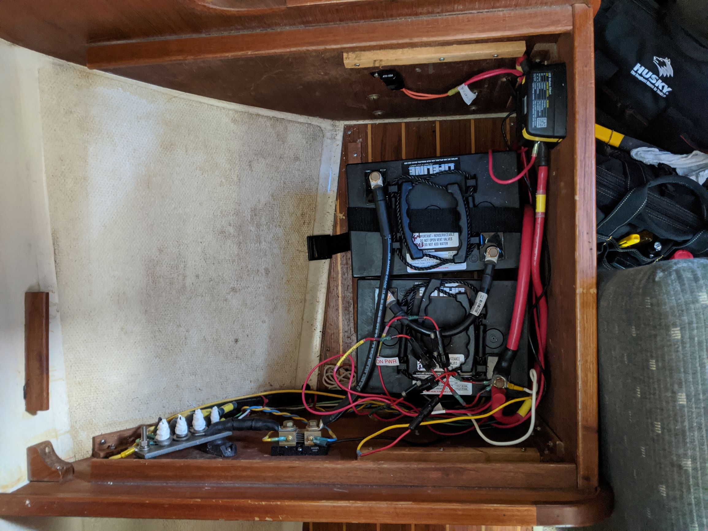

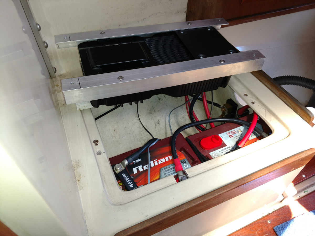

I was able to fit 2 GC2 size batteries (Trojan 6v 217ah) under the forward dinette seat, plus a 1000w inverter/charger. It's a very tight fit, but working great. Here's a picture with the batteries in place, and the inverter before I mounted it under the molded lip.

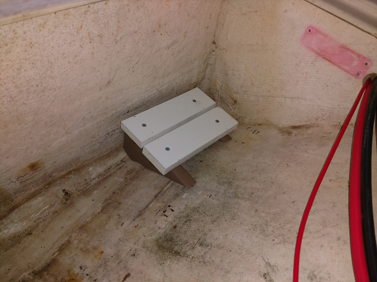

I built a couple of supports which conformed to the odd shape of the bottom. The batteries sit on these supports. Here is a picture of the forward one.
