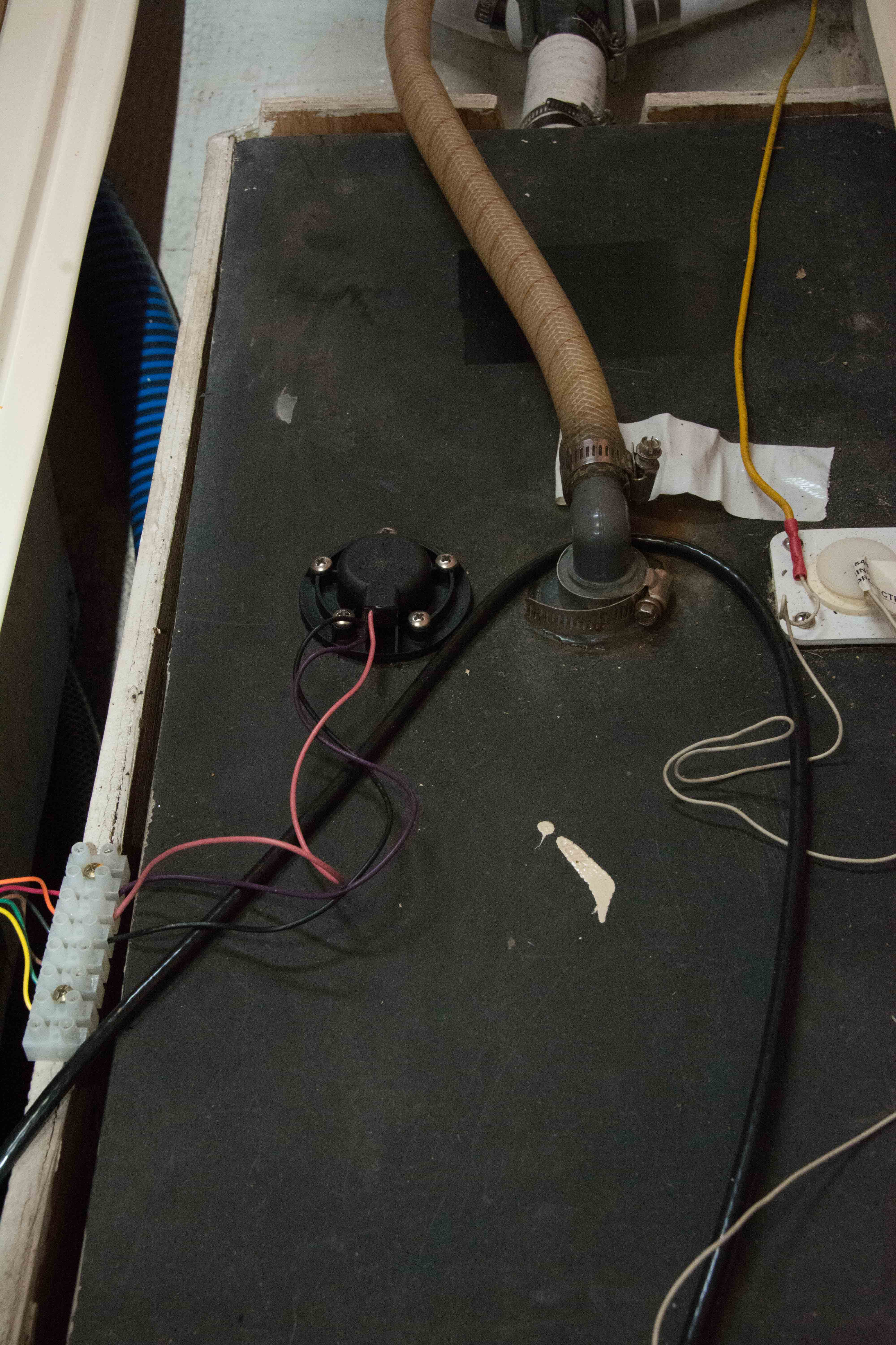

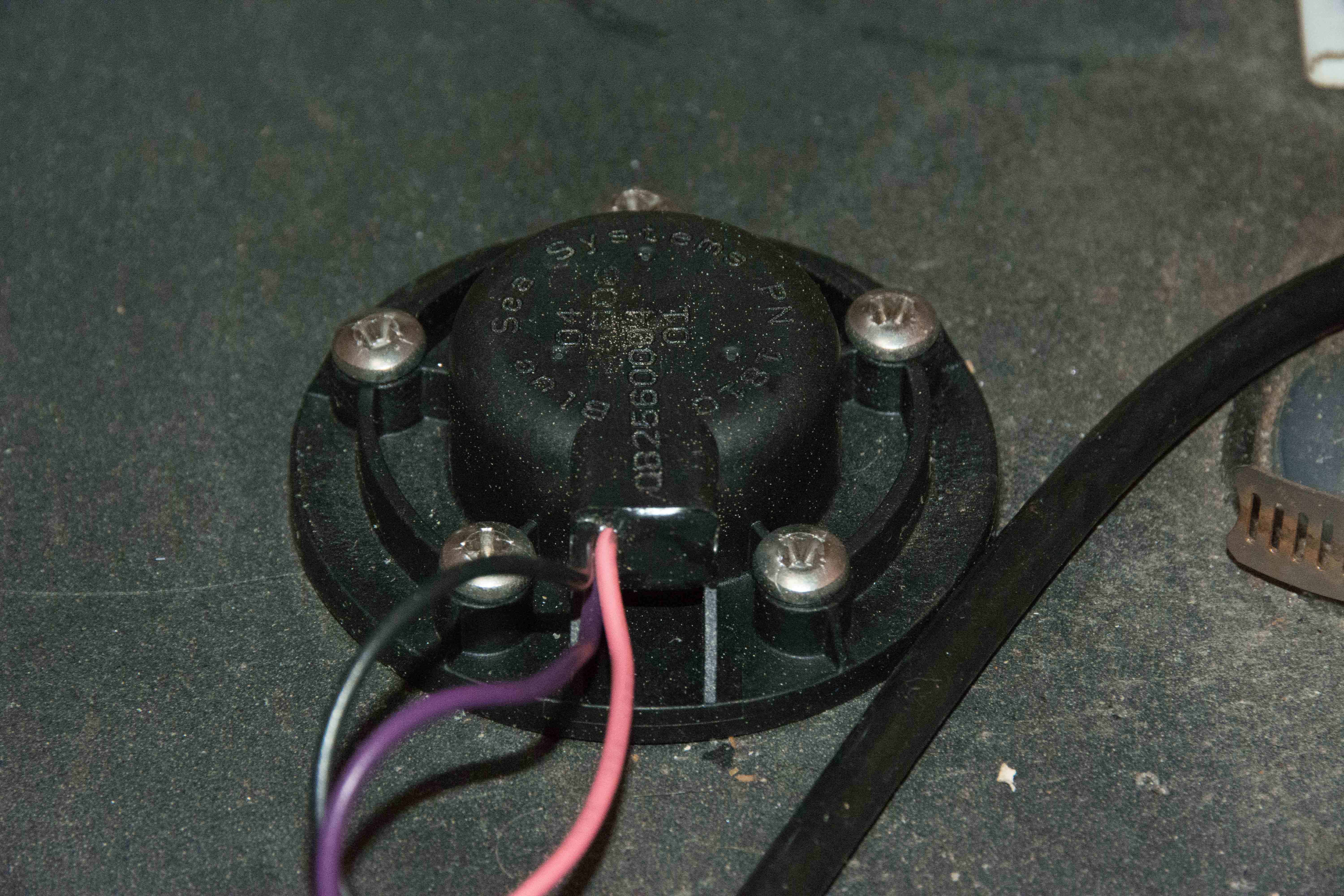

The PO installed a  Blue Seas VSM 422  and I assume the untrasonic tank gauge.  I'll be up there later this week and take pic's on the installation.

Chuck - it all depends on what you want the VSM for - if primarily for tank/bilge monitoring - I would probably look at something that put the info out on NMEA 2000 (or SeaTalkng),  I haven't taken enough multi-day trips to comment on the battery monitor side of things (only had the boat since ~ April 2016) - but it would have all the problems associated with any coulomb counter (Battery aging, initial setup....).   The PO was a Blue Sea Engineer, so tested out goodies on the boat.  I assume the holding tank is ultrasonic (judging by # wires to it it is) but haven't really dug into it.  I've only pumped the tank once (I need to pump again soon) - but seems to be good at levels for water and fuel.
Right now it is monitoring Battery #3 - but think I may change this soon to monitor bilge.

Here are the pic's.  hope it helps - the tank top is very stable.
Les

Thanks Les. Very clean looking.
