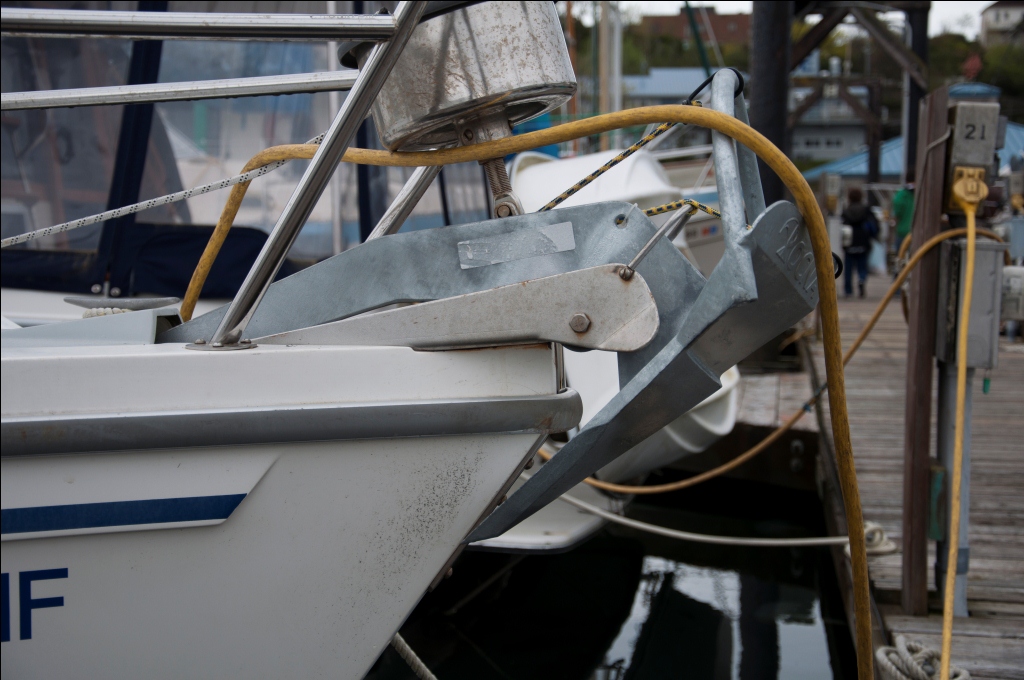

Way back in this thread I promised to post a photo of the Rocna 33 on our bow roller.
Well I finally managed to get up to Blown Away last week-end.
Here it is.
You'll note that the various angles of the Rocna 33 shank work just perfectly with the bow roller so it sits nice and snug, while not knocking on the bow gelcoat.
I've yet to use it in some of the San Juan anchorages so can't vouch for how much better it deals with the eel grass(?) that thwarted our Danforth's multiple attempts to get a nice solid set.
And just because I spent some $300 on the Rocna means it's at least 15% ahead of the Danforth - right ? ;)

Glenn, in my experience, neither a Danforth nor a Bruce is a suitable anchor for the San Juans. I have drug many times on a Bruce in the San Juans, on several different boats, and would not have one in those waters. Ditto for a danforth (although my secondary anchor, stowed in the cockpit locker is one), although I have not used one up there.
I have used a danforth many times in the sandy bottomed Columbia River, and so I think I understand its pecularities. A danforth seems fine for sandy bottoms, and probably the Bruce would be OK in those conditions also...but not in the rocks, eel grass and kelp of the San Juans and points north.
My worst experience with a Bruce was riding to what I thought was a good hook (in Inati Bay, on Lummi Island), and raising the anchor the next AM to find a large boulder exactly the size of the anchor filling the arms of the Bruce. We struggled to get that boulder out of there before we were able to launch into windy Bellingham Bay. It was a tough job for two people to wrestle that boulder out and tumble it back into the bay for the next Bruce user to find.
High Flight has a CQR knock-off that has been very effective, and I am interested in the Rocna. Frankly, I am too lightweight on anchor for the Inside Passage, so before I go north (in a few years) I must upgrade to heavier tackle.
