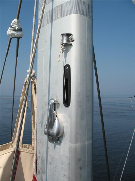

John,
Yes, you could use a pair of loops in a second halyard, but a pair of steps mounted about 4' below the masthead work VERY well. Racers cringe when I talk about adding any weight that far up, but I did it on my 36, and again on my 400. Combined with a harness, you can work easily at and above the masthead with both hands free. Very safe and secure. The picture below shows one on the stbd side. The twin is on the port side. They fold up neatly when not in use, and have never snagged anything, being somewhat protected by the shrouds. Highly recommend them.

Tom, Is that reflective tape around the top of the boom?

Ken,
Yes, it's reflective tape (SOLAS?) around the top of the mast. Even with a small penlight, you can see it from a few hundred yards away. With a bright light, probably a 1/4 mile. I first saw this idea at Block Island, where they were called "Drunk Stripes".
