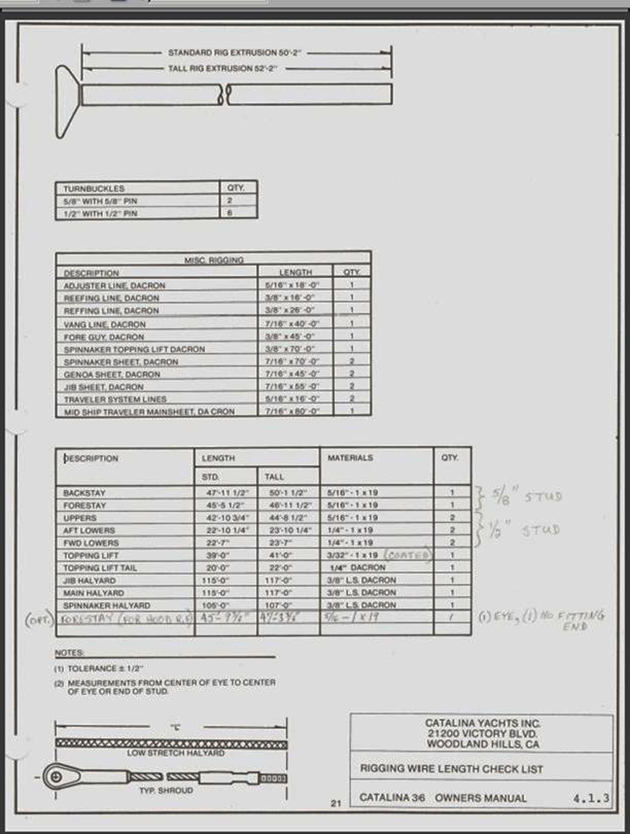

Does anyone happen to know the length of the mainsheet on a Mk I? I need to pick up a new one and forgot to take a measurement when I was at the boat last weekend.
I think the configuration is pretty standard as far as how the sheet is run like a giant "W" through blocks on the boom bails, traveler, pad eye and back to the winch.

I found my copy of the Tech Notes CD, and the relevant page shows 7/16 dacron, 80 ft length. At least that's how I read the table. Please check the attached before you buy.
