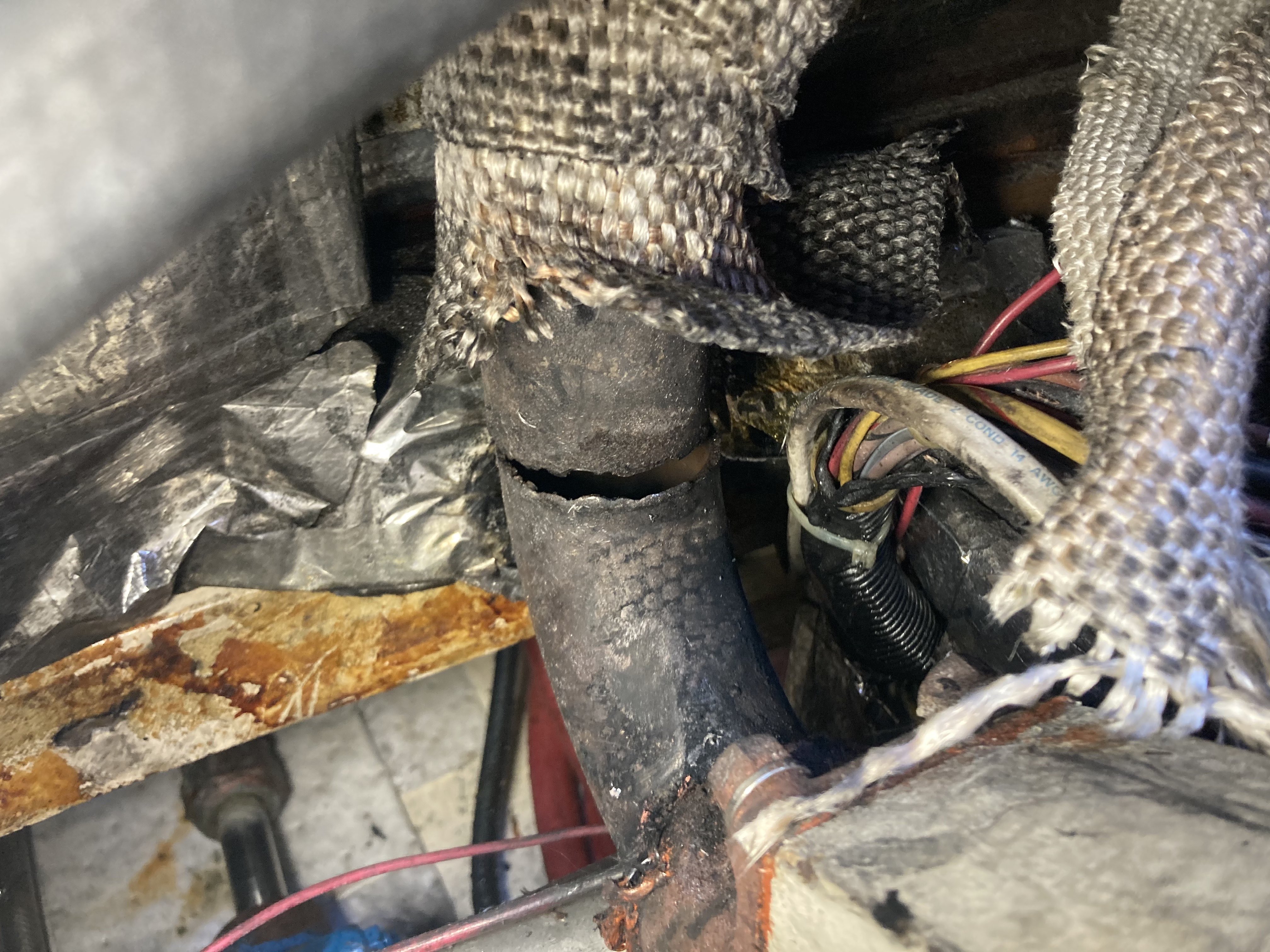

Thanks so much Lou, I got to the bottom of it this morning and unfortunatly the exhust pipe has been sheared clean through see attached photo.
Love to get peoples thoughts on how big of a job this will be to replace or repair?

Cam,
Of itself it's not complicated, however, I would have it professionally done.  I had my engine replaced some years ago and watched the work.  Replacing the hose and properly wrapping the insulation and wire securing it, took some skill.  It is also a good time to inspect the entire exhaust system.

Its a pretty easy job and there is alot of info on this site about doing it
Bill Miller
S/V Lorraine
Pacific Northwest,Sound Sound
Grapeview,Wa
1990 Mk1
Bummer that this happened so early in your ownership, but the riser is a "wear item" that one needs to inspect every so often and eventually replace. Hey - at least you are in your home port (we had ours go while 400 miles away from home during a vacation cruise, but luckily found a local marina with a workshop to help us build a new one).
You have two main options:
- Catalina Direct sells a nice stainless steel heat riser for around 5 "boat bucks" -- https://www.catalinadirect.com/shop-by-boat/catalina-36/engine/exhaust-system/exhaust-riser-c-36-wm-25-engine/(link is external)
-  You can fabricate something yourself out of pipe nipples and plumbing fittings for around 1 "boat buck" (many use 1 1/4" black pipe and fittings; on my second rebuild I used 1 1/4" schedule 80 seamless stainless pipe and fittings, although I can't say whether it will last longer -- but 6 years later so far so good)
Here are some links to some of the threads discussing the rebuild/replacement, or just do a search on "exhaust riser" and you'd find plenty of prior write-ups:
https://www.catalina36.org/forum/technical-discussion/exhaust-riser-rebuild
https://www.catalina36.org/forum/technical-discussion/new-exhaust-riser-1-14-black-iron-pipe
Some of those threads give materials dimensions, but given the variations in engines and locations of the waterlift muffler, I think there is probably no one-size-fits-all dimension, so you most likely need to do some of your own measurements to suit.
Good luck.

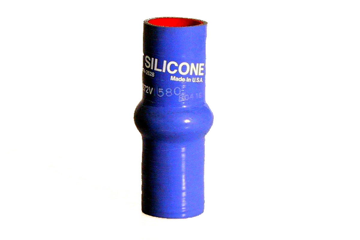

The engine movement of course puts some stress on the exhaust riser.  As you'll read in the various threads linked in my prior email, one way to ameliorate this is to install a "hump hose" connector between the riser and the water-lift muffler, so that there is more ability to flex (if you don't already have one).
