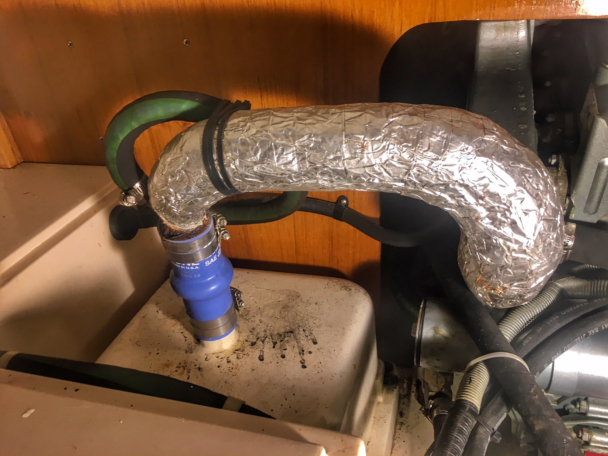

My C36 #2164 2003 year w/1200 hrs has the original exhaust riser. I understand that as my boat is 15 years old, this riser should be replaced. I expect to order the parts from Catalina Direct.
I spent an hour reading the numerous posts in our website Tech Forum, and did not find the answers to these questions:
1): When I disconnect the old riser from the aqualift muffler, would I expect sea water to come out of the muffler?
2) Is this a job that can be done in a day?
3) Besides the actual riser and insulation, I suppose I should replace the blue exhaust hump hose?
4) How does the stainless steel riser connect to the manifold?
Any additional advice is appreciated.
Thanks in advance.
Steven Jones
Seal Beach, CA, USA
stevenjones21@gmail.com
Image icon Exhause riser Dec 2017 original.jpg1.05 MB
Steve -
To your questions:
1): When I disconnect the old riser from the aqualift muffler, would I expect sea water to come out of the muffler? No.  You will, however, end up releasing antifreeze when you disconnect the exhaust flange from the manifold.  (Hint: make sure you purchase a replacement gasket for the flange to manifold connection).
2) Is this a job that can be done in a day? Yes -- if everything lines up OK and  you don't discover other problems (you know how  that goes).   In order to gain access you will need to remove the bulkhead between the galley and the aft cabin, and the box in the aft cabin that encloses the riser.  Also, as indicated above, you will need to drain and refill the antifreeze loop.
3) Besides the actual riser and insulation, I suppose I should replace the blue exhaust hump hose?  If you don't have one already (i.e., you have just a straight hose), absolutely.  Otherwise, if it appears to be in good shape, don't know if these wear out very much,.but since you're already there...
4) How does the stainless steel riser connect to the manifold?   It threads into the exhaust flange, which is bolted onto the aft end of the exhause header with 3 bolts.   It can be a total PITA to unscrew the old one from the flange, but careful use of a Sawzall can make this much easier -- see this comment I posted a few years ago and the pictures there: www.catalina36.org/comment/58399#comment-58399
One last thought:  You might save some money (and possible make the install easier) by building the riser yourself out of black pipe and/or stainless pipe and fittings (I got the stainless pipe and fittings at Grainger). Here's a link to a post showing the completed project from a few years ago (www.catalina36.org/comment/58716#comment-58716  You can get the injection fitting for about $64 online ( I replaced the old fitting shown in my pictures this summer with this one pictured below), or have one welded.  By using pipe and fittings, you have the ability to adjust the alignment somewhat, which can be useful....
