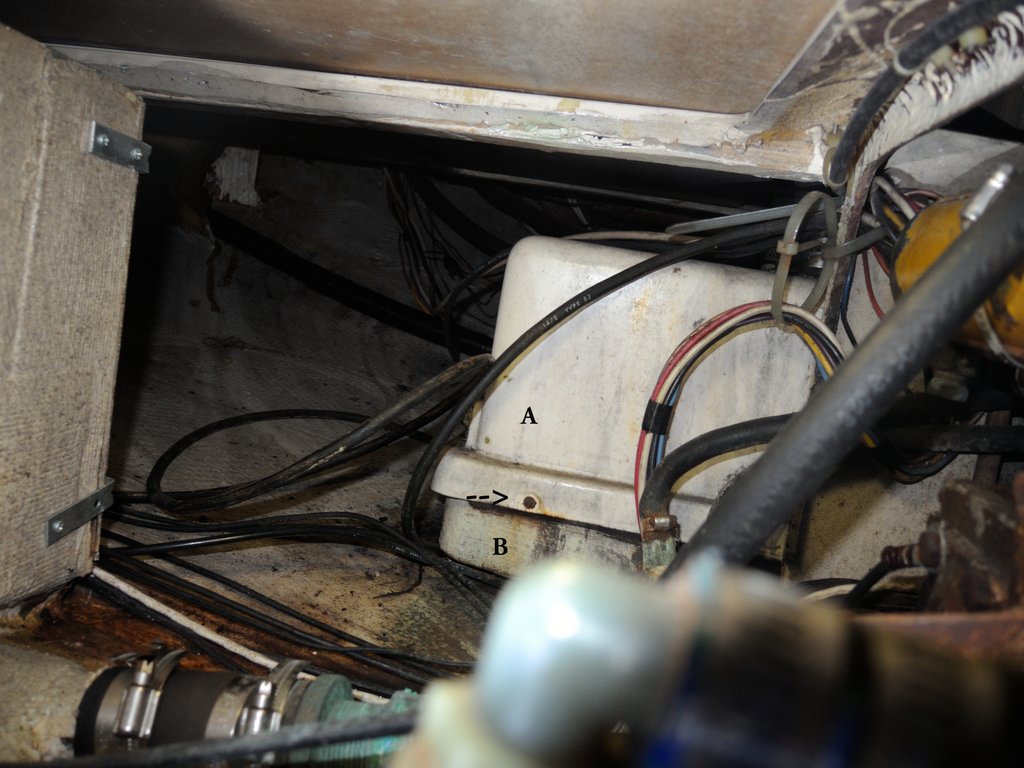

2.  As I was looking for leaks on the back side of the engine, I noticed that the aqua muffler was vibrating.  See photo.  The top half 'A' was some what stationary, but the bottom part 'B' was vibrating very fast.  I'm assuming that it should not be doing that.  Is it just the rusted screw that has failed or do you thing the muffler is starting to fail?

How is the muffler attached to the boat hull? On older Catalina's the "lower half" is typically a wooden or fiberglass bed that the muffler screws into. The bed is bonded (fiberglassed or glued) to the hull. (On the MKII, the hull liner has the bed molded into it.) From what you describe, it seems that your muffler bed is seperated from both the hull the muffler.

I've had to reglass the muffler in our '85 onto the hull a couple of times, but not since I switched to a hump-hose connection from the exhaust header (cut down the vibrations).

I'm sure the muffler is not attached to the hull based on the way it was vibrating and that screw looks like it has rusted thru. So I will look at the muffler as a separate issue.  I will check the pressure.  Thanks for the suggestions.
