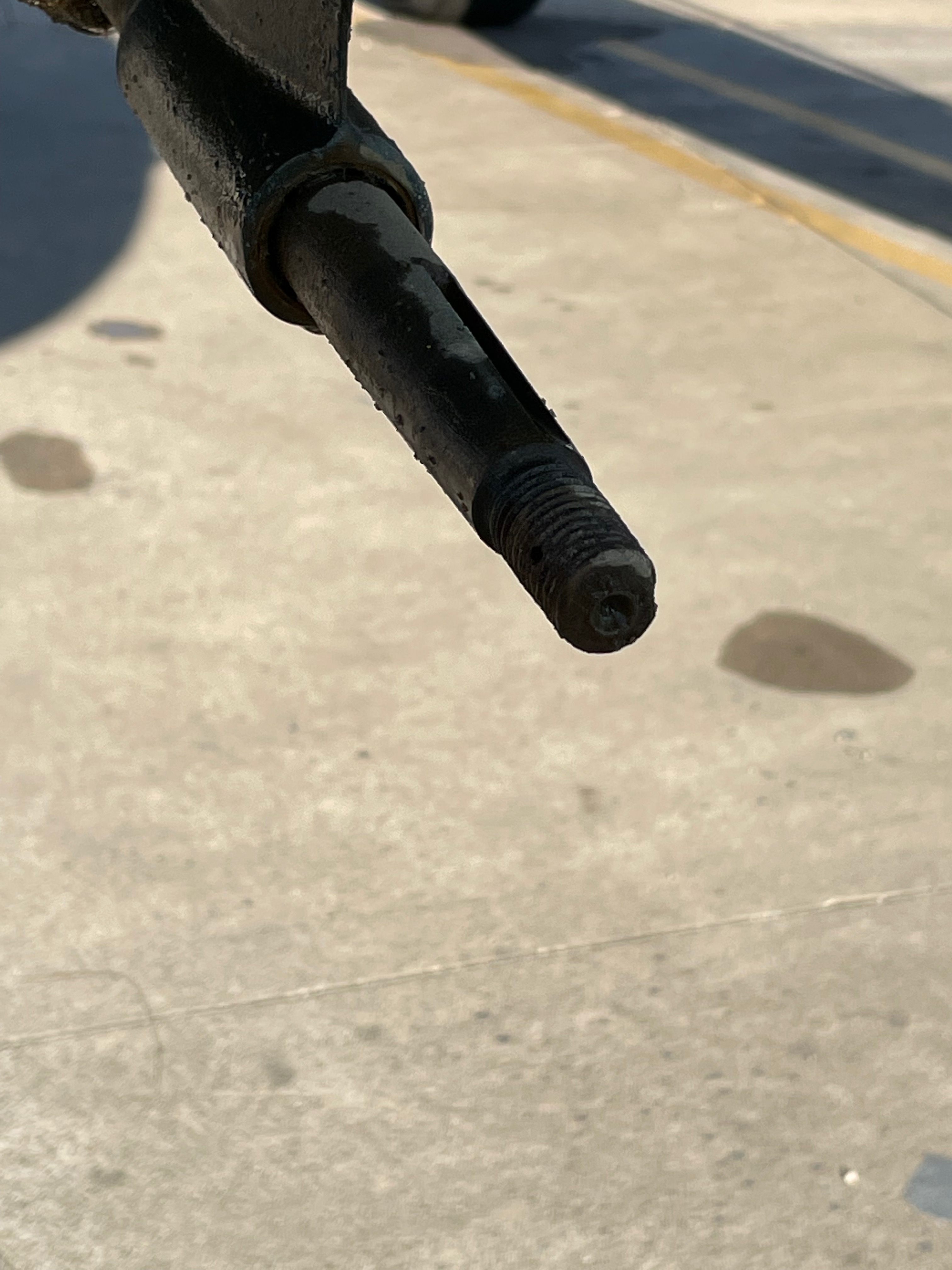

We made the trip without too much trouble. About a mile south of the inlet to our harbor I started the engine and planned to motor sail and clean the boat up a bit. When I put the engine in gear our speed didn't change and the engine didn't drop RPMs or sound like there was any load on it. I tried multiple times and even went into reverse and it had the same effect.  I went below and could see the shaft turning whenever I put it into gear but we had not thrust.  By now the weather was pretty rough and too rough to heave to or anchor or go for a swim to look at the prop.

The next week I pulled my boat out of the water.  Attached is a picture of the problem (no prop!)
Here is the story:
- Four years ago I upgraded from a 3 blade fixed prop that was on the boat when I bought to a feathering Kiwi prop. The Kiwi prop is held on by a nut which itself is held from turning by set screws. The set screws are held in place with Loctite. I carefully followed the installation instructions including using the Loctite and then forgot about things for the past 4 years.
- This past spring at launch I inspected the prop, greased the fittings and made sure the blades looked fine. All looked to be in order. I cannot say that I checked the nut tension or the set screws. To be honest, it never occured to me that I should do that. It had been 4 years since I installed the prop and honestly I forgotten all about the set screws and the install process.  In restrospect, this was a mistake. There now is somewhere on the bottom of Lake Michigan a very nice Kiwi prop.
So lesson learned - prelaunch inspection includes making sure that the prop is attached and the nut has not loosened.

Interesting story. Thanks for sharing. Your folding prop couldn't make use of a castle nut and cotter pin?

I agree. It seems like it is always important to not sail on a schedule and instead have the time to have better conditions. We debated that. Overall the boat was handling it well and so we continued to push on. The Kiwi prop design is such that it doesn't have a standard kotter pin. The nut is held on by set screws. They state on the installation instructions that it is critical to use Loctite or you risk losing your prop. I used Loctite but neglected to check it again through the past few years.
