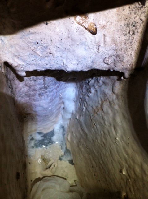

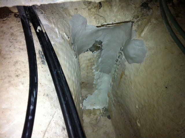

I finally got this leak stopped.
I spoke with Warren at Catalina Engineering, who thought it would be possible to stop the leak from the inside.
Then the trick was to find ALL the sources of the leak. I now believe there were several pin-hole leaks in the rudder shaft tube. I had to cut away about 1 inch square piece of fiberglass from the mini-bilge next to the rudder tube to get at the last leak. This did NOT look structural. See attached pics.
The best product I found for doing this is West Marine's Epoxy Putty Stick. Hardens in about 10 minutes.
The trick is to put it on and then keep re-pressing it until it starts hardening. Otherwise, it doesn't stick well. (This is in their instructions.)
Now that the mini-bilge is dry, I will fiberglass over the whole area for strength.

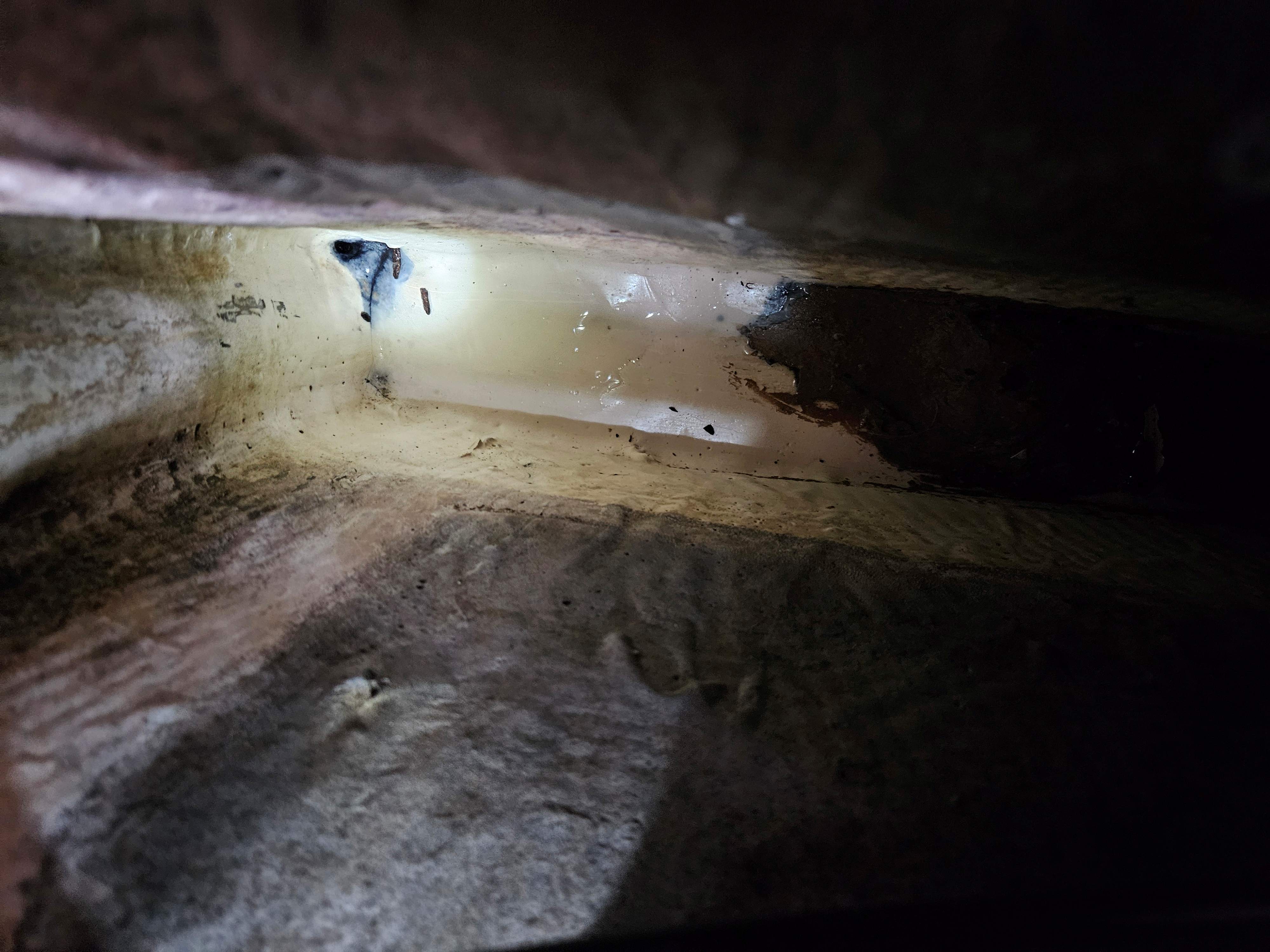

Hello!  I'm reserrecting this thread from 2013
I have a 1987 Catalina 36 with the same slow trickle in the same area.   I was told not to patch it, but to fill the rudder post from the inside.  Is this a temp fix?  Some else said there may be a crack on the outside and to drop the rudder to "look" maybe fiberglass delamination.  I did have the rudder stuffing box repacked but it did nothing. Thanks very much.
