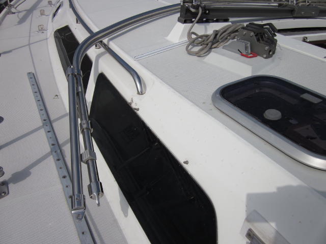

I just took my wnter cover off this weekend and immediately had my deck washed by a thunderstorm. This gave me a chance to check for leaks which led to the discovery that both hand rails were leaking into the cabin from the most aft attachment. Looks to me to remove a hand rail there are only 6 readily accessible screwheads so no big deal. My question is what to do to rebed the hand rail. I am thinking of drilling out the bolt holes, filling them with expoxy and redrilling them, making a chamfer then using butyl tape as a seal. Have others drilled out and refilled the original holes or does one just need to clean the area, apply new bedding compound and use the original holes unmodified?

Thanks Gary: I actually meant the hand rail along the coach roof. See attached photo. Looks like removal, rebedding and reinstallation will be very straight forward - and I totally agree with butyl tape for this. What I am not sure about is whether I should drill out the coach roof holes and refill them with epoxy. I will do this if it looks to me like there is exposed core but won't really know until I get the hand rail off - unless someone has already done this and knows from experience.

I had a leak on the teak handrails on my '88 C30. The biggest problem I had was re-aligning the holes once it was removed, as it tried to straighten out again. Was a 2 person job. Our C36's have stainless rails, and I don't know if that'll be a problem or not. I know that when I do re-bed, I'll use the same process Mainsail recommends. It really doesn't take long at all. Longest part of the job was waiting for the epoxy to set up; gave me a chance to take a nap :)
