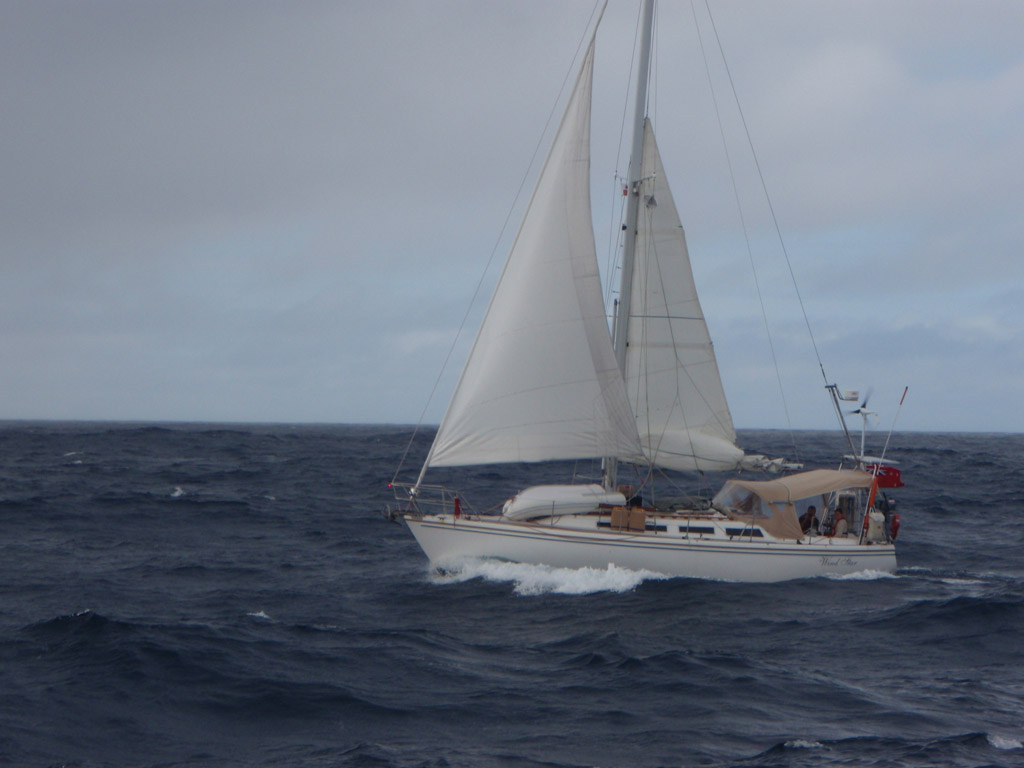

I was advised to fit the top end of the lazyjacks underneath the spreaders about 8" to 10" OUT from the mast. This makes them angle out a little and less likely to snag the battens when you hoist the main. We generally leave them in place when sailing, as we spend a huge amount of time with 2 or 3 reefs in the main. (Photo shows lazyjacks with 3rd reef in main. We're making 6 knots or so in Tonga. Any more breeze we would roll the genoa and hoist the staysail on the inner stay... Bunt is ballooning, we're getting a stackpack to help this.)
I find I can generally hoist the main when a bit off the wind under genoa alone, the boom swings out with the main luffing free. I time my hoists to when the battens are between the lazyjacks.
Others loosen one side lazyjack and pull it out of the way whilst hoisting... might be worth the effort?
