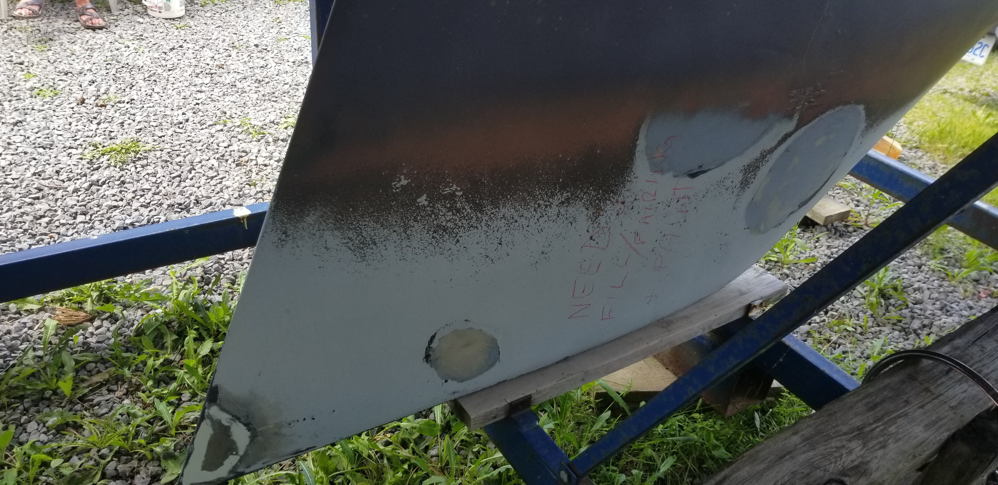

We grounded our '91 a few years back in two feet of sand overnight (let me see if i have relevant pics) and discovered some interesting fiberglass resin fill jobs on the starboard side of the lead keel.  Not sure if it was a bad mould fill with the lead, but below the fiberglass portion which extends down about 8 inches from the hull, the keel is 100% lead (look at the pic attached, the bit at the bottom is the end of the fiberglass where the keel gets bolted to). You did not include a photo, so it's not clear where your bulge is?

For clarification it is the lead itself that is has been bulge out about the size of one palm. Not the fiberglass. And it did show some leakage in the spring thus water got into a void in the center of the Keel assuming along the bolt
Posts: 258
Hm. Again, you'd have to suck the bilge dry and test to see if there's a ingress of water at the bolt.  If so, remove the nut and washer, use an underwater caulk around the bolt and replace the washer and nut and crank it back down to appropriate foot pounds of pressure.  Problem solved.  However, I've never heard of a blister in lead.  Maybe in the fiberglass that was faired over the lead keel at the top edge.  Still, always possible that water has made its way up through there and up the bolt.  Not an issue for the safety of the boat, however.
